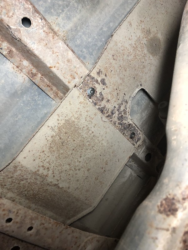

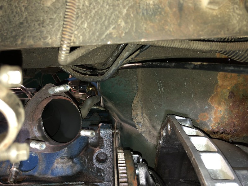

Not much accomplished tonight, I did get the crank cleaned, the NSS wiring isolated, a plan formed to delete it and re riveted the heat shield under the bed.

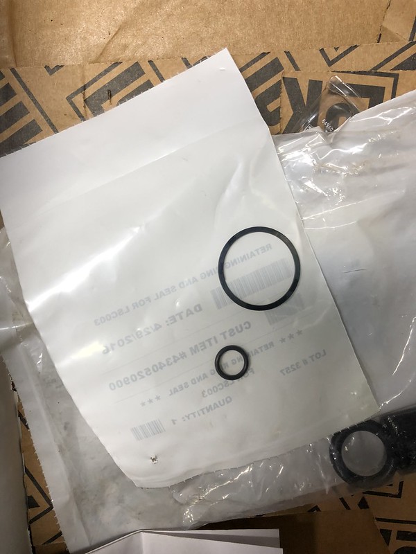

Found this in my clutch kit, yet another slave cyl o-ring, don't know what the bigger steel ring is for.

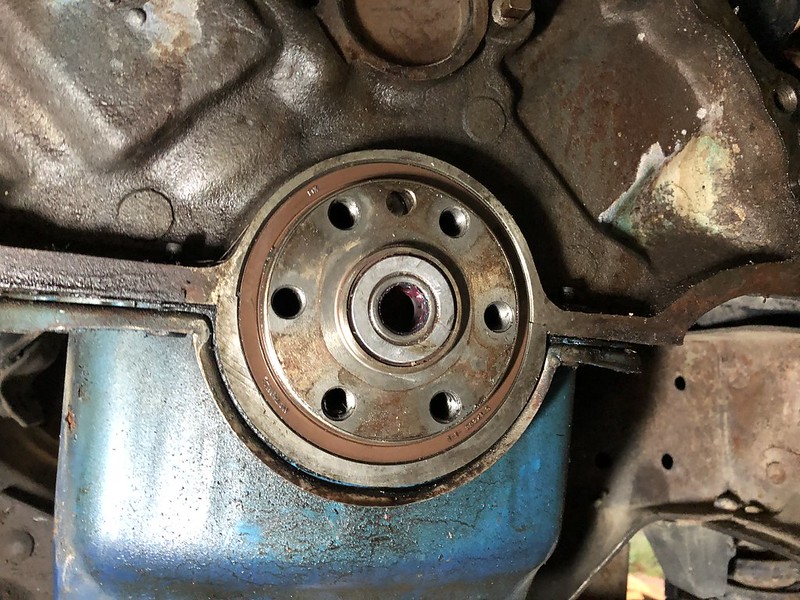

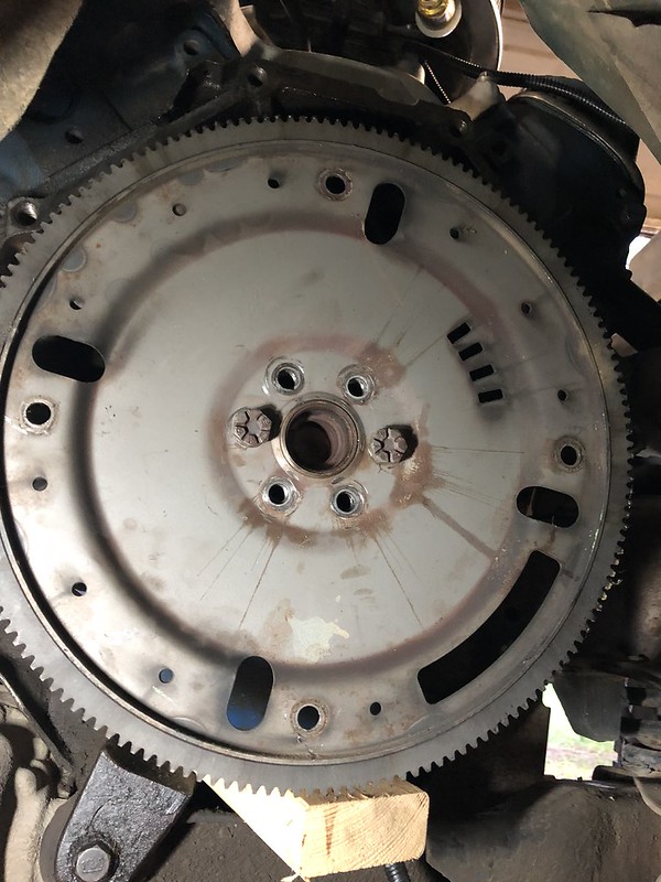

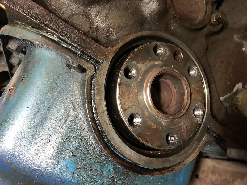

Used a block of wood to drive on the sealing ring, stuck the flexplate back on it and gave it a few love taps with a deadblow to get it on the last 1/8". FYI that thing is really friggen sharp, I cut my finger about as bad as I ever have on that internal lip.
'85 Ranger Restomod
'85 Ranger Restomod

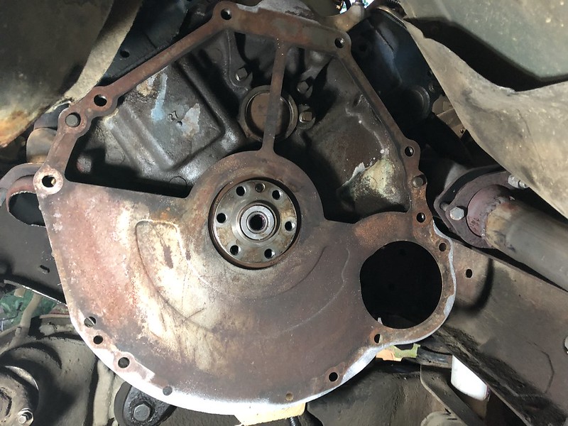

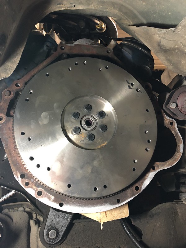

Pilot bearing and rear seal:
'85 Ranger Restomod
And separator plate:
'85 Ranger Restomod
And flywheel:
'85 Ranger Restomod

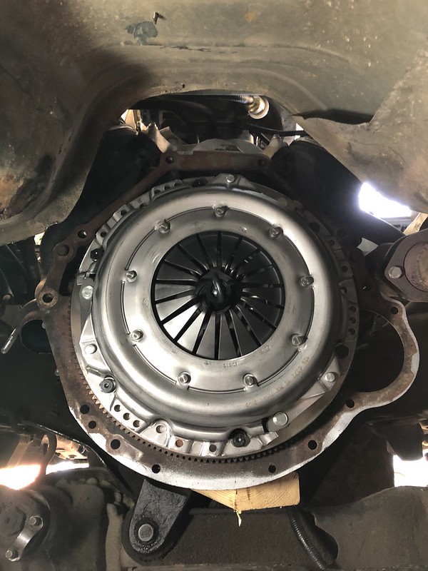

So tomorrow night is the PPA/disk and hopefully trans...
Fought off heat, disease and injury but trans is in. :yahoo:

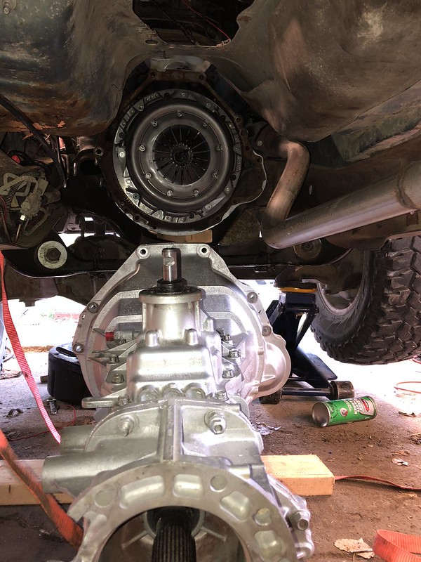

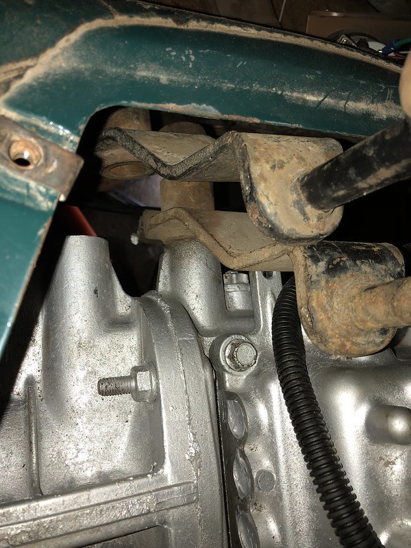

It is high enough to get the trans jack under it, now it is time to move in for the kill...
'85 Ranger Restomod
but wait, the firewall seam is in the way
'85 Ranger Restomod
Get some vice grips and give it an attitude adjustment
'85 Ranger Restomod
10:30, it was hot, my nose was running from a cold that came on about halfway thru the process and I had about headbutted everything sharp I could find under the truck I could so I stuck the crossmember and a 2x4 scrap under it and called it a night. Crossmember is going to be very close to lining up with the holes in the frame from when the A4LD was in the truck.

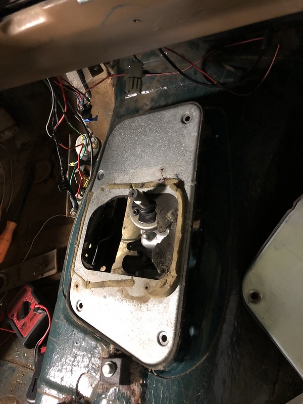

Stock '88 floorplate:
'85 Ranger Restomod

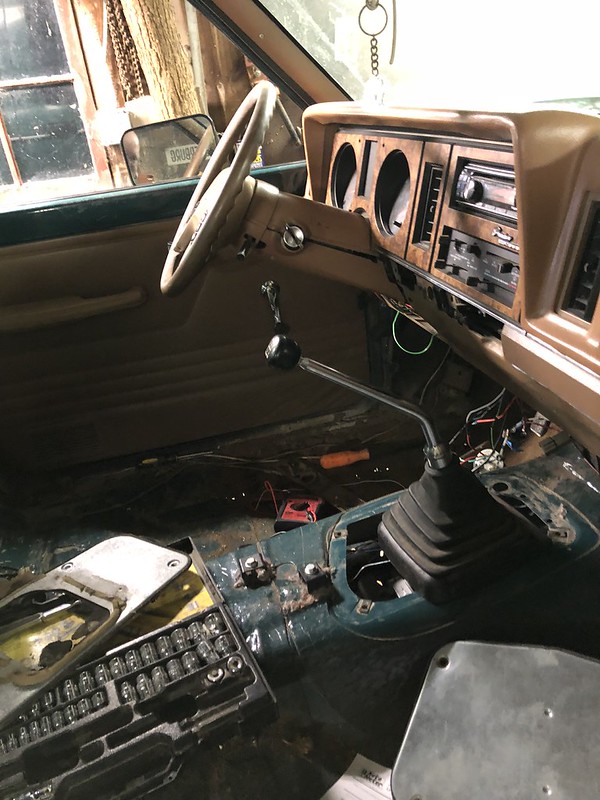

Gotta test fit the new shifter, kinda neat in neutral it has the same angle as the steering column (just noticed that):
'85 Ranger Restomod

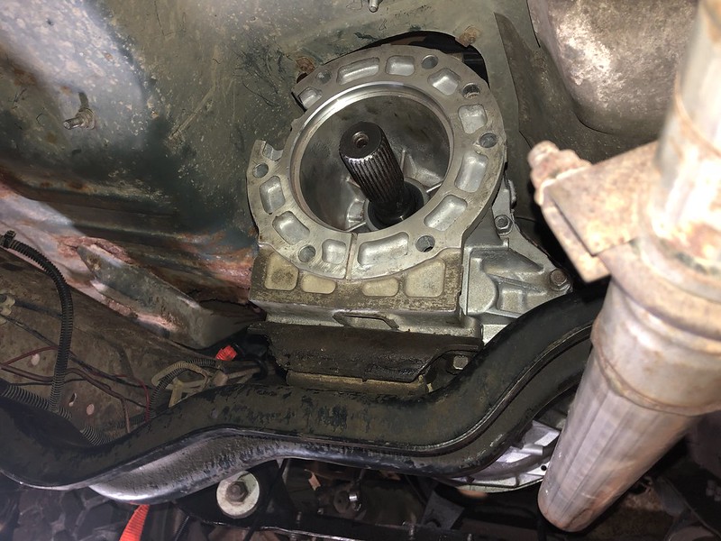

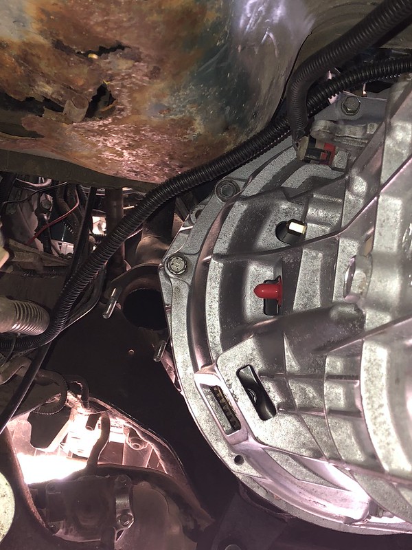

Trans is sitting on its mount mount bolted into the old A4LD holes all nice and pretty.
'85 Ranger Restomod
Much slimmer than an automatic.
'85 Ranger Restomod
'85 Ranger Restomod

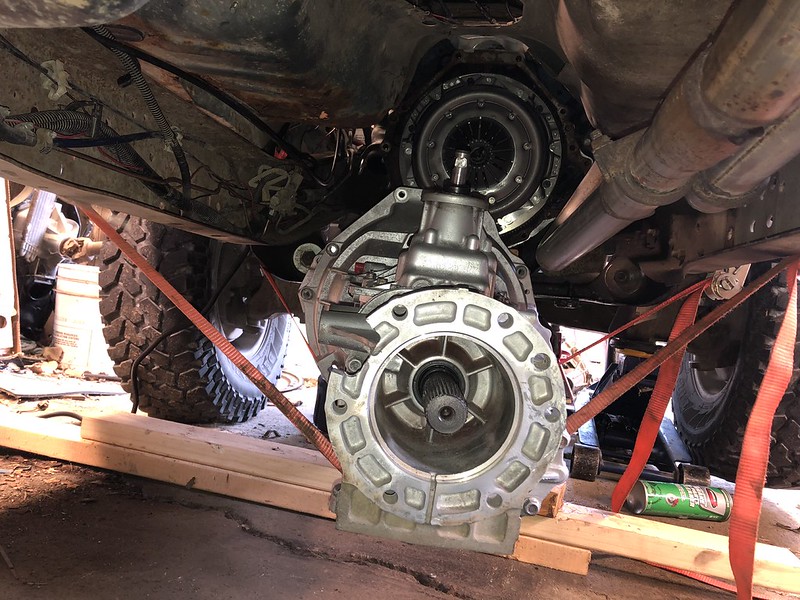

Ok feeling brave now, time for the t-case.
'85 Ranger Restomod

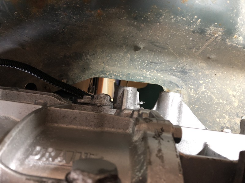

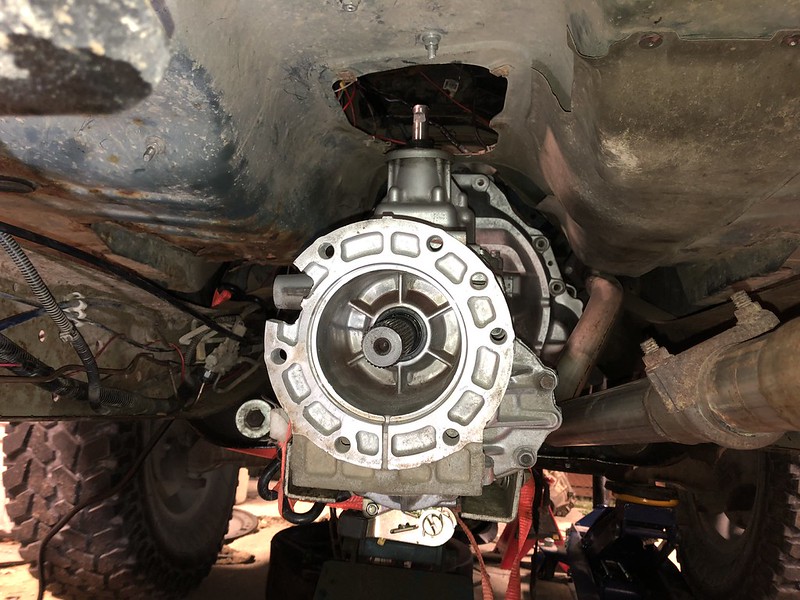

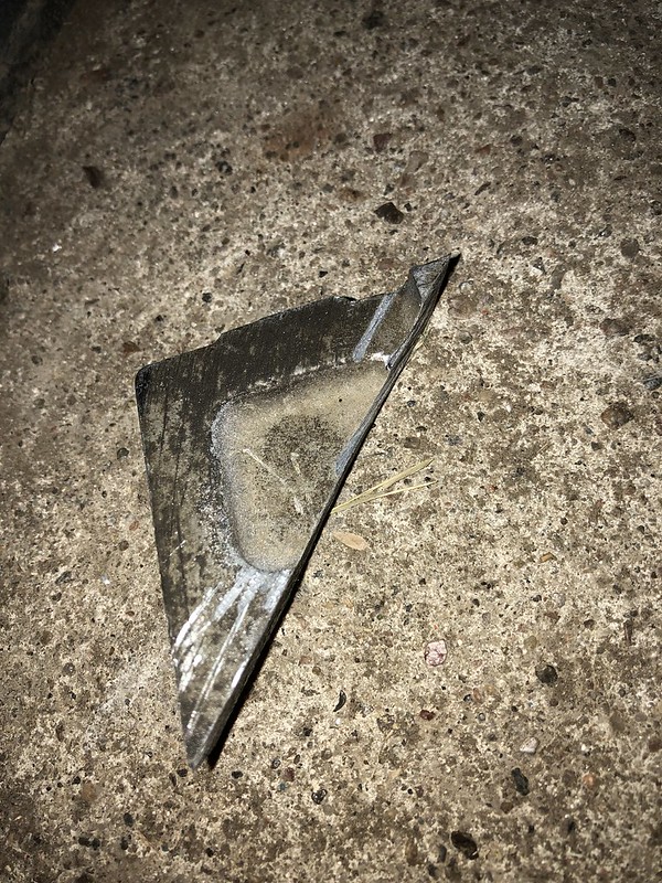

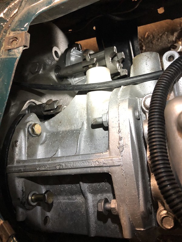

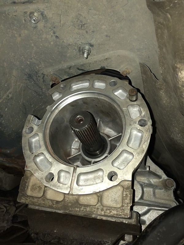

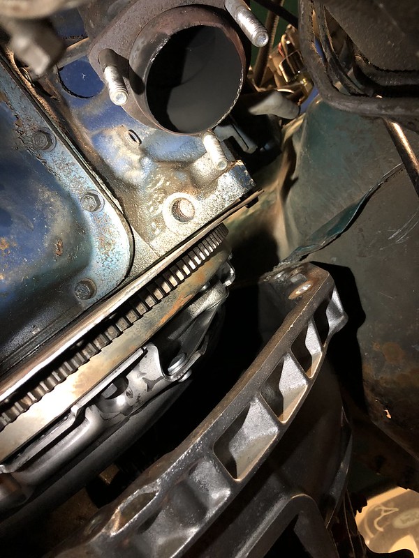

I got it in there lined up and everything was looking great but it wouldn't go the last little bit. Discovered the countershaft pin was hitting the transmission case. So I had to back the t-case off and hacksaw the corner off the transmission. Kinda almost seems like this transmission and t-case were never intended to go together by now doesn't it?
The nut between the input and front output is on the countershaft pin.
'85 Ranger Restomod
The bottom left (drivers side) corner of the transmission is what is hitting.
'85 Ranger Restomod
The factory mounting was just round and offered no such interference.
'85 Ranger Restomod
So with a liberal application of a hacksaw (that I really need to remember to get a new blade for) that corner is gone. Not sure if that counts as cutting corners or not...

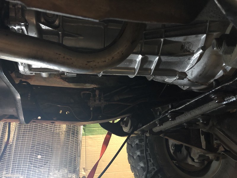

And IT IS IN!!
'85 Ranger Restomod

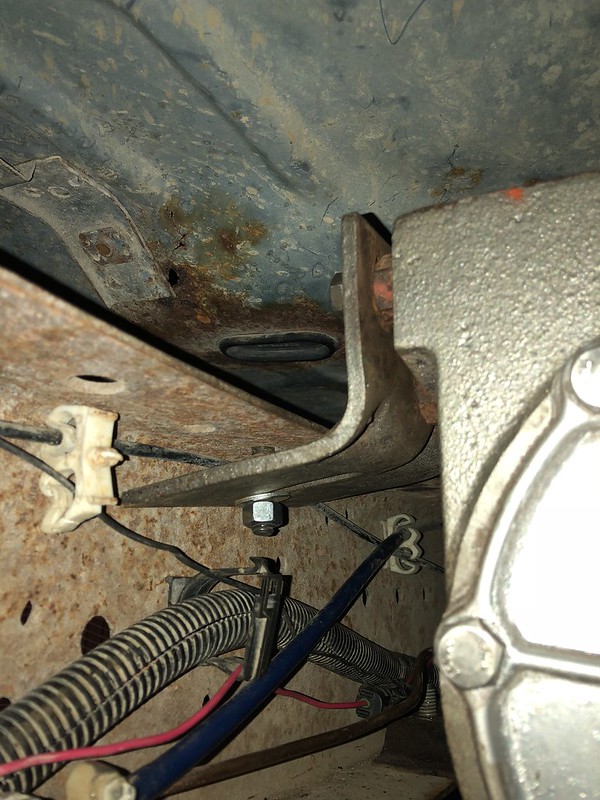

I need to work on where it mounts to the frame rail, mainly get a piece of angle iron I think and get the bushings for it. It is hanging from a single 3/8" bolt at the moment with the jack under it helping a little bit.

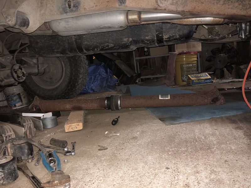

I had a third gen Explorer driveshaft in my parts cache... and it is too short. I don't think my driveline is any shorter than it was with the little C5/1350. The compact 205 is making up for the longer M5R2.

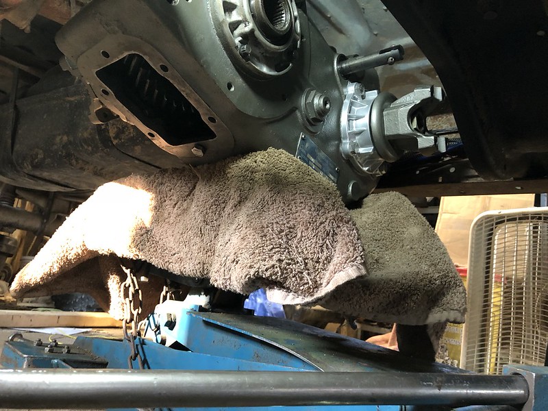

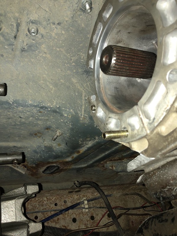

Glued in the t-case bolts last night. Biggest gripe about this case aside from its weight is every freaking hole is a thru hole and pretty much every bolt has to have sealer on it. Can't wait to see how many leak...
Nice easy access from above:
'85 Ranger Restomod

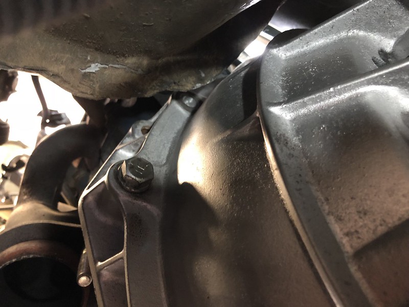

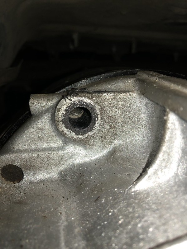

I had 5 bolts in and tight, #6 would not start at all, top PS one.
'85 Ranger Restomod
Guessing maybe 1/8" off... not sure how that worked. I probed it and it was not my ring,the t-case itself was off. So I loosened the other 5, got a jack under the t-case and twisted it up some and got that bolt started. Let the tension off and all bolts turned freely by hand so I don't think anything is in a bind now. Weird deal...

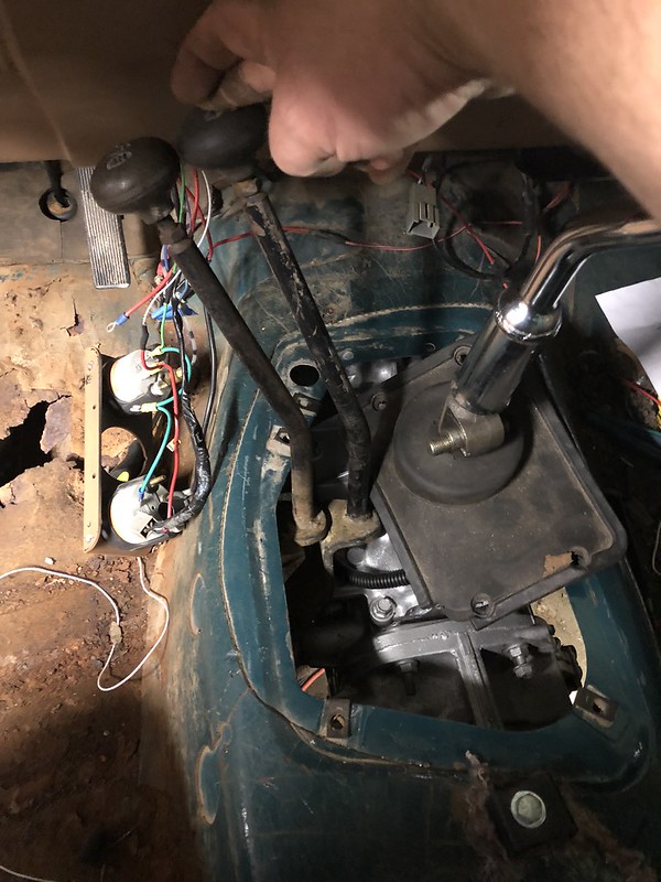

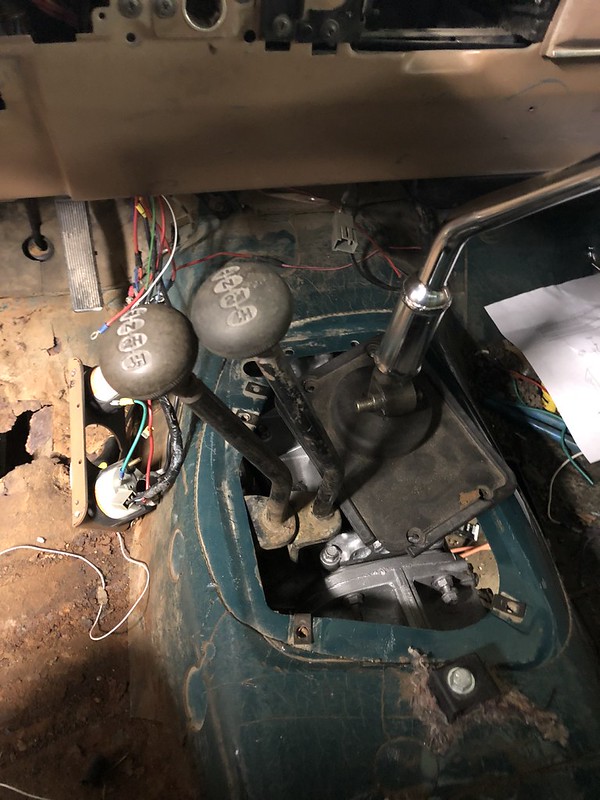

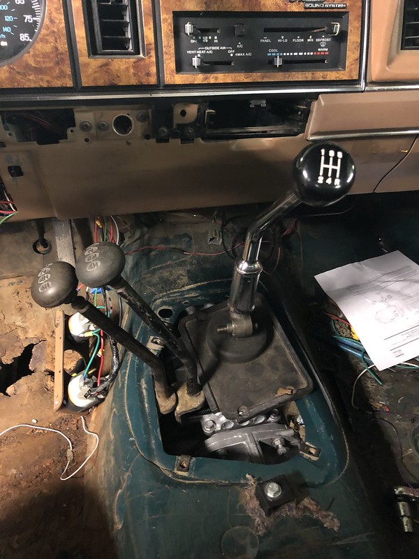

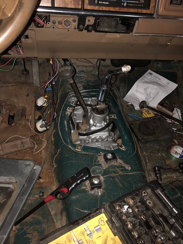

Anyway, played with t-case levers some more.
Both will clear the stock floor hole:
'85 Ranger Restomod
Trans is in second, it can't get any farther to the left. Lever probably wouldn't be bad if not twin sticked but another one outboard of that one could get obtrusive. Thinking of straightening and shortening them. At least shortening them anyway.
'85 Ranger Restomod

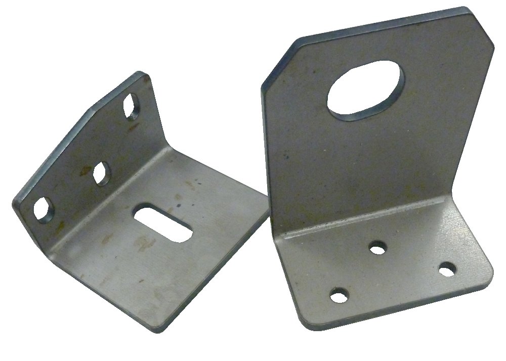

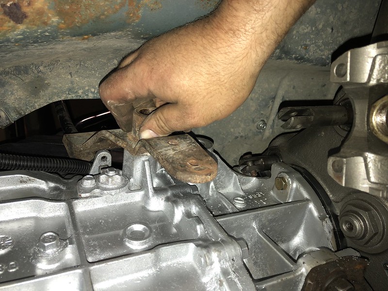

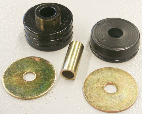

Did some research on what t-case bracket is supposed to look like, shouldn't be too hard to replicate.
'85 Ranger Restomod
https://shop.broncograveyard.com/NP-205-Side-Brackets/productinfo/21673/
I don't need that much reach (as if my frame is narrower than a fullsize or something) so a stock/stock replacement one won't do me much good. Bushing is interesting though. It actually goes thru the plate I need to make.
'85 Ranger Restomod
https://shop.broncograveyard.com/19...sfer-Case-Side-Mount-Black/productinfo/23095/
