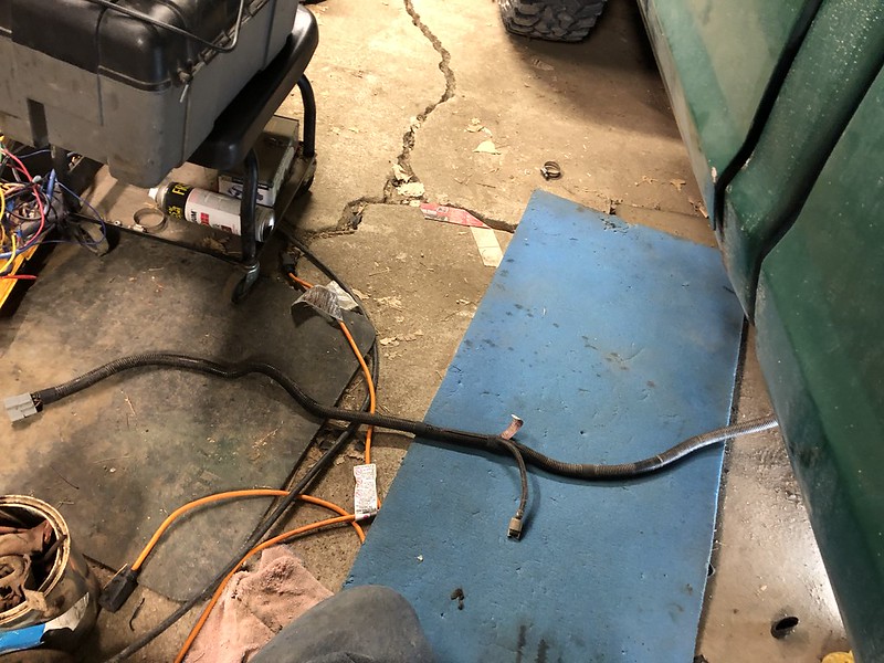

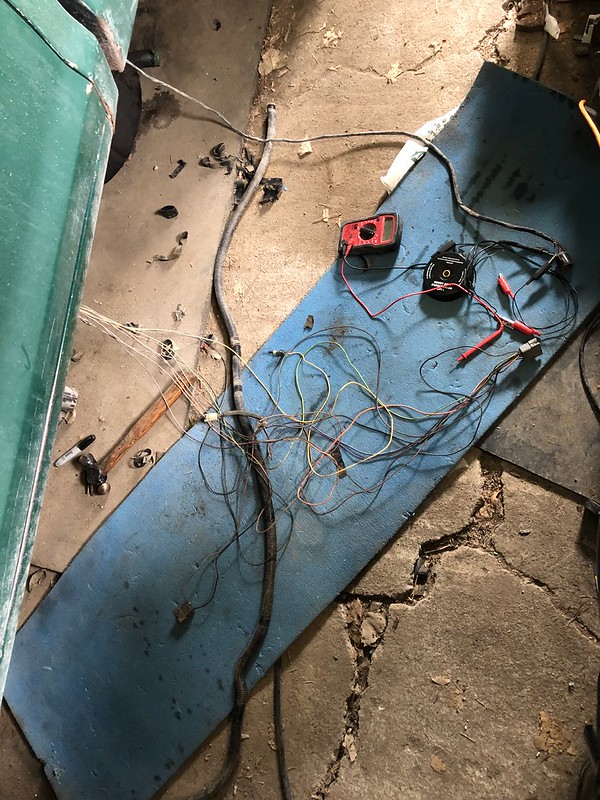

Well I got the front of the harness pulled out of the engine bay so I could actually access both ends of the harness at the same time which made things easier.

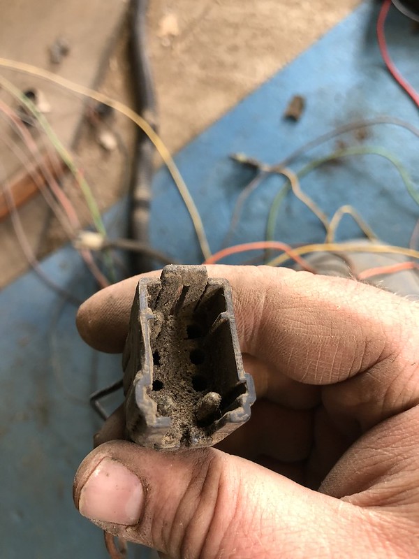

I followed the ground wire from the back to the front, found where it spliced (factory) and tied into other things (probably the fuel sender, seat belt switch and maybe dome light)... and it went to an unused connector that has been friendless and rolling around on my frame rail in the engine bay. :icon_confused:
As you can see it hasn't been used for some time, it is still covered with 2.8 drippings. I don't know how the lights ever worked, I don't know if Farmer Fran made his own ground somewhere behind the fuel tank and it finally rotted off or I have a short somewhere or really what is going on. I put it to ground and the lights work fine. If it is a short it is weird the ground wire happened to short perfectly for so many years for the lights to work perfectly until now.
I will pick on the tail light wiring to make sure it is ok but aside from what I can't see behind the fuel tank I don't see a thing wrong with the wiring from the engine bay to the back of the truck.

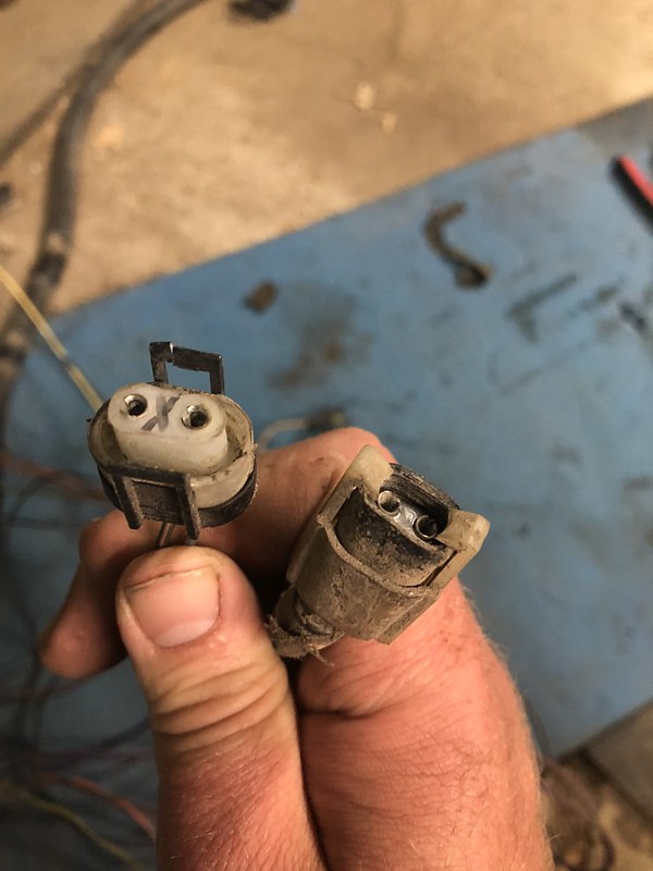

I found this, anyone know if the one on the right is for the backup lights for an older manual trans?
Left is for my M5R2, I am thinking while I have it all out on the floor I might as well get that wired up so I can finally have backup lights when I get the other trans in.

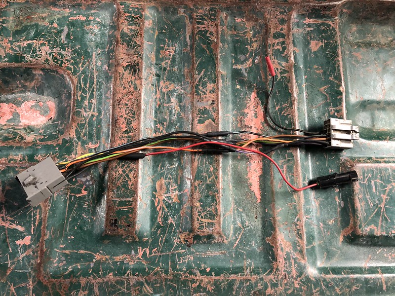

Ok, doing more research the '85 had two connectors running to the back, the later trucks (like my '88 dash harness donor) had one bigger one. So I went to the JY and snagged the bigger one to combine the two '85 connectors into one (actually the same connector I used to run my added wiring around the front of the truck)
I have more pins on order but I did seal all the open red butt connectors the PO had in his adapter harness. I want to incorporate the VSS wire into the big connector as well (the single loose one with a GM weatherpack connector) The loose wire with a red butt connector is where I need to put power to for the backup lights to work, I just stuck the butt connector on it and left it as a placeholder. I am also going to shorten this harness considerably, it could be half as long and still work fine. I am about two inches short of just being able to delete the thing.
Harness is all buttoned up with cloth electrical tape as per original, even taped the part number tag back on for originality (since you know, nothing is original on this thing every little bit helps :icon_thumby:)

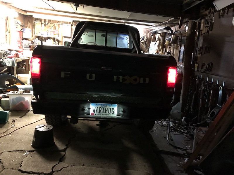

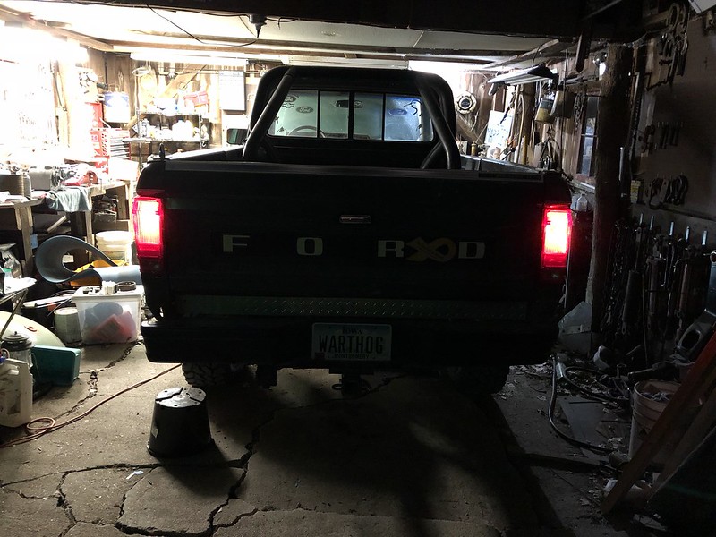

Let there be light!
(top one is just brake lights and is much brighter but my phone made it look the same as the tail lights)
