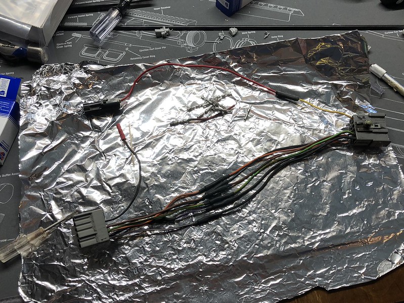

The most fun is trying to figure out what the last guy did and why... and it has been hectic so I only get little bits of time here and there to pick at it which makes wiring chases even more fun.
good job.
Thanks!
I am trying to make it s clean as I can.
Lights work but the dome light and fuel gauge are on the fritz...

Had some help...

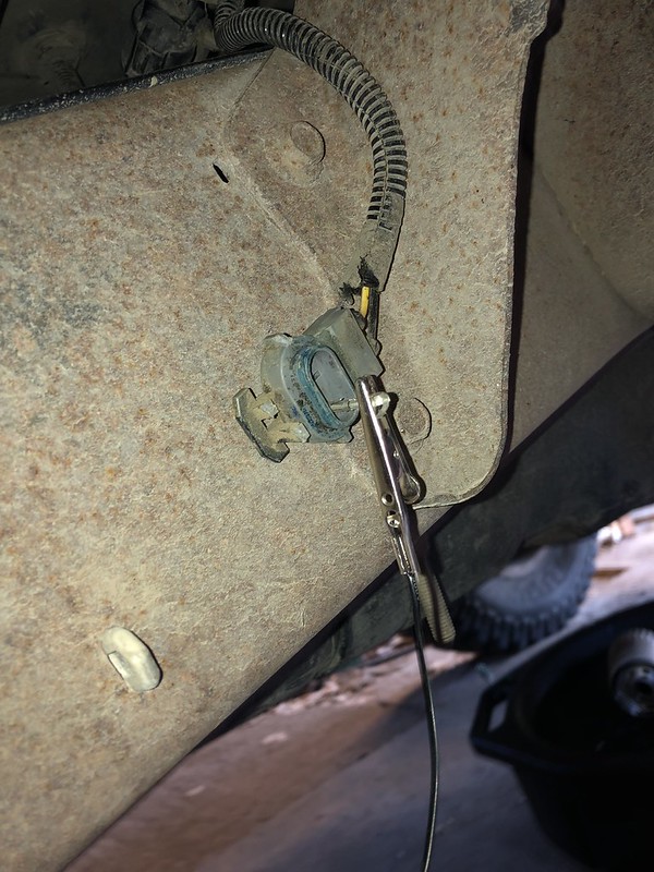

The single GM weatherpack connector I thought was for the VSS was actually for the fuel sender Clearly I did it, I have that and I think the dome light finally sorted. Maybe the connector was bad or the wire was bad... I don't remember. Neither here nor there, it is going away.
BTW, if you need to test a fuel gauge connector and see which wire does what at the other end a female GM weatherpack pin fits perfectly.

Time to clean up this... mess.

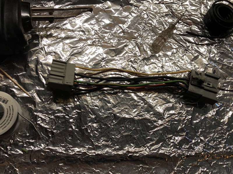

'85 Ranger Restomod
'85 Ranger Restomod
Now if it wasn't almost 100* out I would go put it in and try it...
I stuck the pigtail in it, everything works fine aside from the dome light which is really dim and occasionally pops the fuse. :annoyed:
There is light at the end of the tunnel... and I don't think it is a train!
Somebody (lets just blame the PO again, I don't want to talk about it) had grounded the courtesy light which would pop the fuse. Not sure why the ground branched off but I must have goofed when I switched the courtesy light to the other connector and instead of going nowhere like the PO had it I matched it to another black wire.
It has never worked since I got the truck so that will be a nice perk to have working now.
All is well, both ends of my adapter harness and the truck harness are a mirror image of the connector on the dash harness (C118 which I did not tamper with at all)

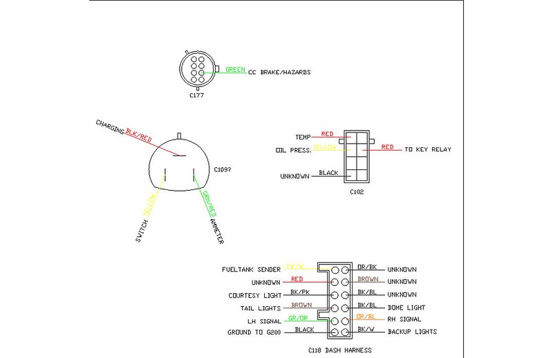

That is why I have been on a kick to clean up my wiring and document my own mods (and what the pinouts for connectors are as I come across them) In draftsight I made a rough outline of my truck and have the connectors placed roughly where they are on the truck to make finding them a little easier. Drawing it out on the computer is fun too.

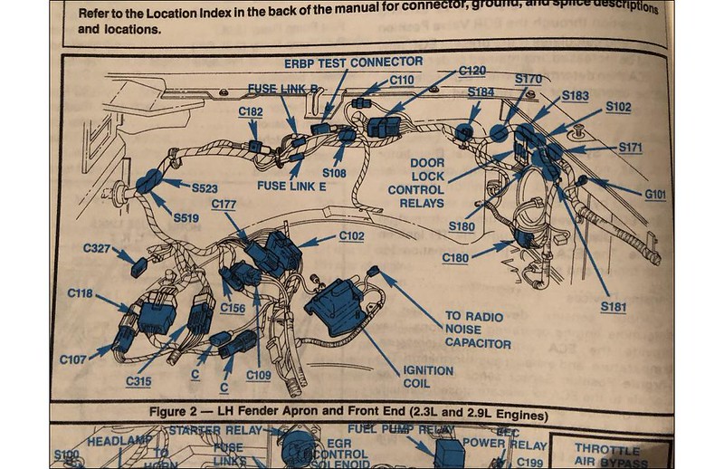

If your '87 is wired like an '88 (or my '85 which has an '88 dash harness) I am pretty sure the alternator harness enters the dash harness at C109.

Mine has no signs of a shunt between the alternator and C109, maybe hit a JY and see if you can find one on a different harness? They don't show anything in the '88 EVTM wiring diagram either.

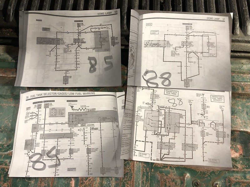

The 87 EVTM shows a shunt wired in between the ammeter leads. I don't know if it's in the harness itself, or if it's soldered into the ammeter connection on the back of the cluster.
Thanks! :icon_thumby:
I was still on my idiot light page, looks like the shunt should be near if not with the gauge.
Interesting it looks like the green and yellow wires do different things between the two clusters:
