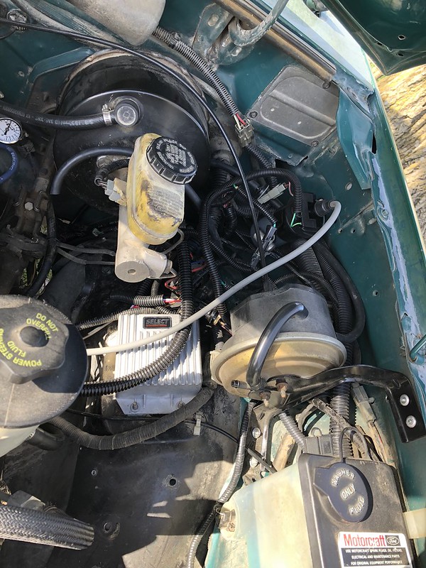

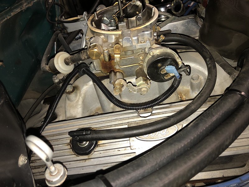

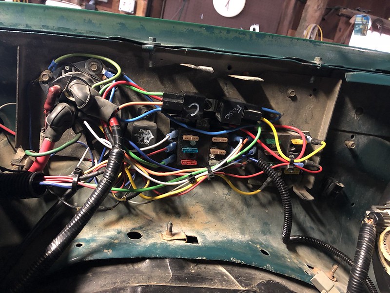

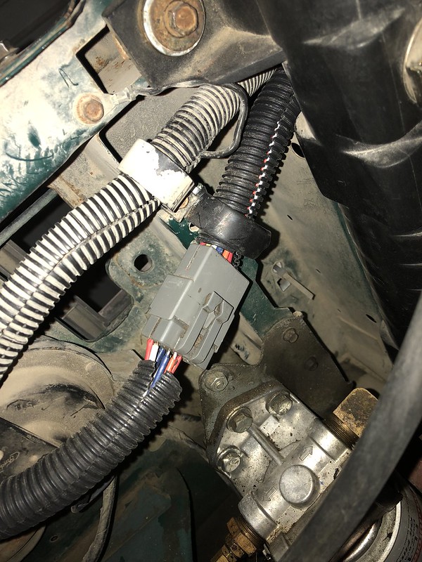

Choke wire is pretty much out of sight with the air cleaner installed (which I cleverly forgot to get a pic of)
'85 Ranger Restomod
Harness is secured across the front:
'85 Ranger Restomod
Truck runs, wiring is done. Onto the next thing... the 205

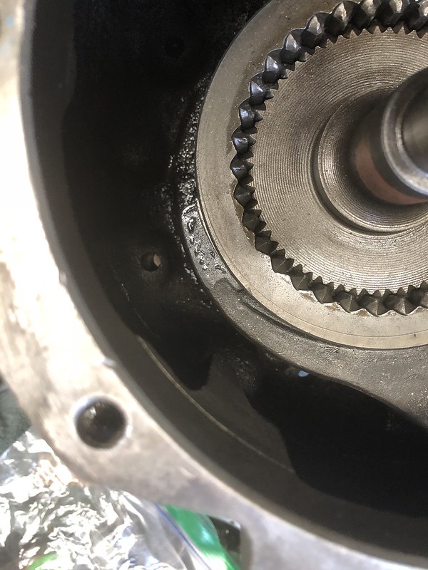

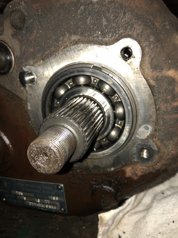

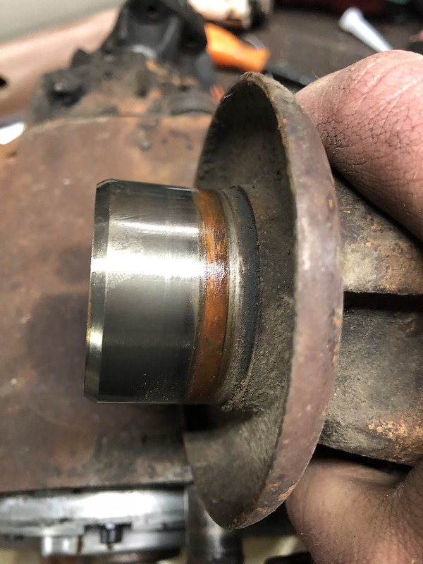

Front output shaft yoke seal area is about like new but needs cleaned up a little
'85 Ranger Restomod
Bearing is clean, tight and pretty much looks like new:

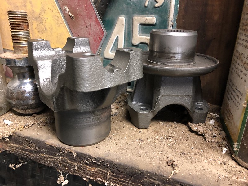

'85 Ranger Restomod

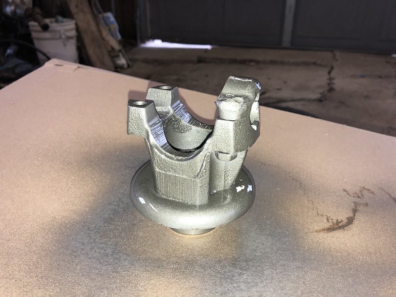

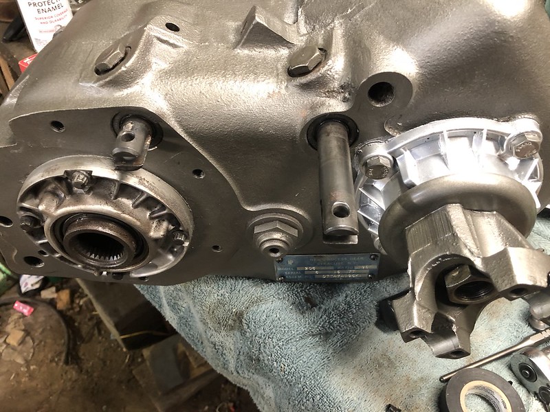

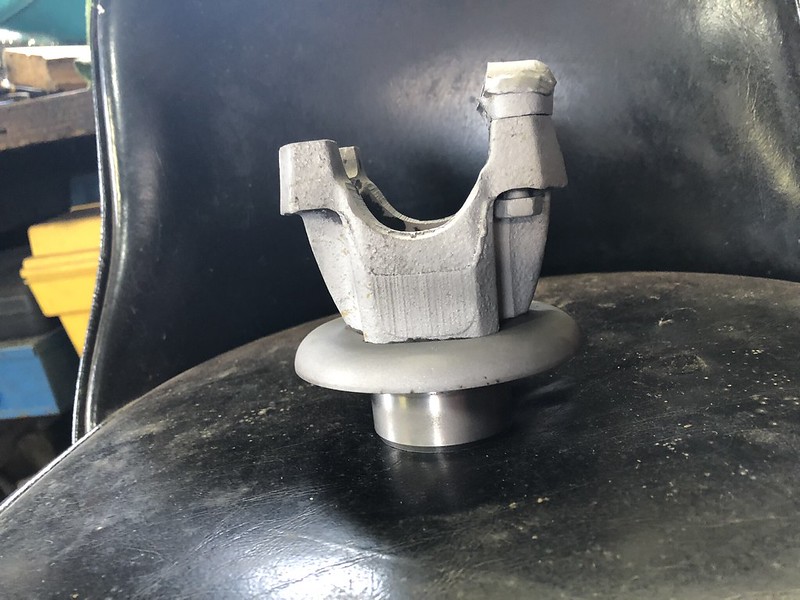

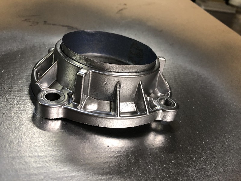

Sandblasted and painted the front yoke. Since per rustyolranger NP205's shipped unpainted I am painting the cast iron bits in cast iron spray paint and the aluminum in aluminum. The cast iron color is really sharp, it looks like brand new cast iron but a little glossier.
'85 Ranger Restomod

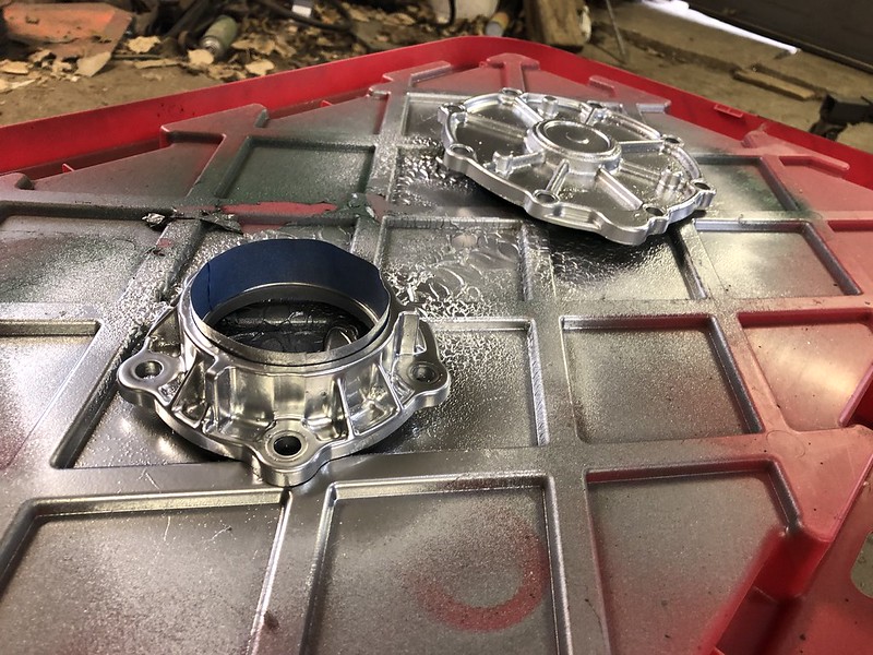

'85 Ranger Restomod
Also cleaned and painted the front seal retainer.

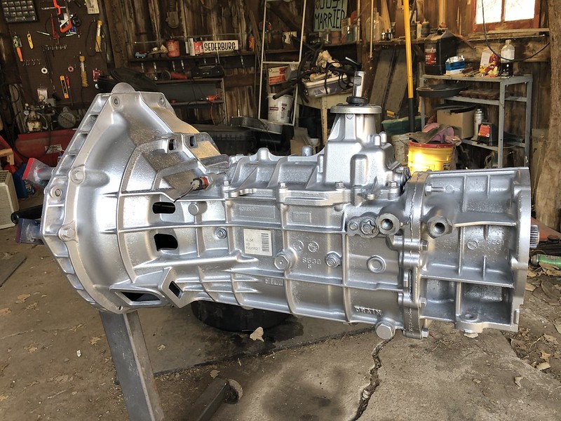

Trans is looking pretty:

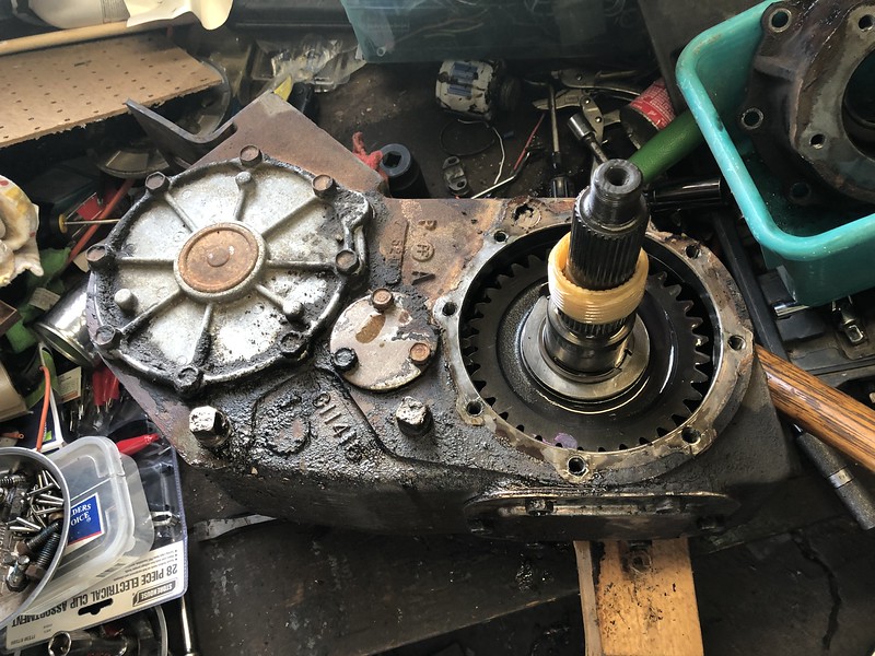

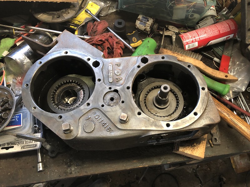

Then I attacked the t-case.
'85 Ranger Restomod
'85 Ranger Restomod
'85 Ranger Restomod
I really like this paint. :icon_hornsup::icon_hornsup:
'85 Ranger Restomod
And now I have a ton of parts to clean tonight...

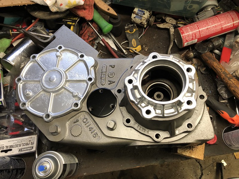

Got a little more done tonight:
'85 Ranger Restomod

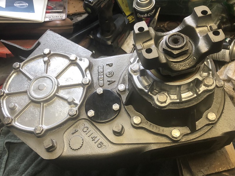

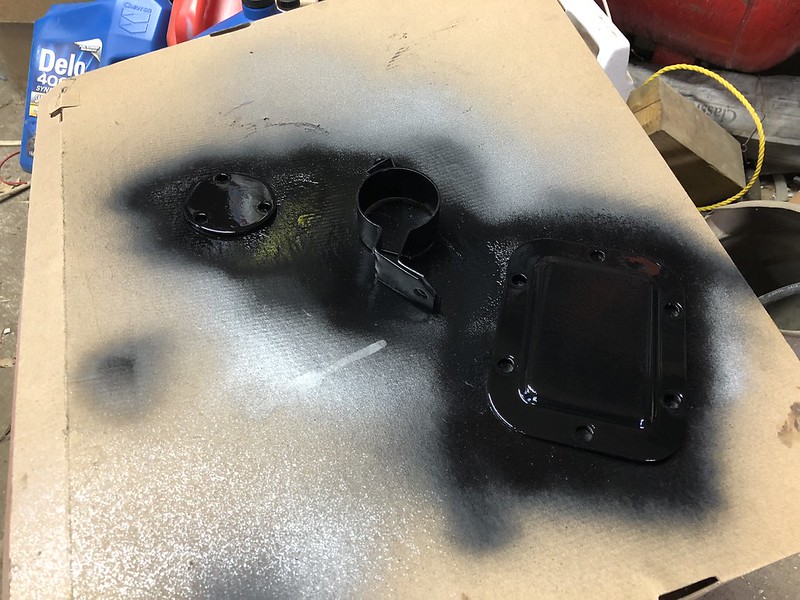

I decided to go black for the countershaft and PTO covers. Still have no clue what to do for hardware yet.

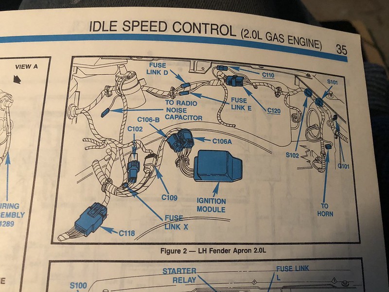

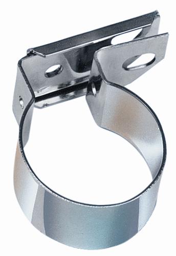

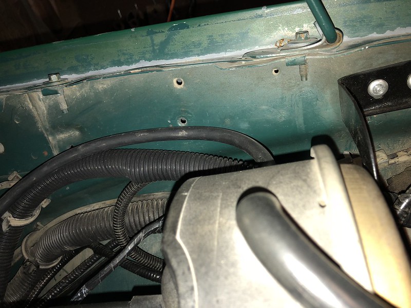

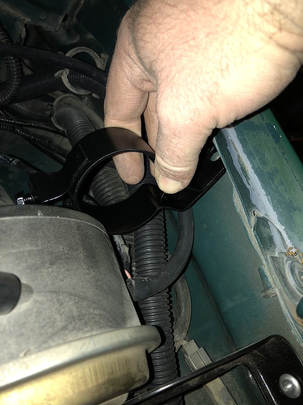

I snagged a factory can coil bracket out of a 2.0 truck a few years ago in case I needed it... found the factory hole in my fender but apparently speed control was not available with a 2.0
'85 Ranger Restomod
'85 Ranger Restomod
So now I gotta find a V8 bracket that mounts on the intake.:annoyed:
Probably not the end of the world, I would rather have it on the fender since I think it would be cooler but my coil wire would be way too short. :dntknw:
EDIT:
I need to play with it more, an '85 Mustang coil bracket looks like the same as what I have, it sits on the engine differently than I thought:
'85 Ranger Restomod

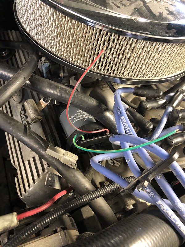

I mounted the coil how they were on a 302, I really wasn't happy with the location. The choke is right there, the heater hoses are right there, the capacitor is hanging out in the middle of nowhere above the valve cover... it is a busy area. It was nice and out of the way (and my coil wire could have simply been shortened) but I really wasn't happy with how it was.
'85 Ranger Restomod
So I consulted the EVTM (to also see how the DS module sat on the inner fender since I was losing the ecoil)
'85 Ranger Restomod
I was way too far ahead, lets revisit that:
'85 Ranger Restomod
I think I guessed too far back, I need to watch for another 2.0 truck and see exactly which hole they used.
It didn't do anything to help my heaping helping of spaghetti on my drivers side fender but it sat and idled for half an hour and the module was just as cool as the fender. With the ecoil the same module could only idle (or drive slow) for about 5min before it would overheat. It had to have airflow coming thru the grille to stay cool enough to function.
Personal theory, having the computer still receiving tach signal watered it down and helped the module go longer, once I removed it got a lot worse.

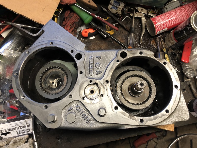

T-case is starting to go back together:

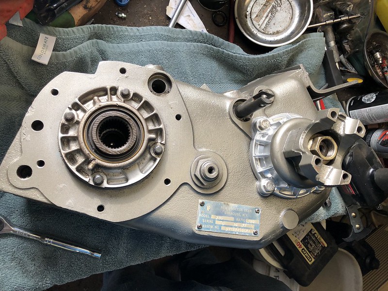

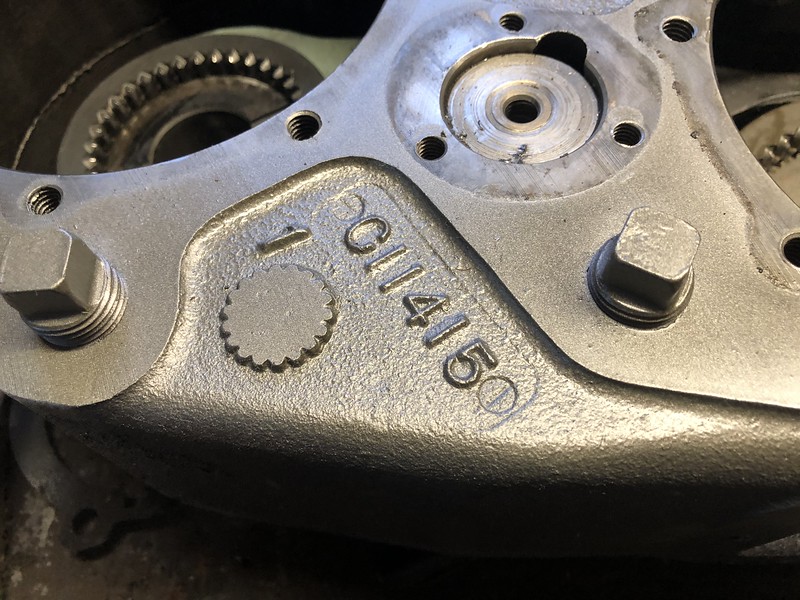

Anyway, got the vital data plate reinstalled:
'85 Ranger Restomod

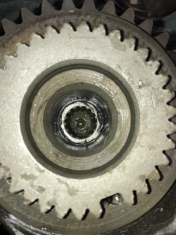

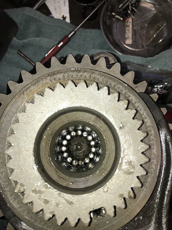

Installed new pilot bearing rollers:
'85 Ranger Restomod
And the retaining washer and clip:
'85 Ranger Restomod

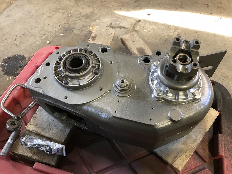

T-case is mostly done, I need to decide if I am going to twin stick it or not and put that shift rail in yet. Probably will just install the pto cover dry and finger tight so I can remove it when I wrestle the case into the truck.

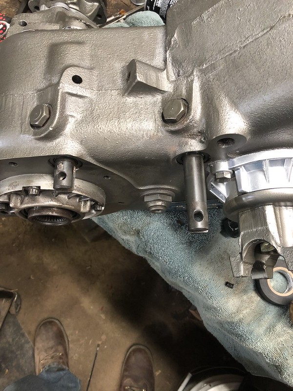

Took the plunge:
7/16" off here:
'85 Ranger Restomod
'85 Ranger Restomod
3/8" of here:
'85 Ranger Restomod
'85 Ranger Restomod
RWD Low:
'85 Ranger Restomod
RWD High:
'85 Ranger Restomod
4wd Low:
'85 Ranger Restomod
It would not shift into opposing ranges, so that is good. Like no front into high and rear into low. :yahoo:

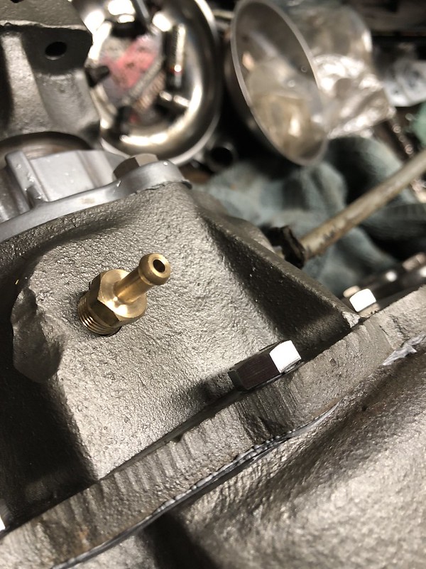

I had tapped the housing to upgrade from the little spring loaded vent cap to a hose barb so I installed that before I lost it:
'85 Ranger Restomod
Looks like we are just using a gasket in a tube:
'85 Ranger Restomod
I tapped the little soft plug in, put a vacuum cap on the hose barb and the t-case is DONE.
