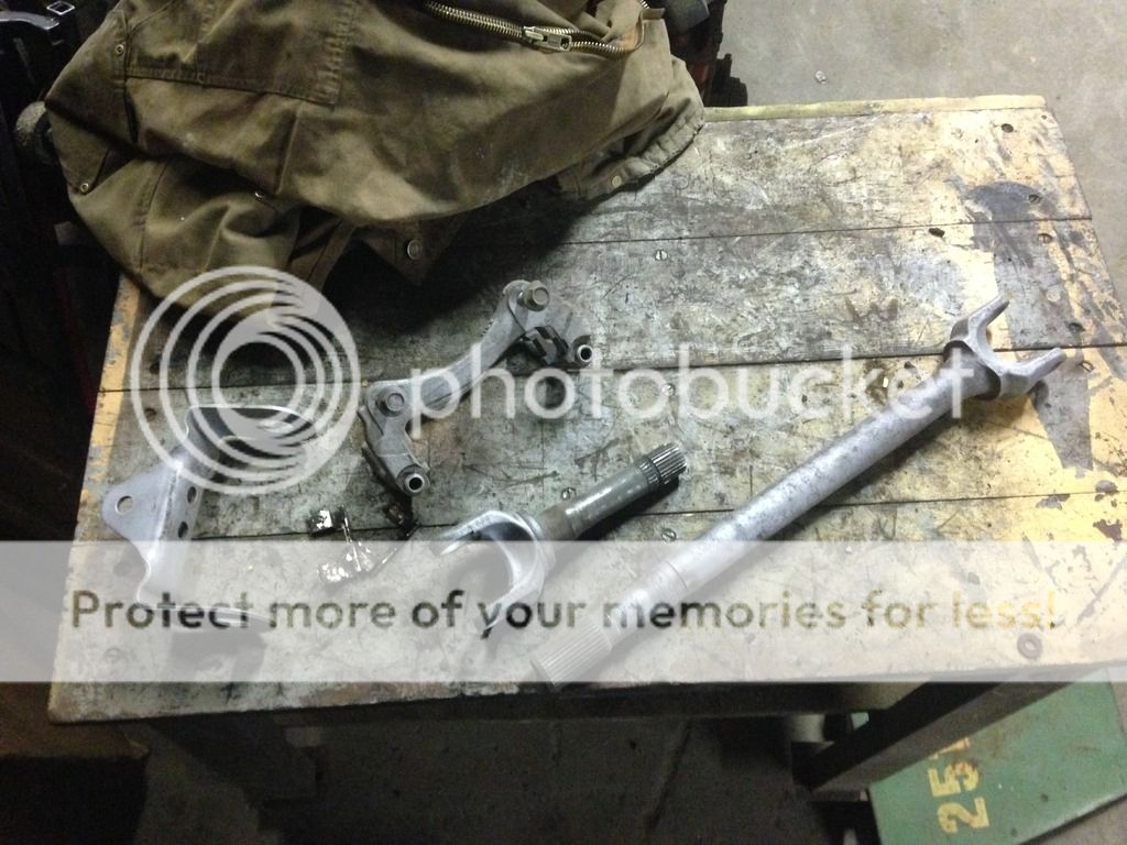

I stayed late last night and sandblasted the parts that haven't been cleaned and painted yet to finish up the PS of the axle.

I put the first order into Rockauto minus the brake line. That one was on clearance but coming from a different warehouse than most of the other stuff so its freight put it close one locally. I also see that it only goes to '85, '86+ are longer so we will wait and see how the one I replaced a couple years ago fits with the wider axle. Never heard of anyone having problems with brake lines though.
I have the spring for the C clip eliminator so I just need to do a little welding and I can start painting.

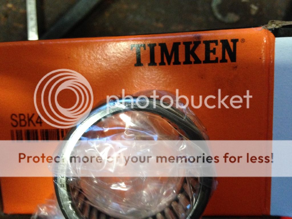

Got a chuckle out of this, a Koyo bearing in a Timkin box. (Koyo is a Japanese company) No worries here, John Deere uses mostly Koyo bearings and they are as good as any.

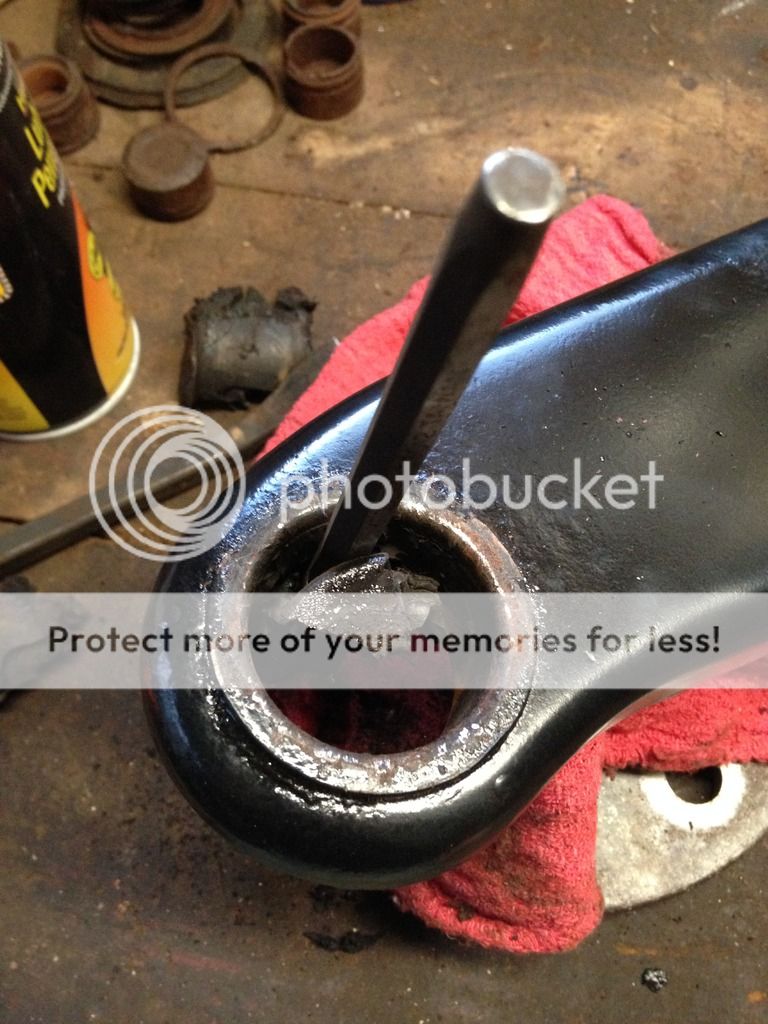

Speaking of spindle bearings, anyone have any pointers on getting the old one out of the spindle?
The proper way would be a slide hammer with the correct attachment I'm sure.
I used a bent screwdriver...:icon_twisted:
Companies don't use their own anymore, you are just paying for the warranty.
So far the slidehammer won't touch it. I found a cute 3 jaw pilot bearing puller at Harbor Freight but the bearing is too close to the rib inside for the jaws to grab anything but the rollers themselves. They won't hold.
It struck me odd that they are both what I would call top quality name brands. It would be like Ford buying Silverados and putting F-150 badges on them.
Like Moog being made in China now.
