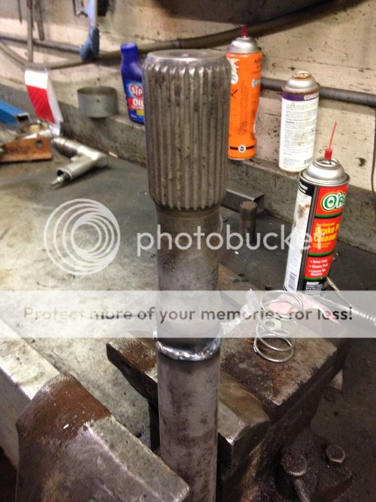

Mud slinger is on the axleshaft.

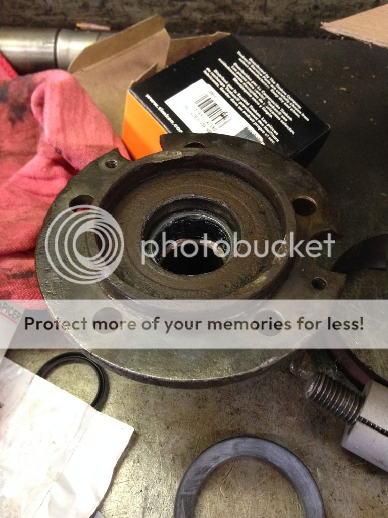

Shined up the spindle where it mounts to the knuckle, packed the bearing and installed it in the spindle.

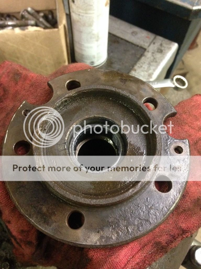

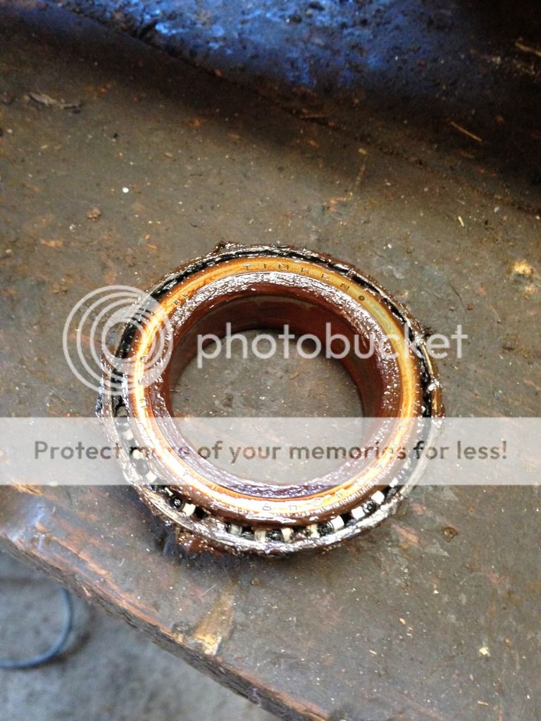

Wheel bearing grease doesn't look encouraging.

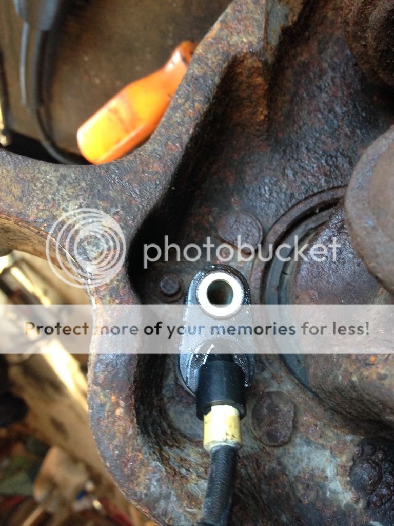

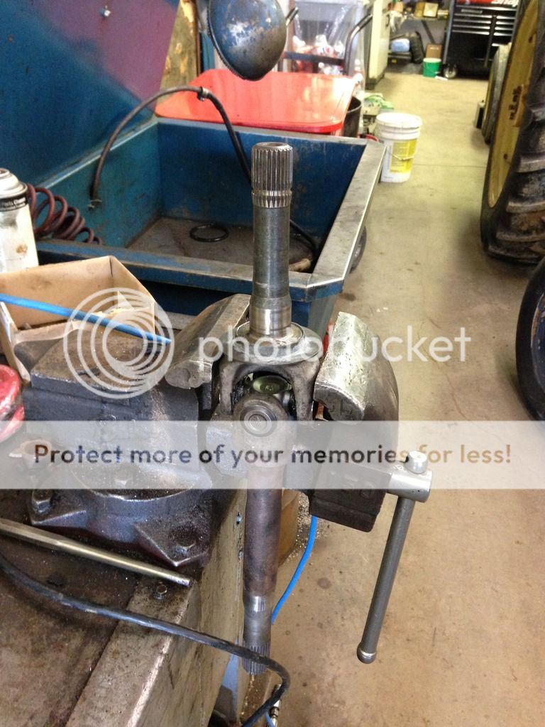

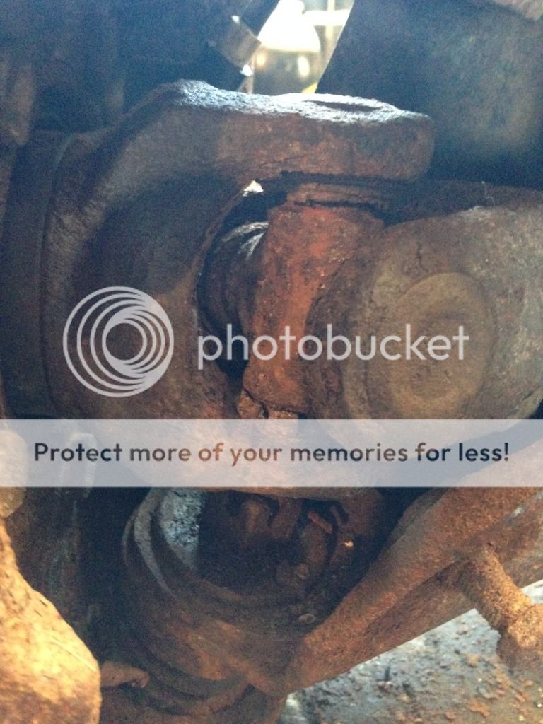

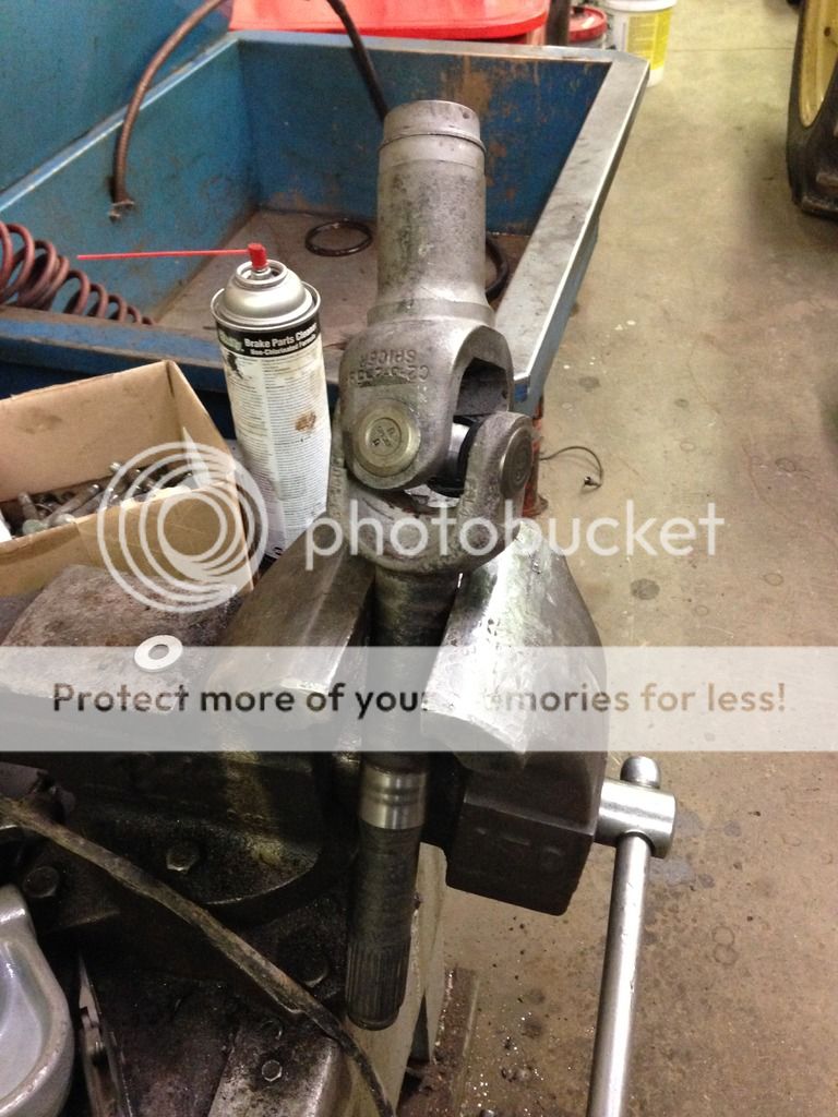

This truck must have been fun to drive, one side of the u-joint is frozen and the knuckle is stuck in this position because the u-joint wouldn't flex. I played with it and eventually got the loose side so the knuckle will move so I could get the stupid wheel speed sensor block out of the way. I am thrilled to be rid of those stupid ABS sensors, they are a PITA.

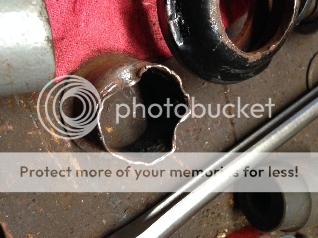

That stupid odd sized screw. Beat a socket on and pray, so far I am 2 for 2 and hope to end my run there.

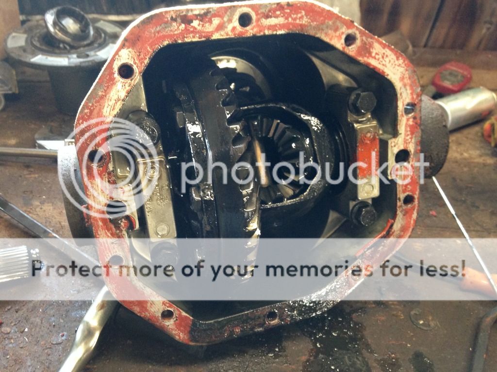

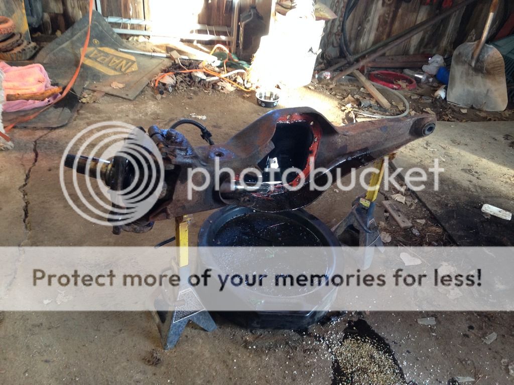

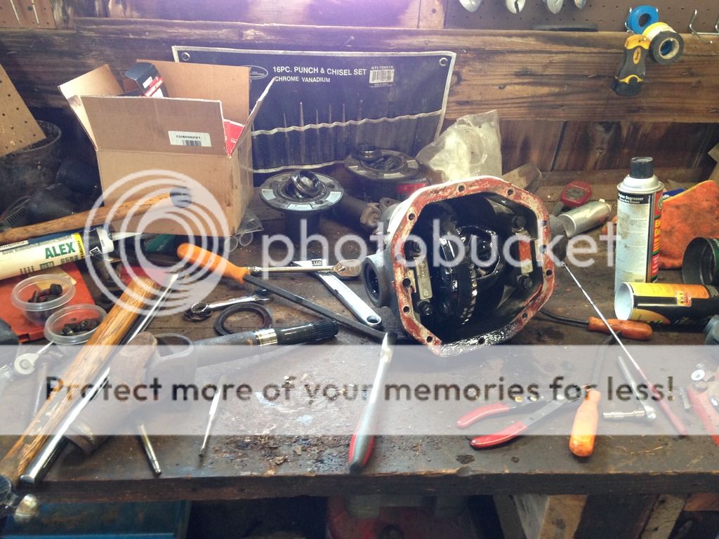

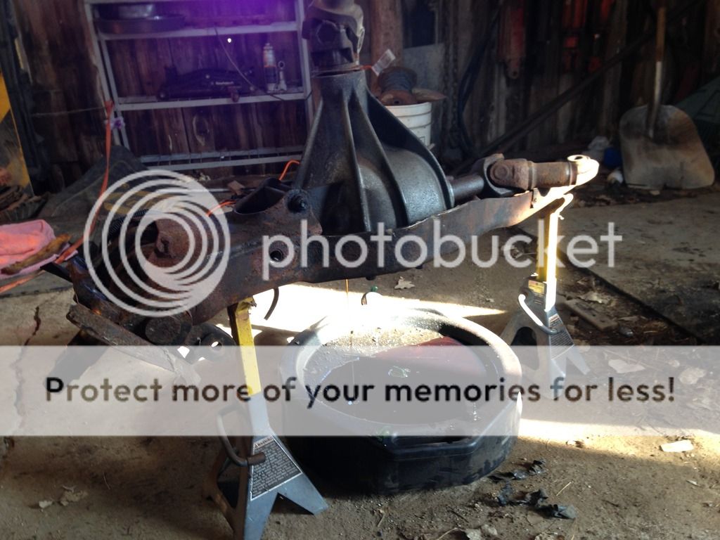

Pulled the diff, looks nice inside:
Nice and clean.

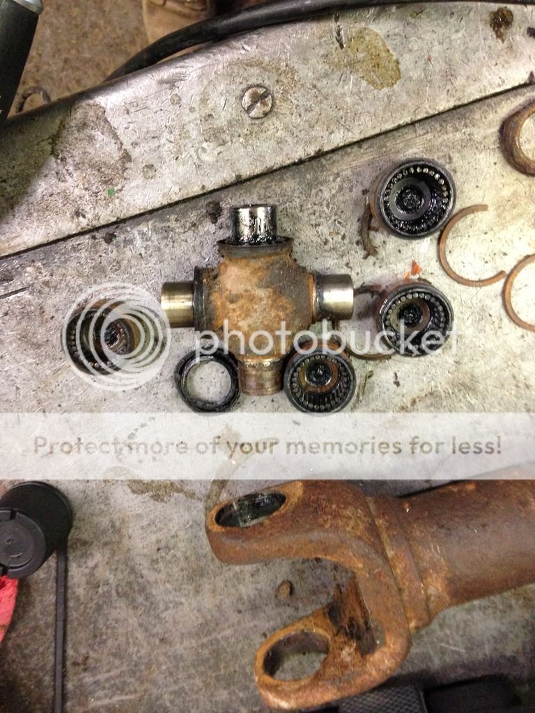

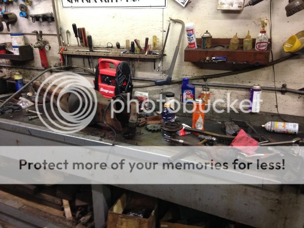

The center joint is the only one worth a crap. All the rollers were still there and still had grease.

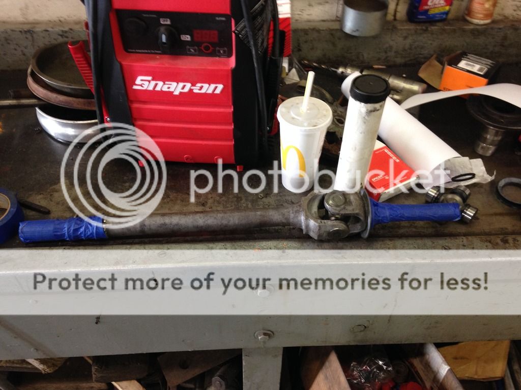

The center joint replaced and the yokes cleaned up. I got one side of it primed too.
Work in progress here:

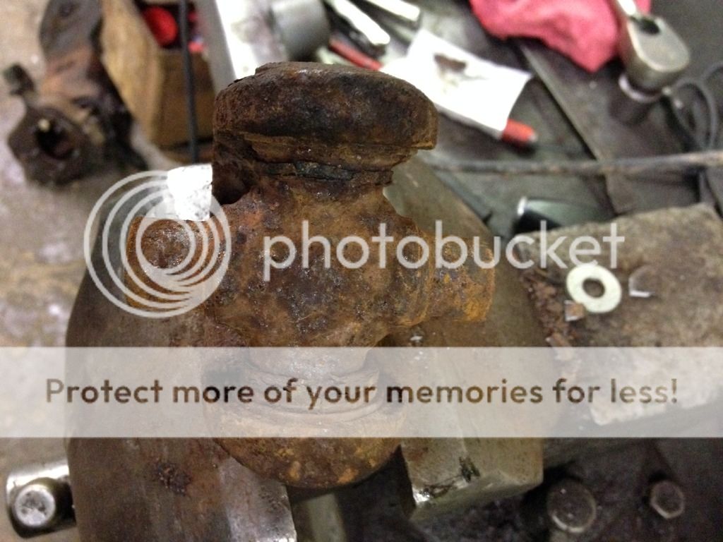

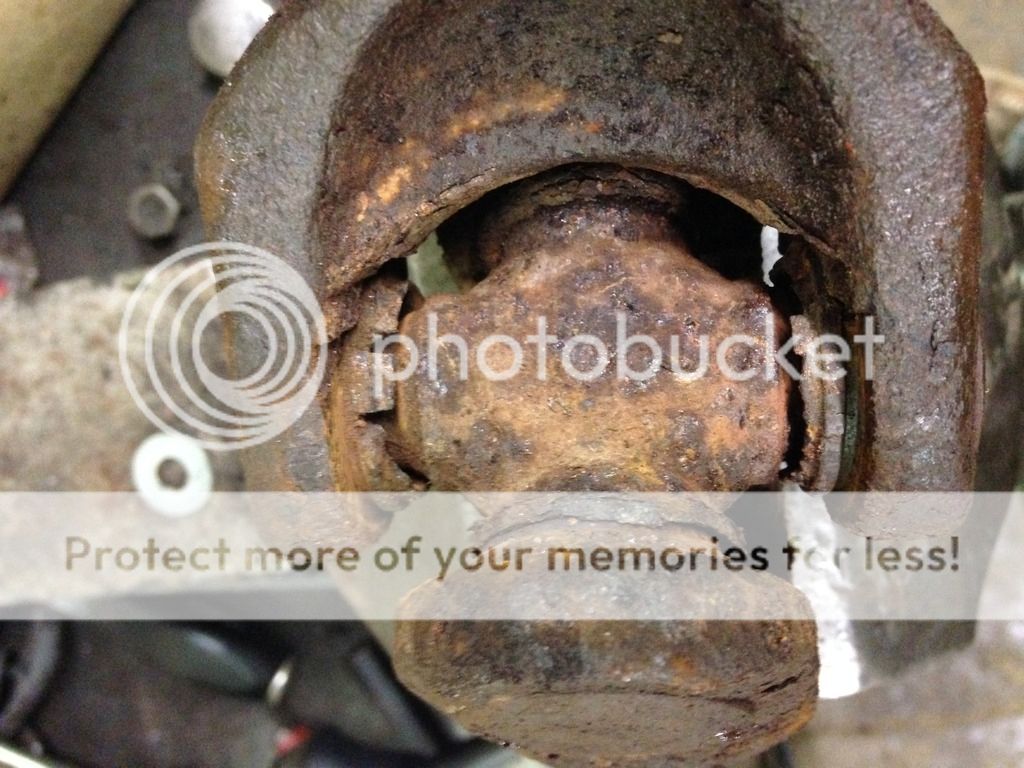

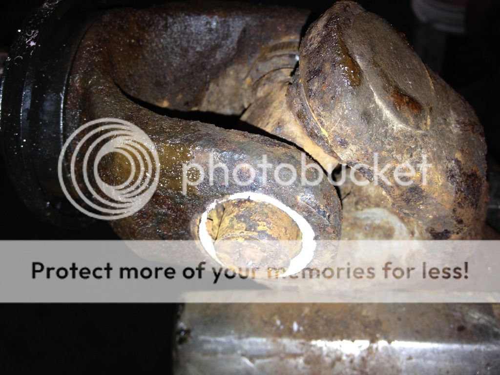

More detail of the nastyness.

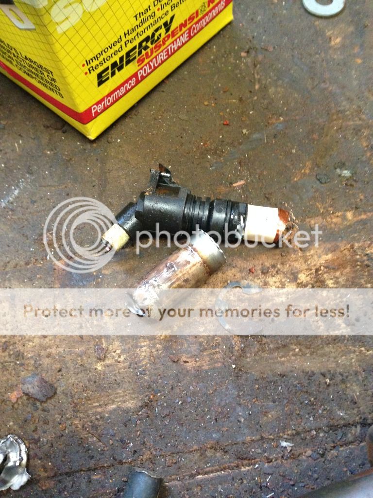

Blew a cap apart.
Gonna have to cut the cross I think, the other two caps are still fused to the cross. I was fighting a headache by now and left it for later.

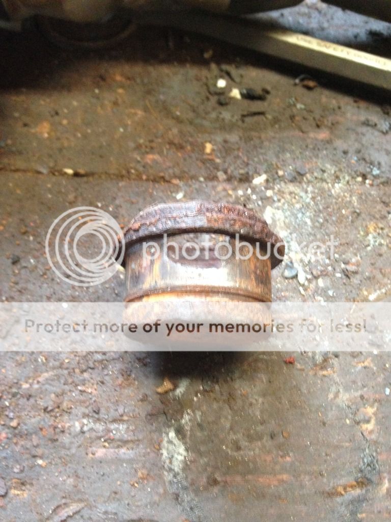

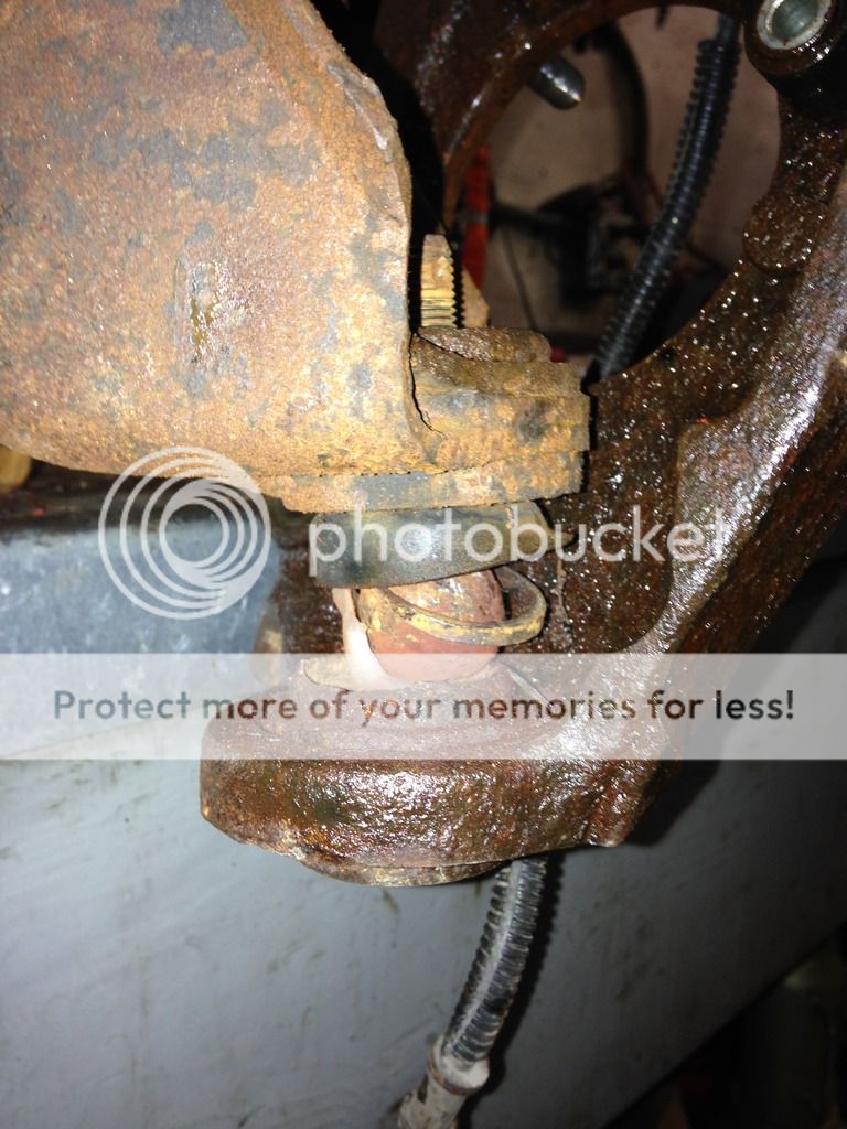

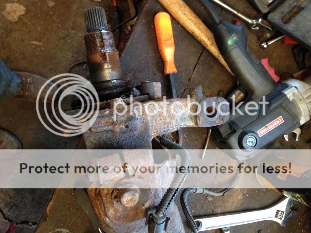

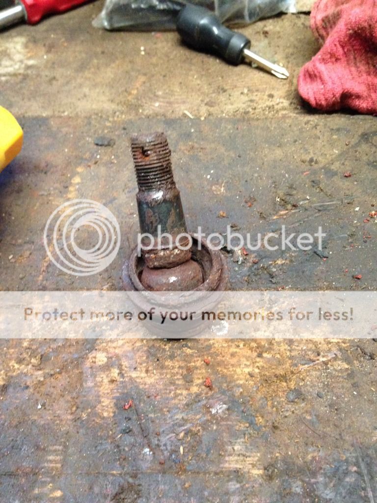

Starting to take the knuckle off, I think I hurt the lower ball joint. Suppose this is one of those rebuildable ones? :icon_confused:

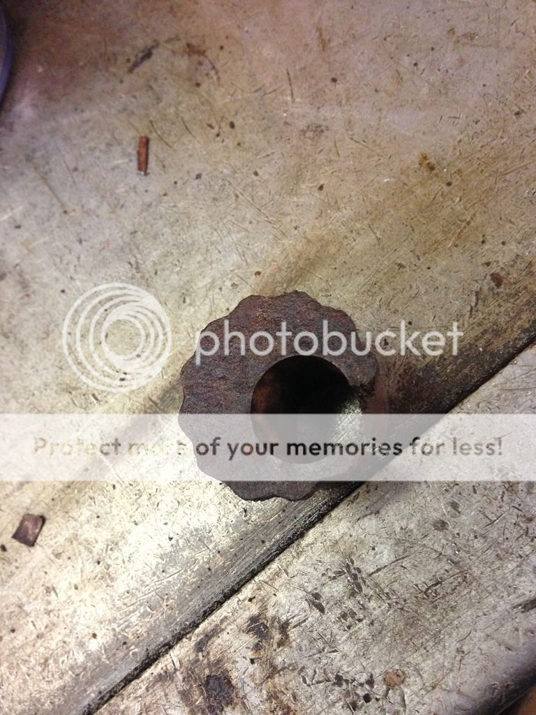

And the alignment bushing kinda crumbled on me. I might just get new aftermarket ones and be done with it. The other side looked different, I also notice it had aftermarket balljoints and the DS probably were original. I wonder if they had to change the bushing to get it to align after changing the balljoints.
That d35 was a complete mess.
It has fought all the way, I think I about got it whooped though.

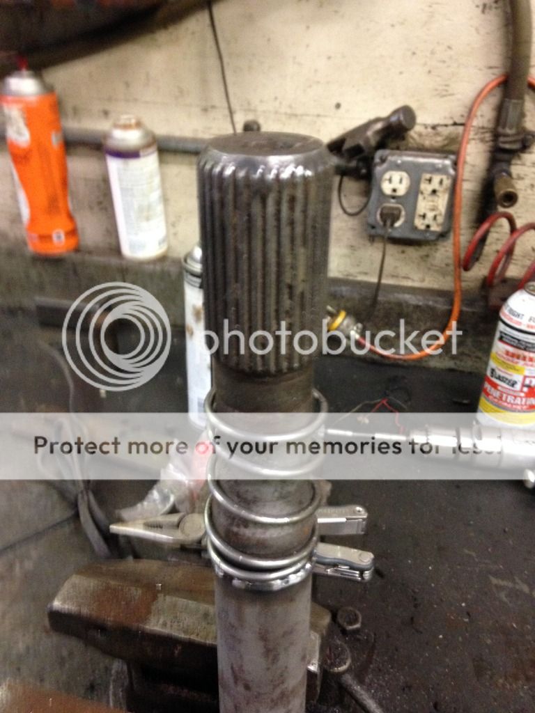

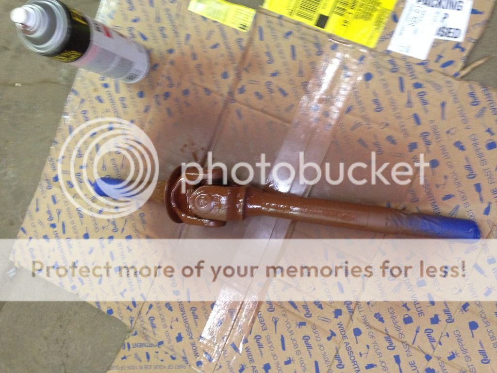

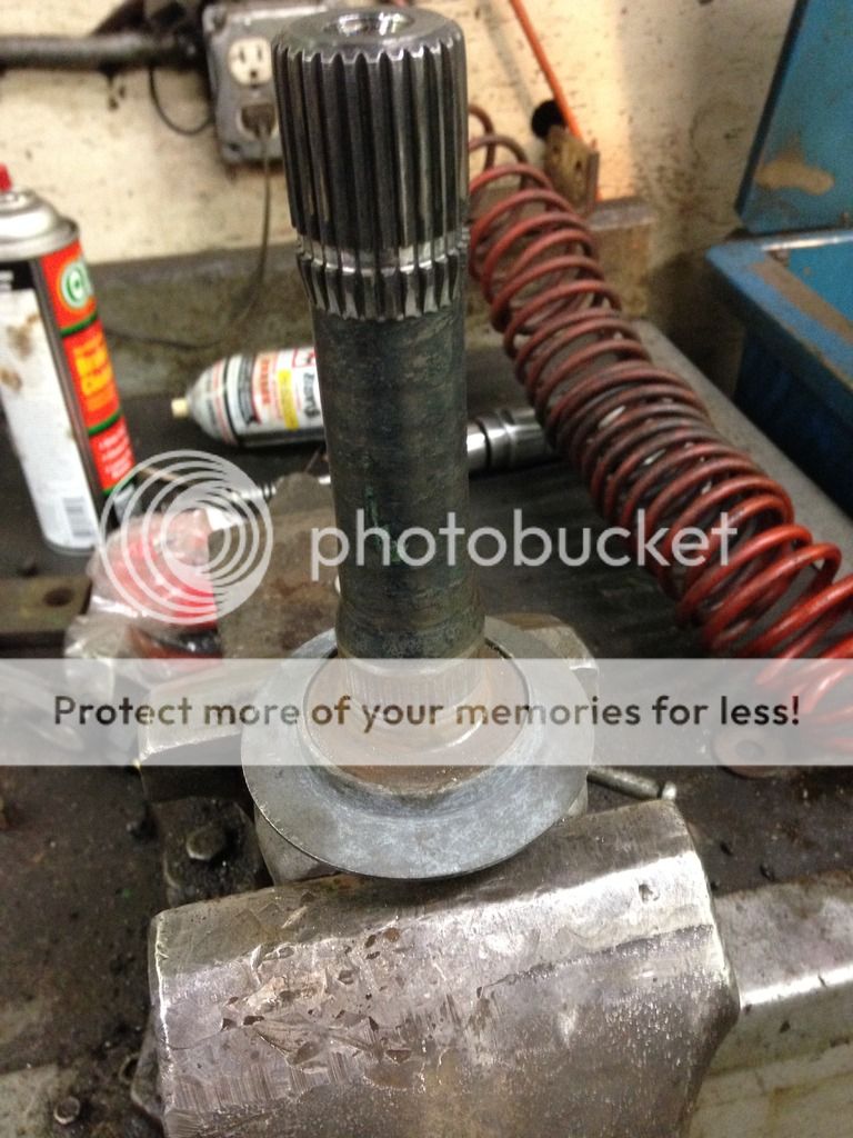

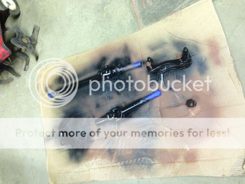

That cross did actually have grease in it, it burned and stunk quite nicely when it was torched out. The last shaft is done and primed:
New spindle bearing is and spindle is cleaned up:

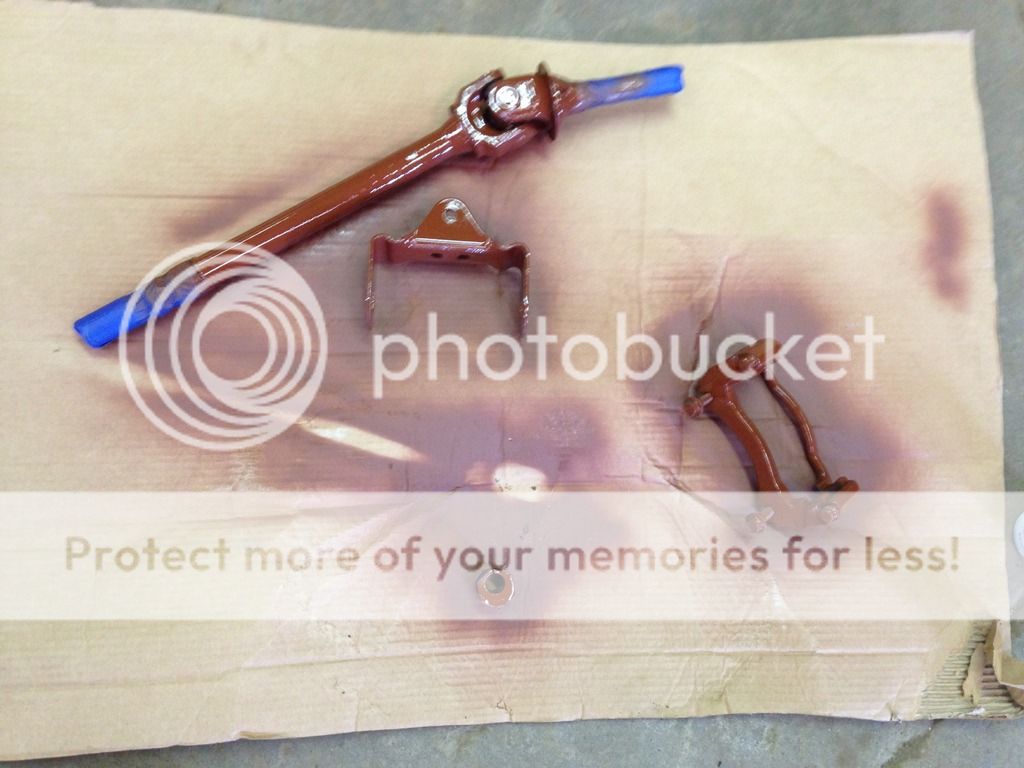

Painting is progressing nicely.
My shafts will go back in ugly.
I want it to look as nice as I can, so I take a little extra time to clean then up and throw some paint on them.

Stupid ABS sensors are out of my life finally :yahoo:

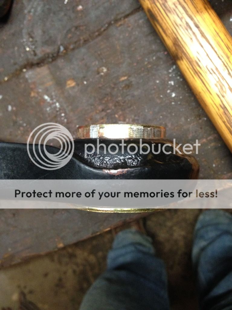

The lower balljoint even had a hole worn in it.

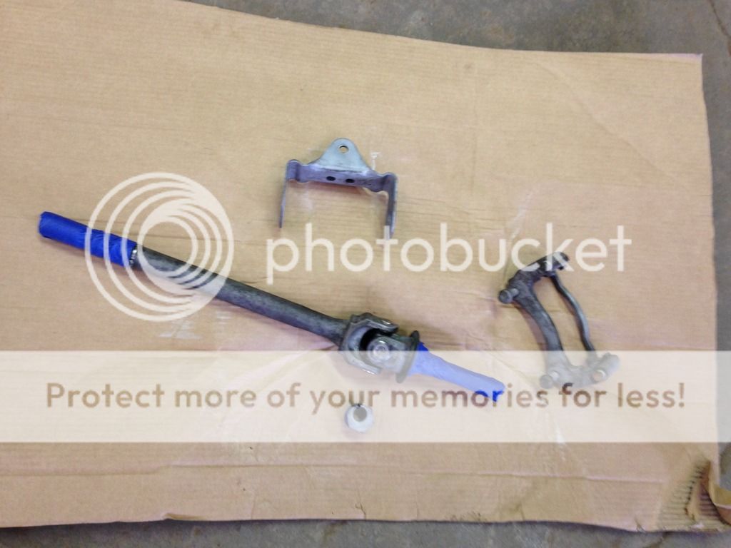

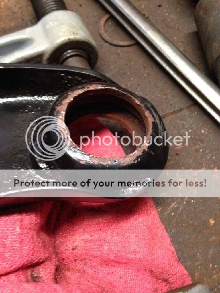

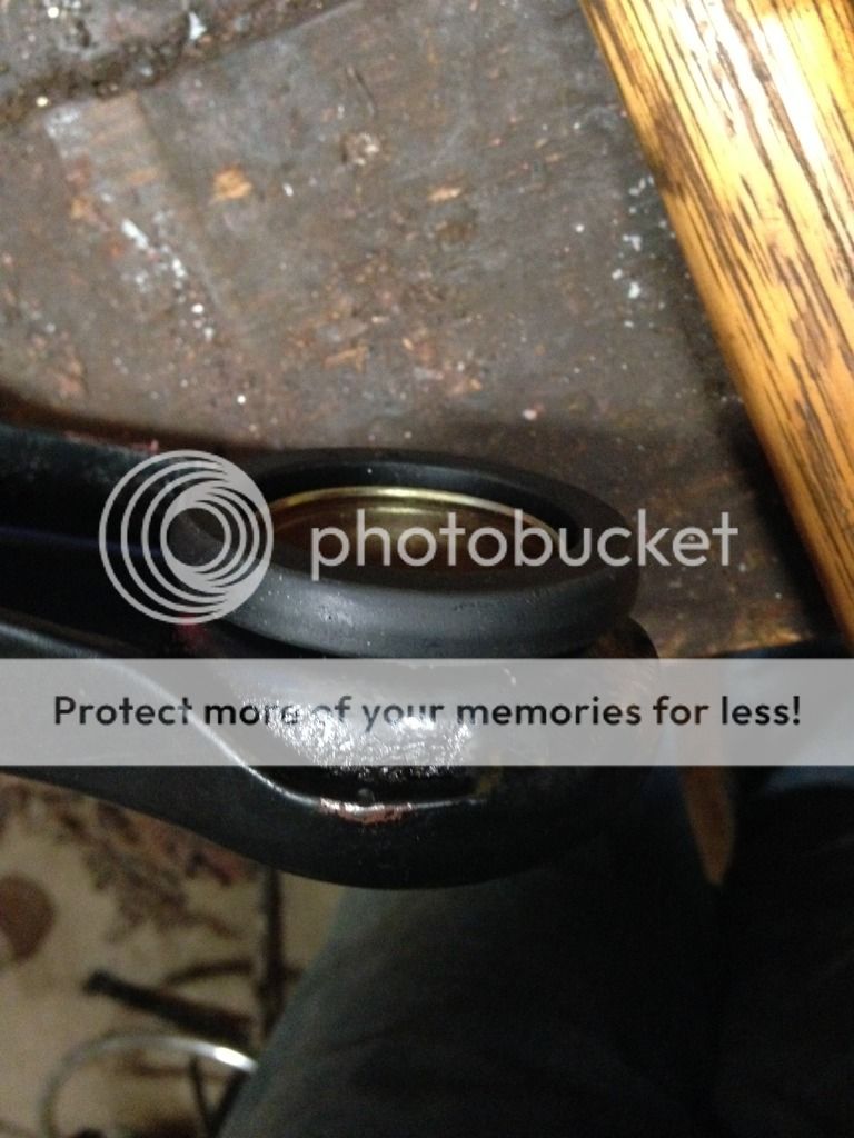

I got the PS pivot bushing out.
I was impressed that the hole for the bushing wasn't solid.
New bushing shell is in.
This stupid washer makes no sense. I have noticed people leave them out.
And the instructions pretty much just plain suck. :temper:
