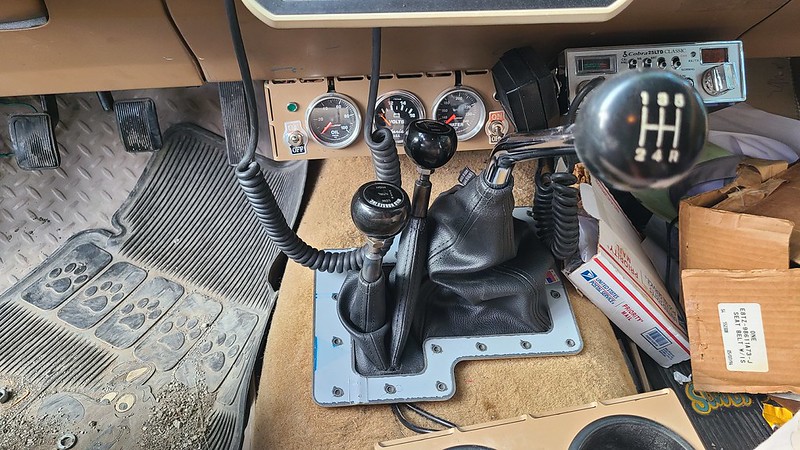

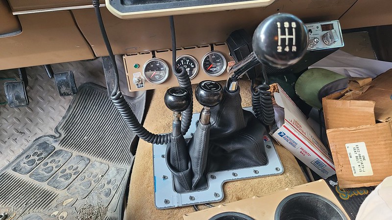

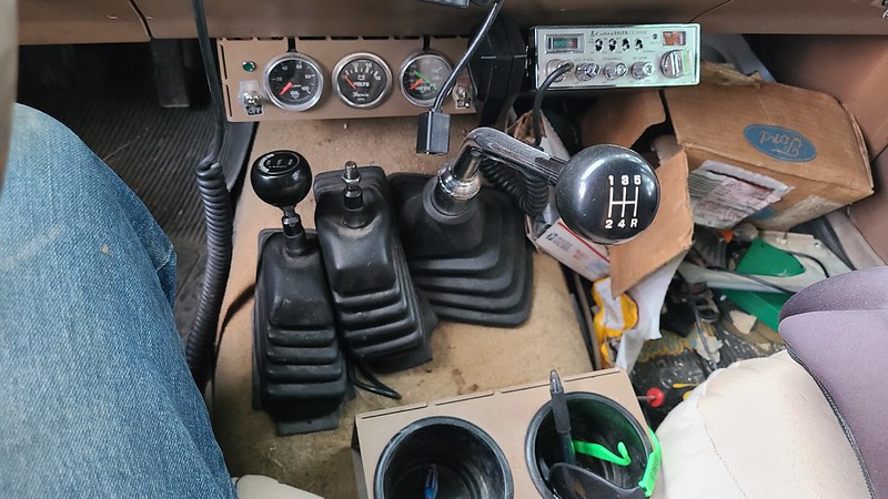

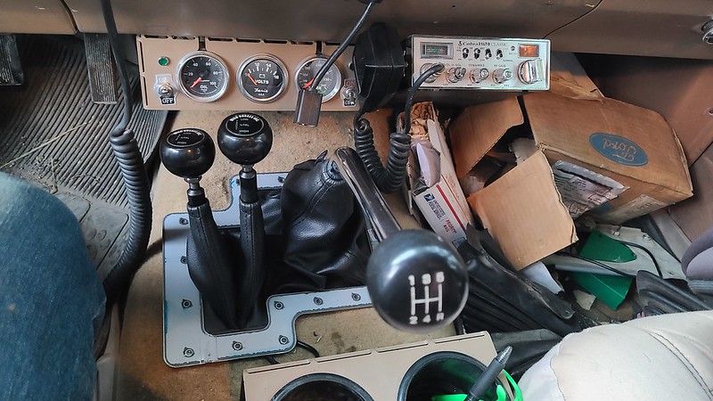

Ever since I did the t-case swap my shifters have looked like this but I already slipped one knob off before I took the pic (ignore the future project storage on the passenger side floorboard)
'85 Ranger Restomod

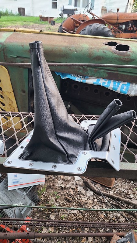

It has botthered me for 5 years. Long runs on gravel and it gets pretty thick with gravel dust, I kinda think they will play a roll in mice intrusion too.
After much searching and searching I found this:
So I snagged one.
'85 Ranger Restomod
'85 Ranger Restomod
I know I am surprised as you are, a first gen Ranger floor profile is not the same as a first gen Bronco so I flattened the bezel.
'85 Ranger Restomod

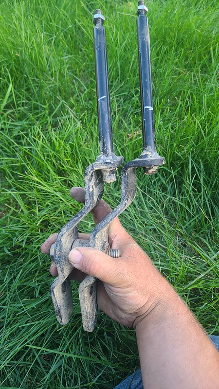

It looks awesome and is so much cleaner looking than the poser shift boots I had... but the 4wd levers are to far apart. The lever for the rear output (RH one) hits the bezel because it is too far from the front output. So I need to bend the levers a little different to fit.
On the fence if I should leave it polished aluminum or if I should rattle can it maybe even with something with texture to it to tone it down (polished will look pretty hotrodish) and to make it look more original. Right now it has a protective film so it looks weird.

Could you just trim the bezel to the left to give it more room for the shifters?
That's got some promise for sure! Looks good
The boot is glued to the bezel, it's probably at least a quarter inch of interference. Bending the left lever will increase legroom too. I was conservative when I built the shifters because the truck wasn't mobile yet and didn't even have an interior in it.

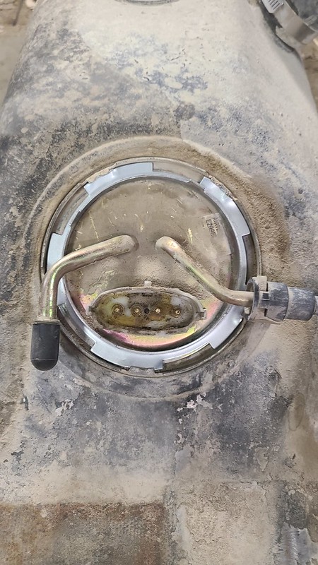

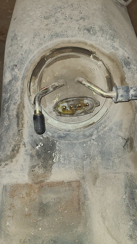

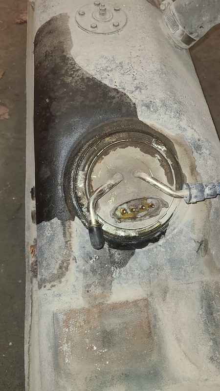

Way back when I put the in tank fuel pump in I had to drop the tank back down because the locking ring shifted and it was leaking fuel.
Well for the first time possibly since the roundup I filled the tank so I could drive it to work a couple weeks ago while my dd was in the bodyshop. I smelled gas very strong. I looked under and the front of the tank was wet. Great. So I ran the tank down as low as I dared and then a bit more and dropped it last night. Sure enough I can see sighns of moisture around the top of the pump.
'85 Ranger Restomod
So I plugged everything up and rolled the tank upside down, sure enough the top of the pump is leaking.
'85 Ranger Restomod

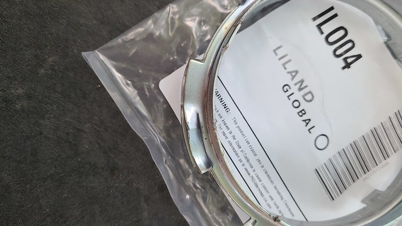

I fought and fought to get the last locking ring to engage, really IMO it is too small but the replacement Dorman one I snagged was identical to the one that came with the pump down to the part number stamped on it. Before opening this can of worms I had a good guess where this goose chase was going to end, I found this one on Rockauto that shows slightly bigger dimensions (for what that is worth) than the other rings. It is in fact slightly larger.
'85 Ranger Restomod
It went on much easier than the last two, hopefully it stays where I put it. Kind of getting annoying, if this keeps up I might start shopping for a fuel cell.

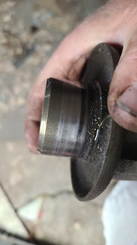

The front output on the t-case has a seep to it. I have never had to add oil to it but it stays wet and slings oil on the floorpan. Not much but just enough to keep things damp. So I ordered a new seal and a speedi sleeve for my 1977 t-case.
Luckily Rockauto has the front seal listed to be the same as the rear so now I have a speedi sleeve and new seal for the rear if they ever go bad. The front is smaller similar to the listing they show for the front of a NP203. No idea if there is like a heavy duty and light duty NP205 variant or what their deal is but I wasn't very impressed. I got it apart before I noticed they sent me the wrong parts of course and it kinda looked like it was coming from the inside of the yoke. They have a goofy star rubber washer in there to seal. So I did a google and guys said to just silicone it so I did that... we will see how it works and go from there. The yoke doesn't really look all the worn and the seal only has TRS trailride miles on it so it should be pretty much new.

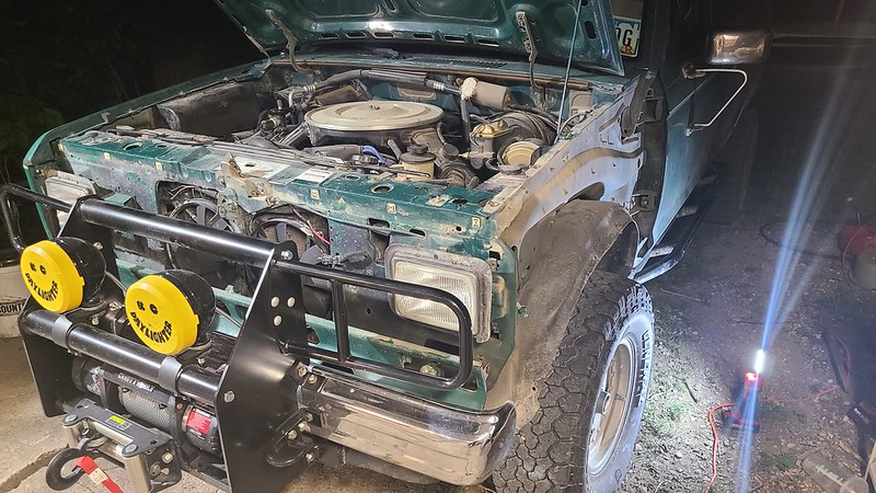

And we learned why we have to keep track of screws when we are working on things...
'85 Ranger Restomod
Also after 24 years of ownership I noticed the front marker lights are marked RH and LH. I don't know that I ever have had both lights out at the same time... but they were backwards. So got them flipped back around. Now the one that got scratched when I buggered the LH fender two weeks before I graduated high school back in '03 while backing it out of a shed is on the good fender... nice.

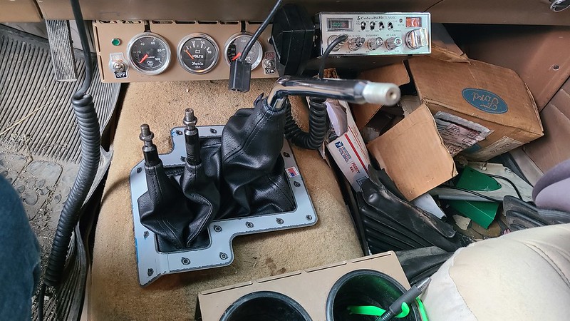

Then to get the shifters to maybe work with the boots I had to do some tweaking.
Before:
'85 Ranger Restomod
After:
'85 Ranger Restomod
Kinda close to the trans shifter base in neutral (all three in neutral)
'85 Ranger Restomod
In high range (all the way back) or low range (all the way ahead) it has miles of room with the trans shifter no matter what gear it is in.
'85 Ranger Restomod
'85 Ranger Restomod
'85 Ranger Restomod
Waiting for paint to dry on the shifters to get them installed for real and get the boot itself dialed in.
This them in the truck before again:
'85 Ranger Restomod
I also canted them about as far as I could to the right. While cruising without using cruise the LH lever was kinda right in my calf. Now it takes effort to even touch it with my leg. Also all the bending effectively shortened them so they are lower compared to the gauge panel in low range.
And that is where we are at so far.

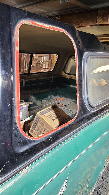

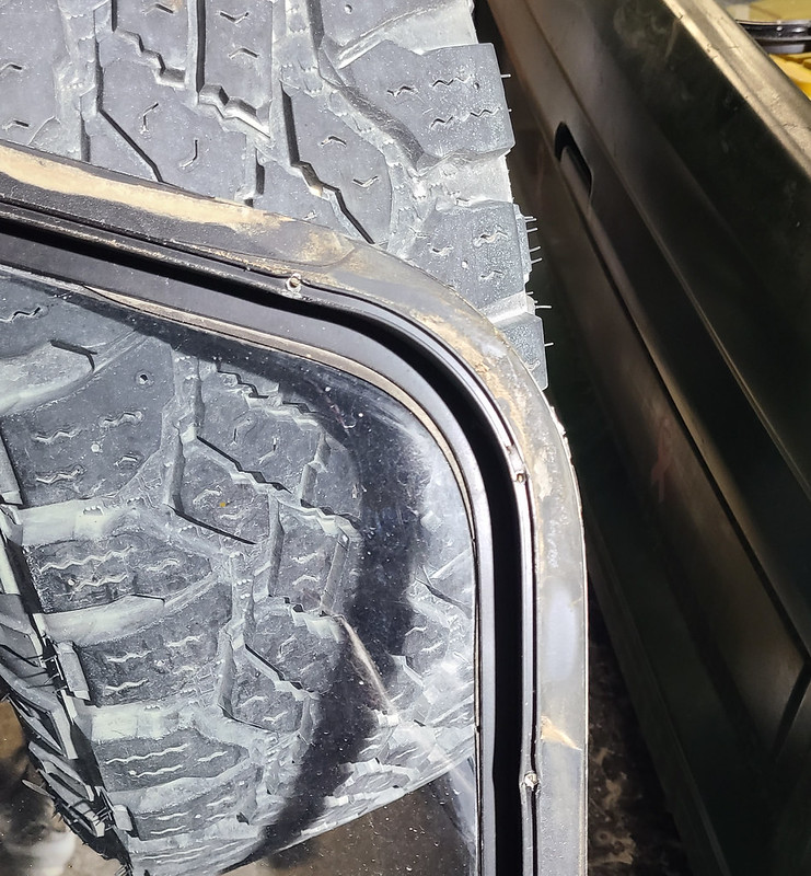

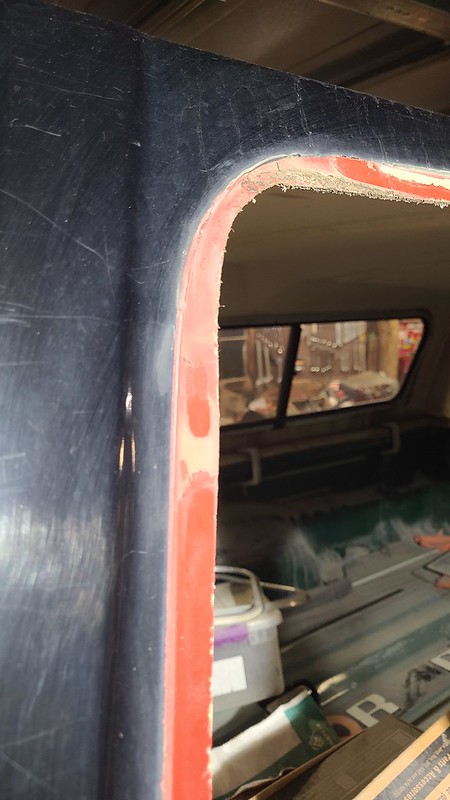

Three out of four of the side windows in my topper leak in rain profusely. Thanks to having the holes in the bed from my rollbar... let it flow. BUT when I swap in the drop in bedliner as part of my sleeping platform it isn't going to drain anymore. And really I ought to fix it anyway.
So tonight I popped out the two smaller rear windows out to see how wide of tape I need.
'85 Ranger Restomod
That window wasn't leaking and took a little work to get the window out. The passenger side window... not so much. I removed the bezel and did nothing to it and this is how sealed the bottom was.
'85 Ranger Restomod
Way easier to remove.
'85 Ranger Restomod
Gee... I wonder why it would ever leak?
'85 Ranger Restomod
Looks like it must have dried out and either fell off or was torn off. Huge gap at the top.
'85 Ranger Restomod
Looks like it will take 1/2" wide tape.
Moving this thing around I had it pictured being like 1/2" thick... only like 3/16"
