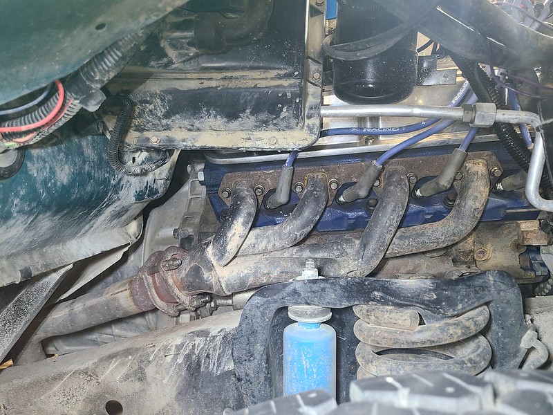

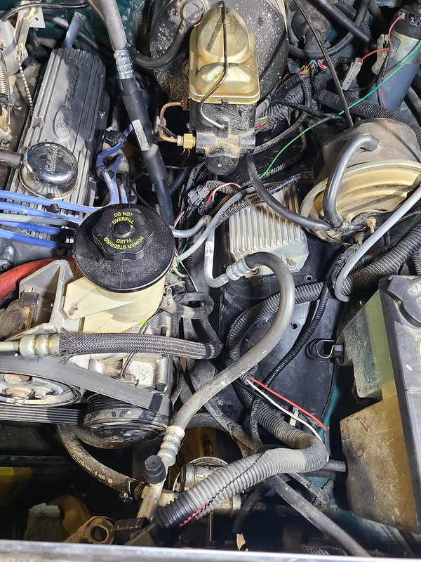

PS header is connected to the exhaust again
'85 Ranger Restomod

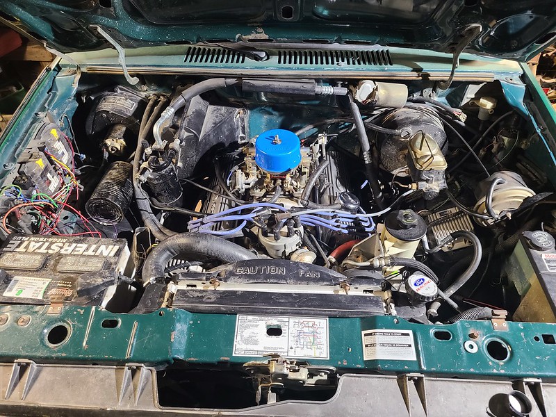

And PS inner fender is back in, and the vacuum canister and intake tube are attached to the top side again.
'85 Ranger Restomod

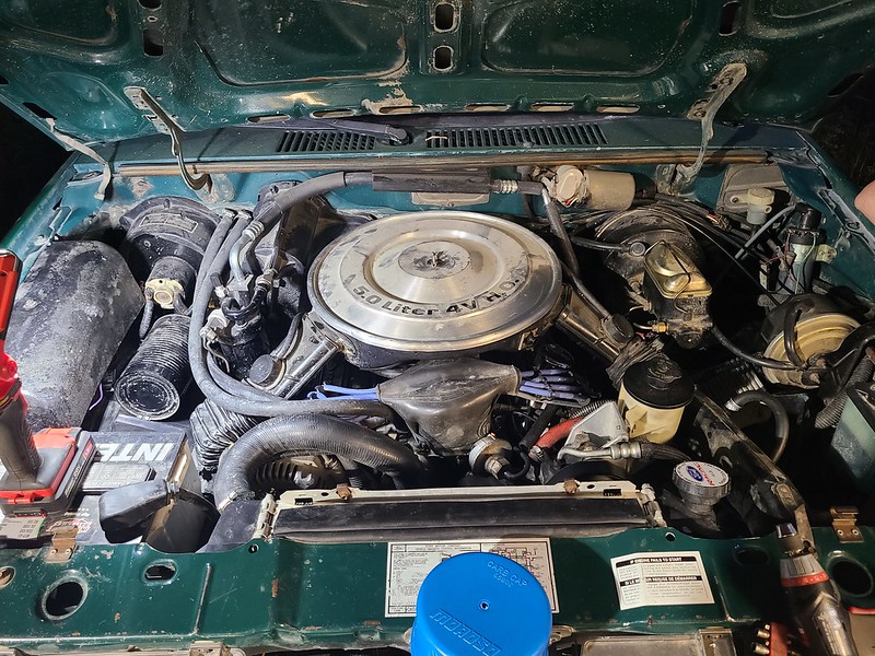

DS header is connected again also, inner fender with the ignition are back in the truck too.
'85 Ranger Restomod
And I set the radiator back its spot too.

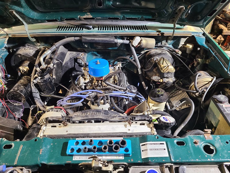

Nothing really for pictures but the steering stub shaft is back in, radiator is back in and coil wire is ran.
Two radiator hose clamps ran off, so I need to snag more of those before I can fill it with coolant.

With a couple good heat cycles on it I figured I would do a bolt check on the valve covers and headers, basically all of them could have used snugged up.
'85 Ranger Restomod
All the intake tubes and whatnot are back on.

Not sure if I just did it better this time or what but two bolts (that I reused last time) on the DS header are too long. The nuts hit the end of the threads and stop. One seemed tight and the other just spun... So I fought it apart to make a dash to town to try to snag two new ones before everybody closed... missed it by half an hour. It was so hilarious, I kinda explained we needed more parts for the truck to my helper, he goes to mom and says "we need more truck parts for our truck and we are sad again" Luckily ran into dad and he had them so we kept going... and maybe not be said anymore?

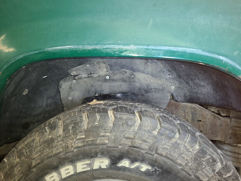

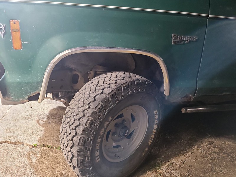

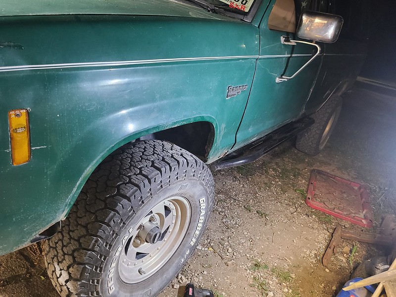

Walked by it today and remembered I hadn't put the front wheel arch trim back on. Looks terrible, you can see my rust.
'85 Ranger Restomod
So I got that put on tonight and viola, a guy gets distracted by the shiny and misses the rust.
