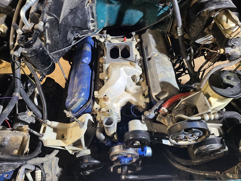

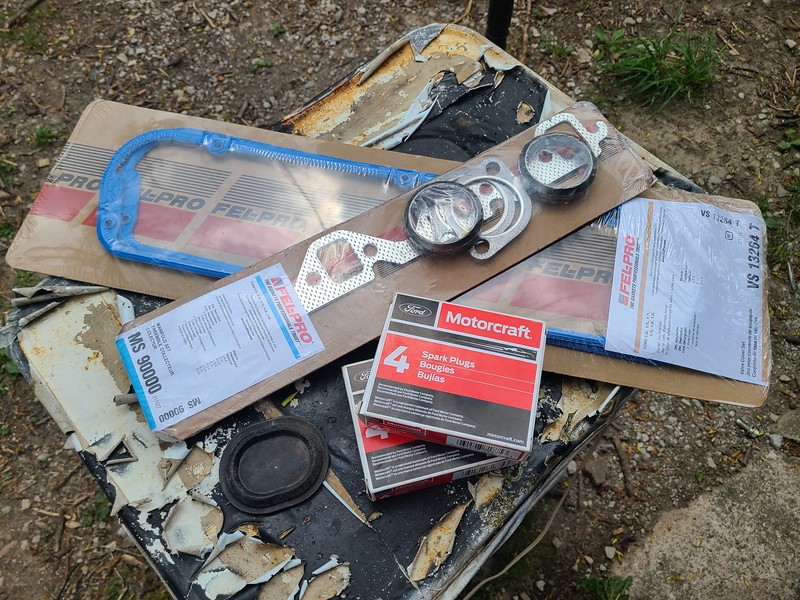

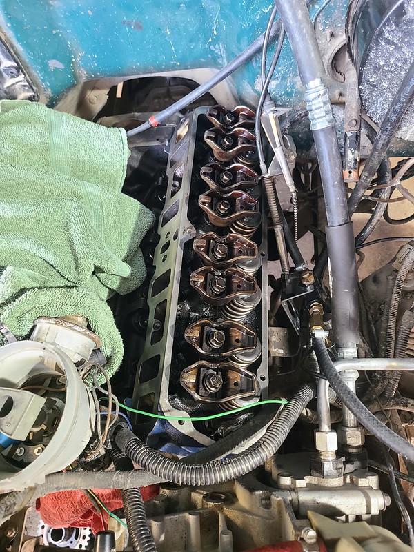

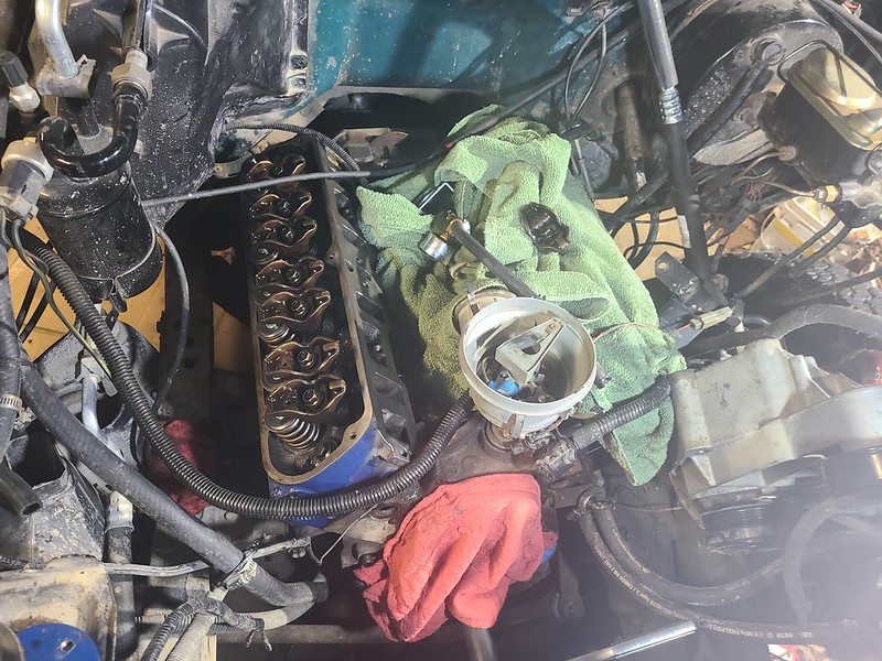

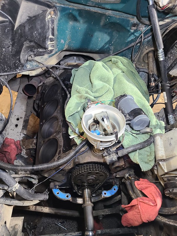

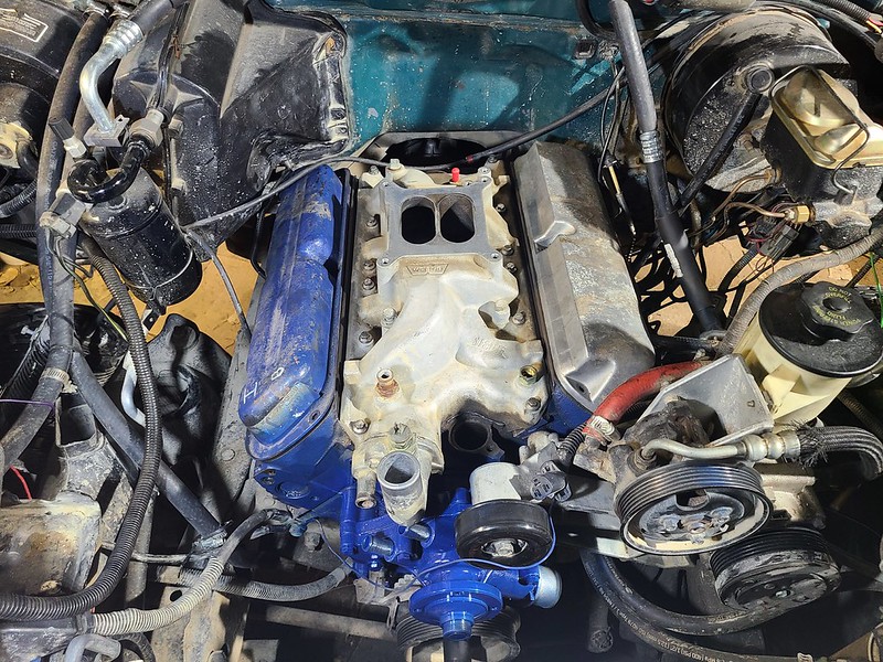

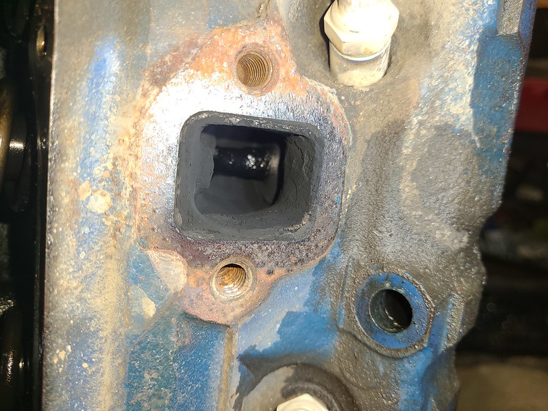

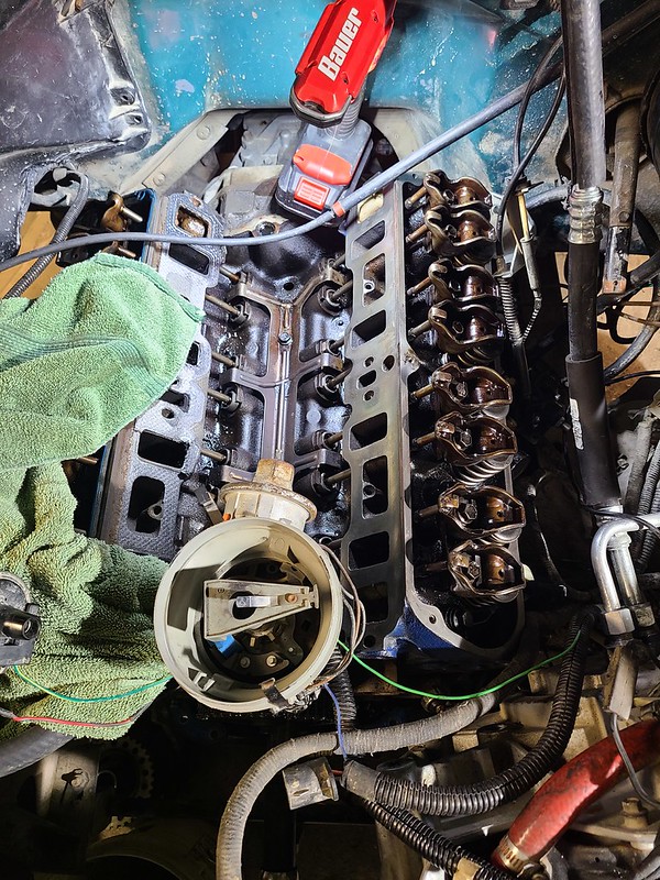

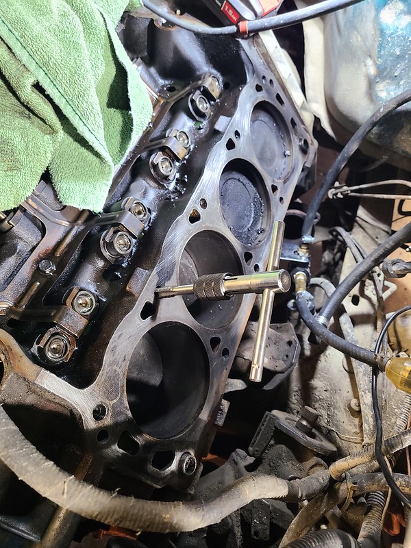

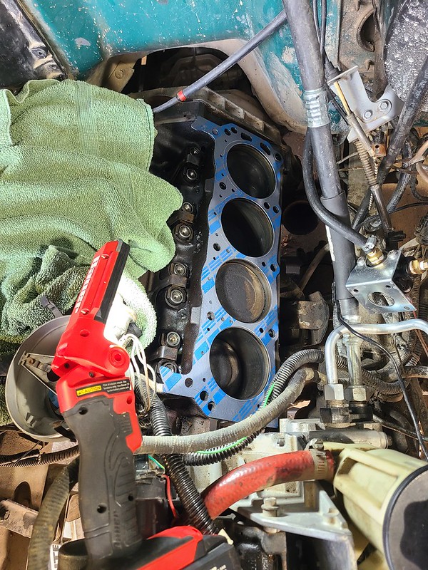

Anyway my head gaskets came in so I got the threads cleaned up in the block:
Block surface is also prepped.

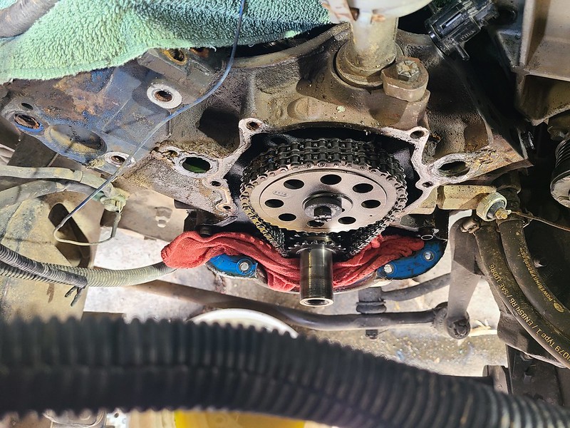

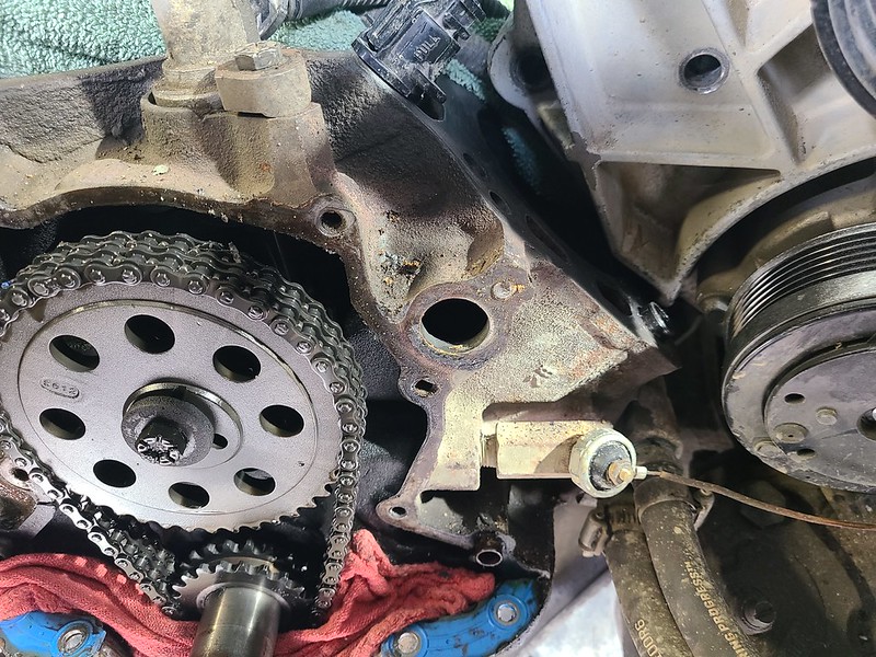

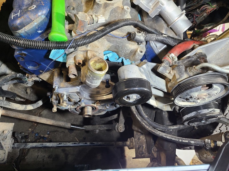

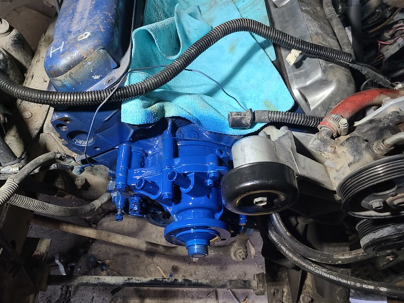

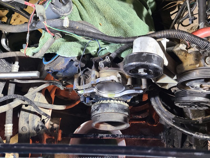

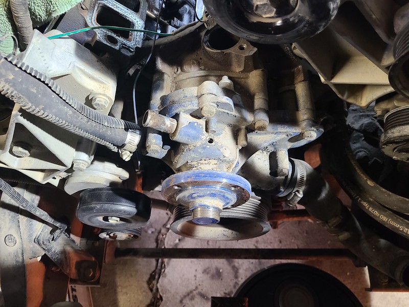

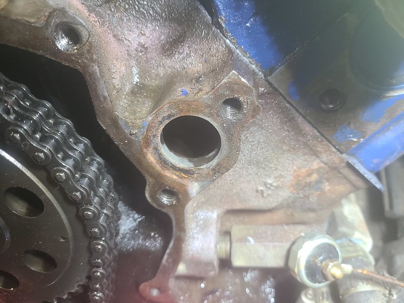

So I decided since without the head on the block the front bracketry can move out of the way more I might as well go ahead and slip the water pump off and prep the timing cover so when I am done with the heads I can just slip it on and be done with it.

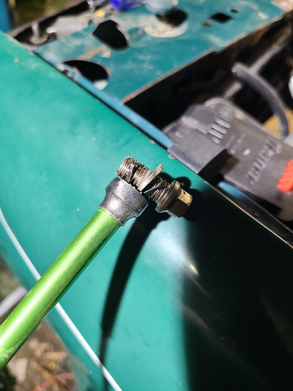

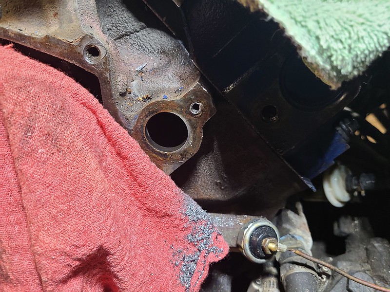

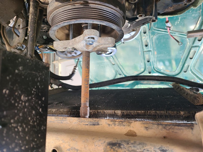

Of course one bolt fought. I tried working it back and forth, I tried putting penetraiting oil in every seam I could to help it... it didn't make it. Looks like it broke off flush with the block. So now I gotta pull the timing cover which is spectacular. Hopefully I don't screw up the oil pan gasket too much so I don't have to redo that too.
Kinda crazy it wasn't that old, 11 years. No idea on miles, I would guess around 5-10k really. Coolant has never been flushed but gets rotated at least somewhat about every year. Drain some out to do something and refill with new.
