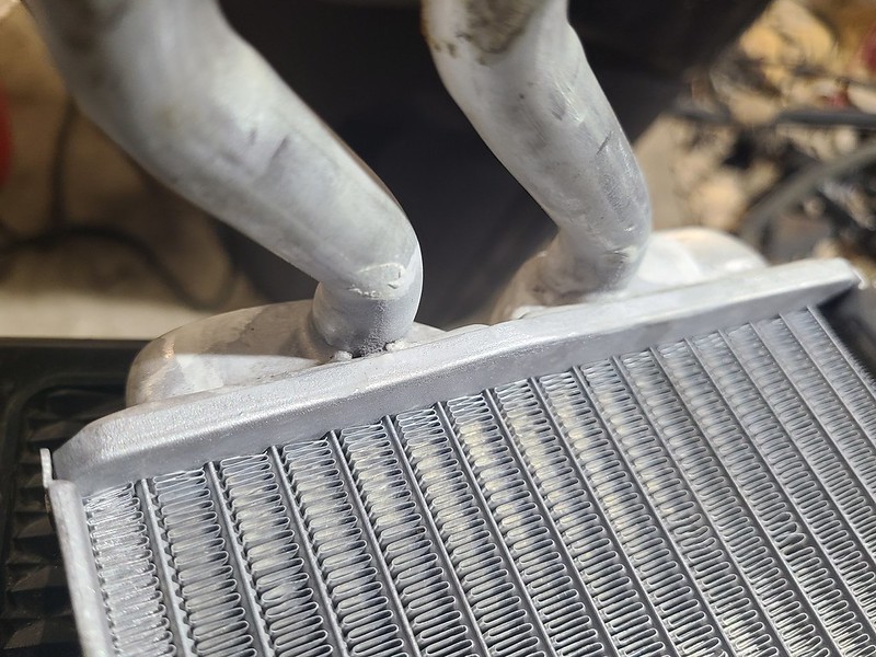

Then the stinking heater core. When I put my GMRS in I noticed the carpet was really wet. So I snug up the heater hose clamps and drive it a bait, still doing it. Running down the firewall. So pull the cover off the bottom of the core after driving it, core is dry. Figure it must still be leaking at the clamps so I replace those, still leaks while the core itself stays dry. Really not wanting to throw a core in it because they are now $50. End up throwing a core in it, can't help but wonder if this was my problem. If it would leak out and hit the firewall and just run down the firewall.

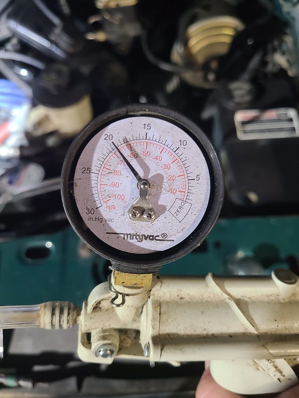

Ok, making headway now... but wait the stupid cruise starts surging again! It hasn't done this in years! I almost threw the towel in as this was happening during the heater core debacle and with the deadline approaching I seem to be losing ground. Resealed the barb into the intake manifold to no avail. Deleted the barb and plugged into the carb port with no improvement. Eventually pulled the hose off the servo and stuck it back on and it has worked perfect since...

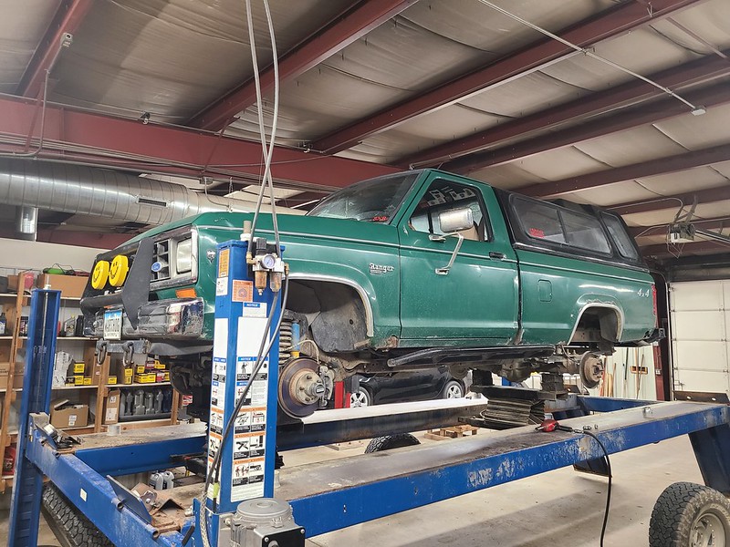

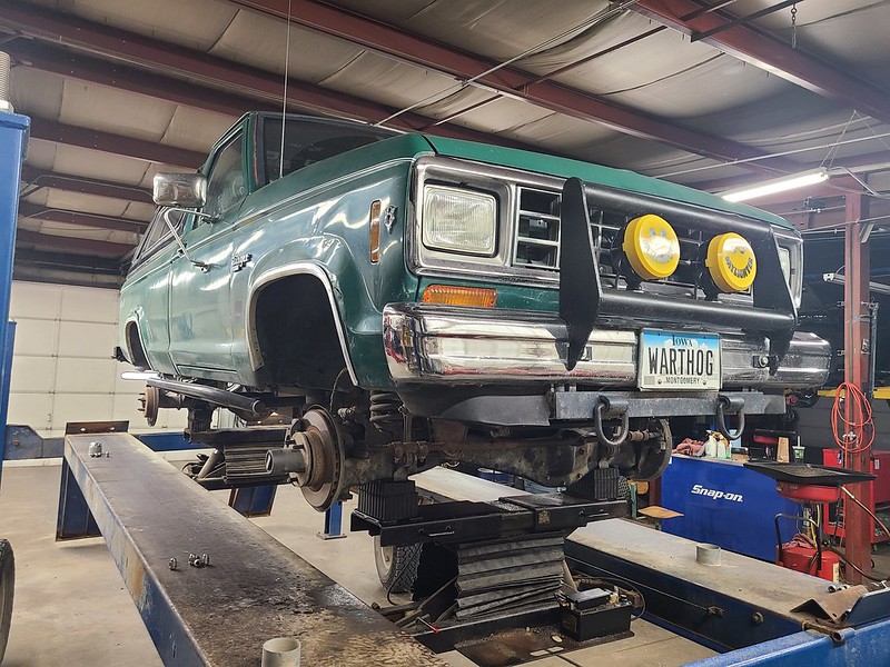

Ok, progress is being made, saturday before the trail ride I ask and am told to text before I leave the house and my boss will turn on the A/C in the shop for me to rotate tires. So rotate tires I did.

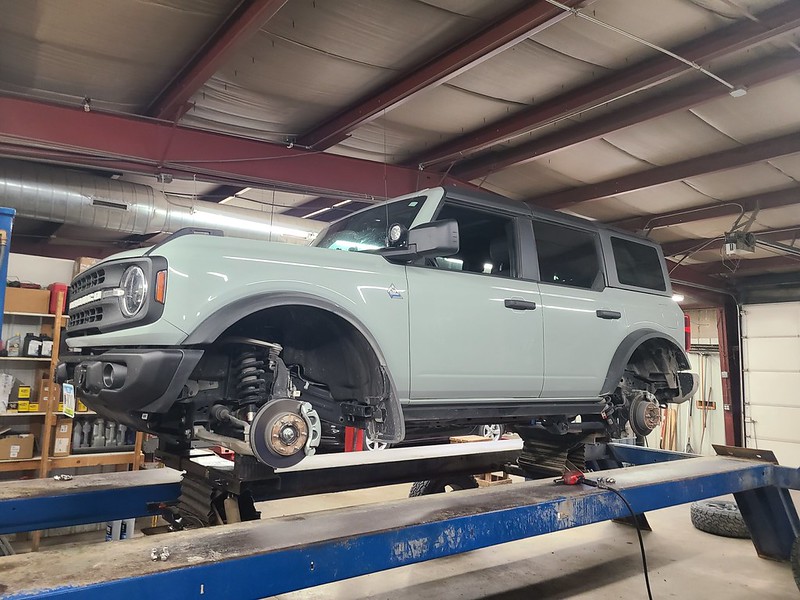

Did my wife's car too.

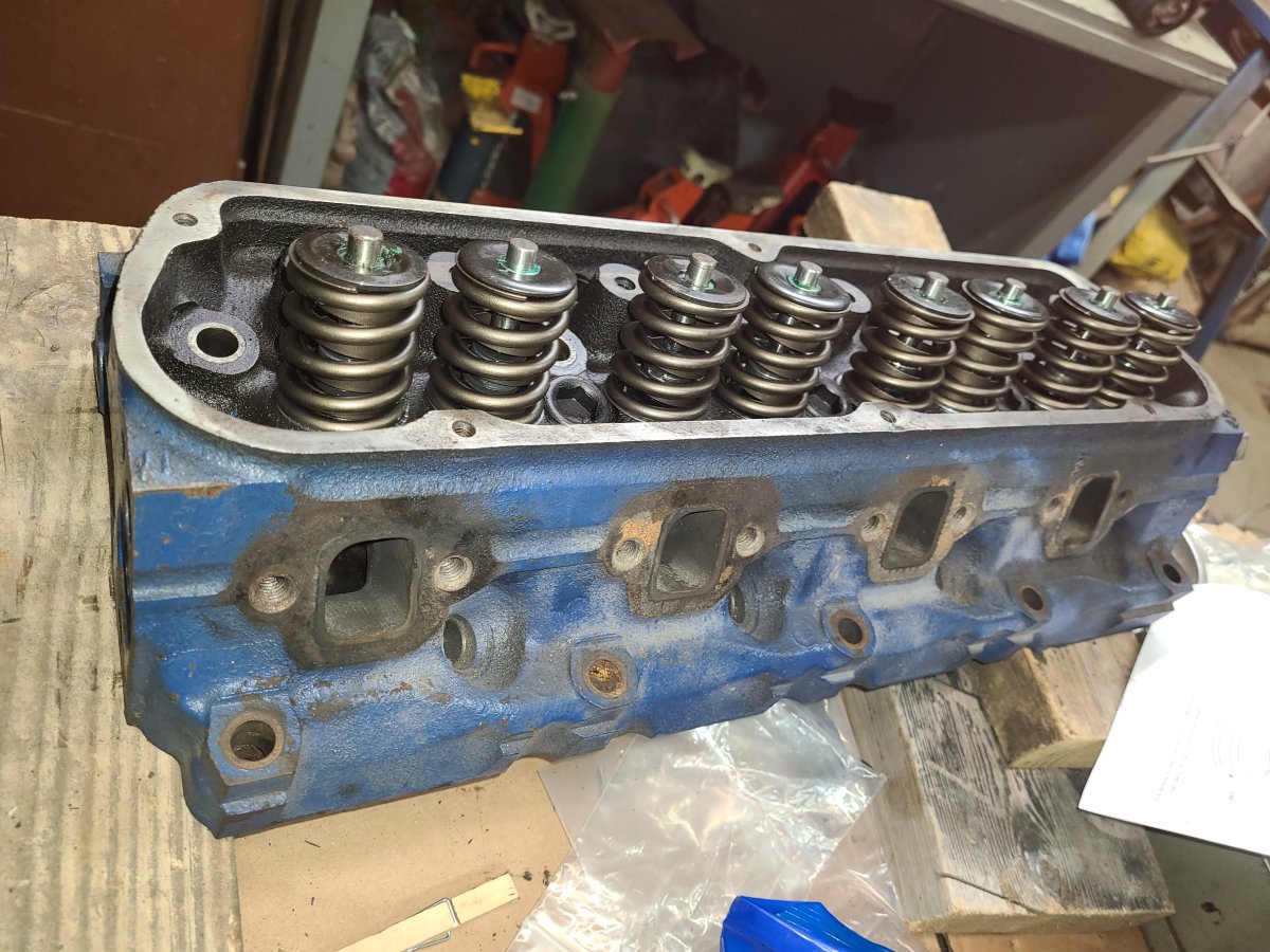

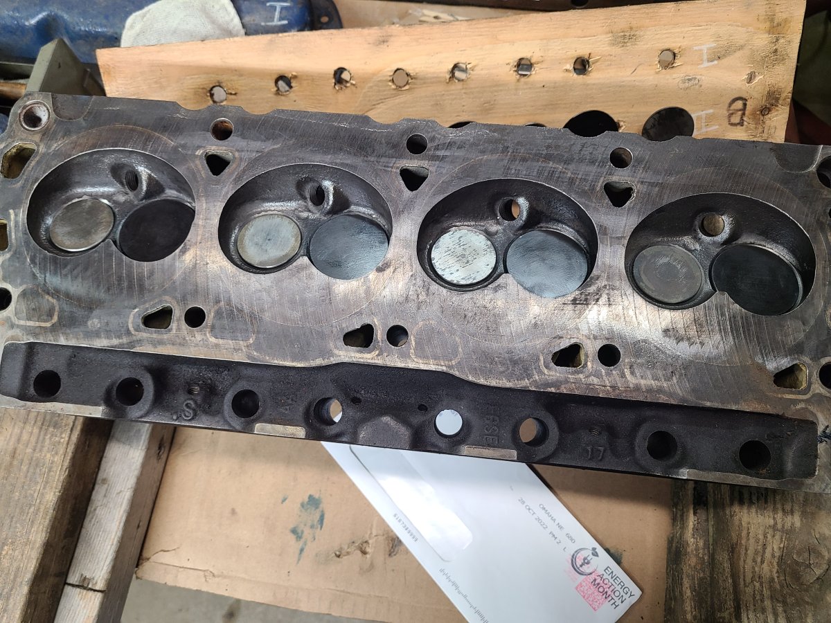

Actually worked on the ranger today, and yes for real this time @Jim Oaks
Seats are touched up, valves are lapped and ready for springage.
One done, one to go.
