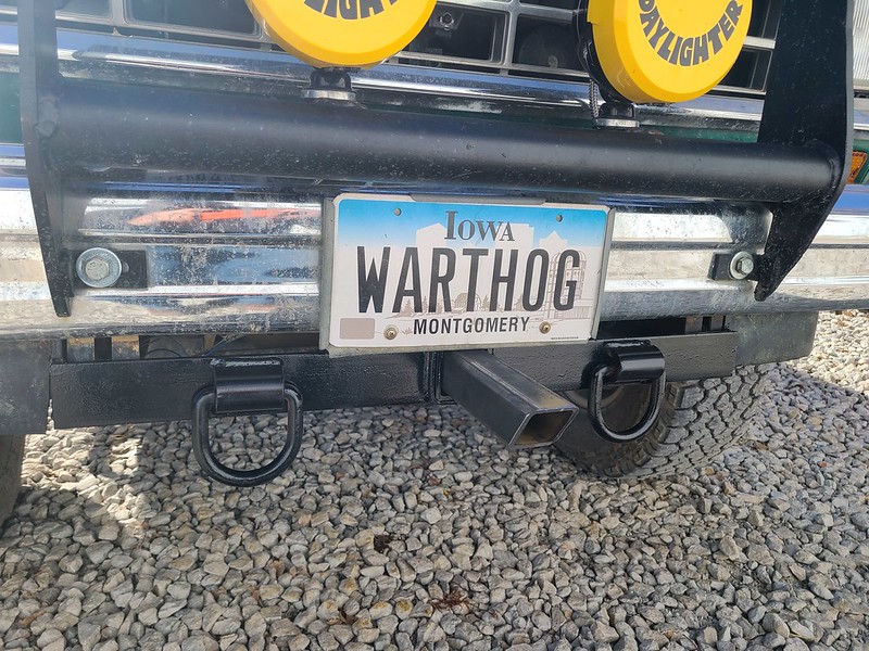

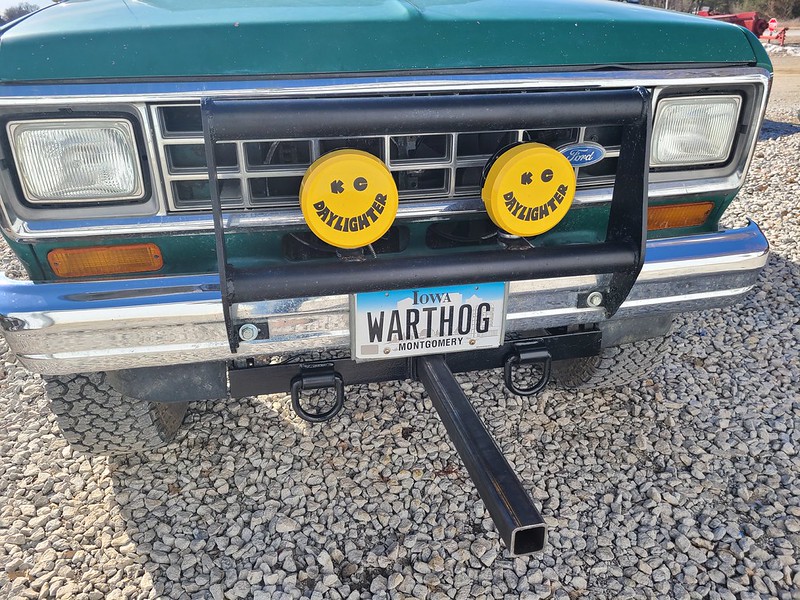

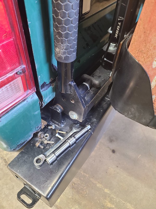

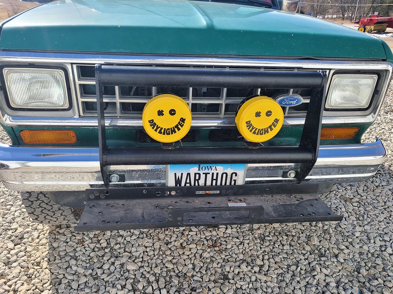

What you have done on the front receiver looks good. Are you going to go with angle again for the brace or tube stock?
The boy making you move the draw bar was hilarious. I want a video when you hook a trailer up to the front for parking purposes or whatever. He's going to be up on you like a spider monkey!
Not tube.
I dug the angle I had found out of the back of the iron pile and it isn't near heavy enough, I don't know if it is even 1/8".
I might just get a chunk of bar stock if I have to get something so it isn't more stuff hanging out the bottom of the truck.

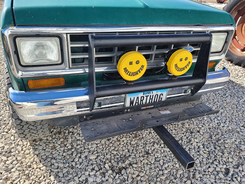

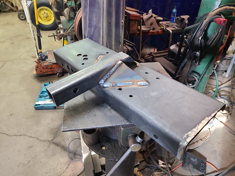

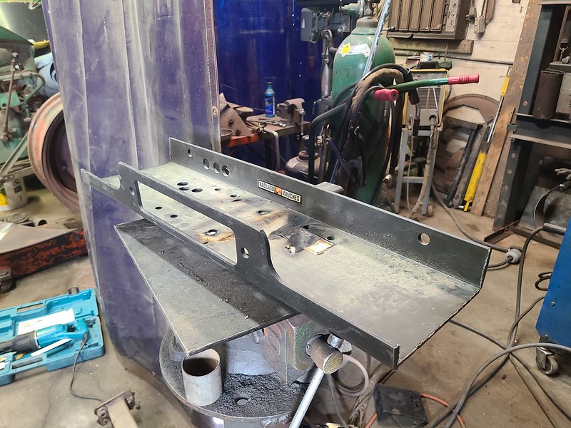

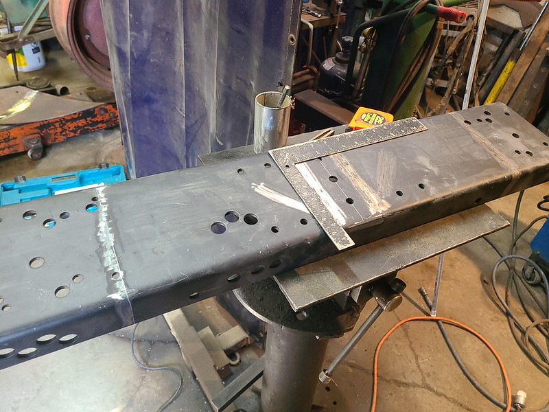

Anyway today I started out with "The pedestrian right-of-way discourager 2000"
'85 Ranger Restomod
Just add plate:
'85 Ranger Restomod

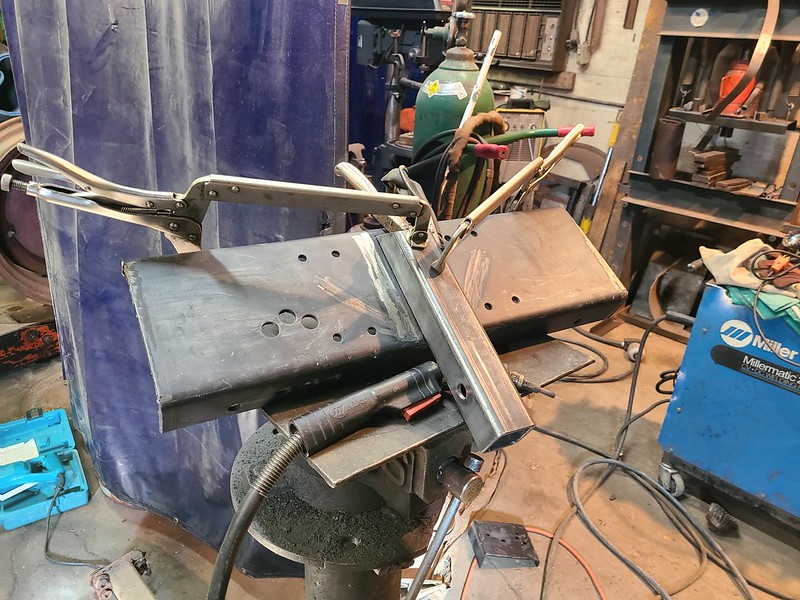

Trimmed the tube...
'85 Ranger Restomod
'85 Ranger Restomod
Trim for width
'85 Ranger Restomod

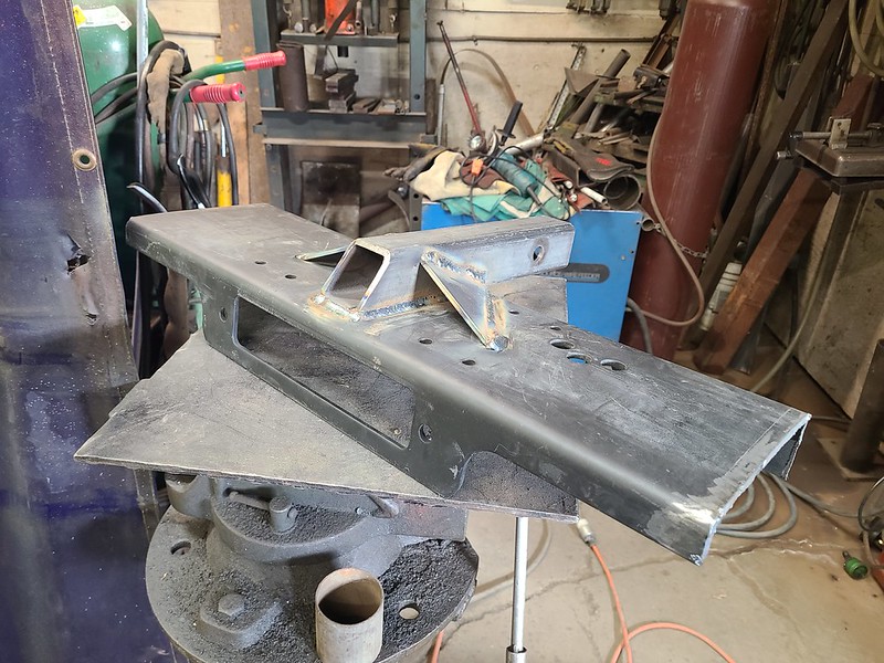

Time to start sticking stuff together for real.
'85 Ranger Restomod
'85 Ranger Restomod
'85 Ranger Restomod
'85 Ranger Restomod
And thats as far as I got. I need to clean it up a little, strip the crappy paint and paint it yet.
Looks like a good place for Oliver to stand while he's adjusting the carb.

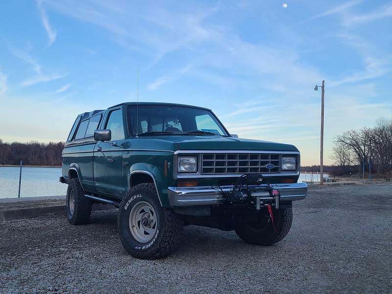

I have thought I could stick one of those hitch carrier things up there if I wanted to... but he is adamant I need a winch.
Getting close to official...
'85 Ranger Restomod
'85 Ranger Restomod

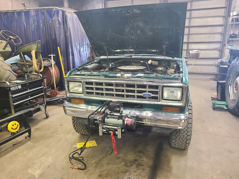

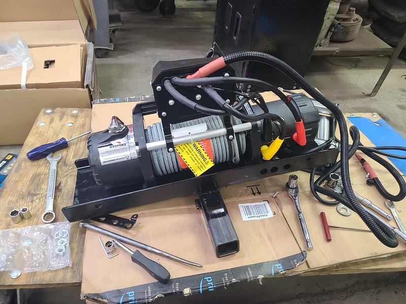

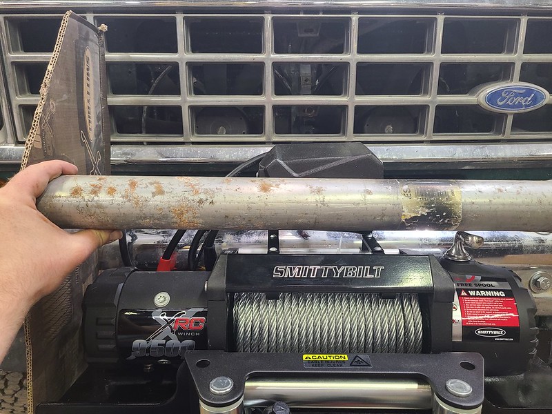

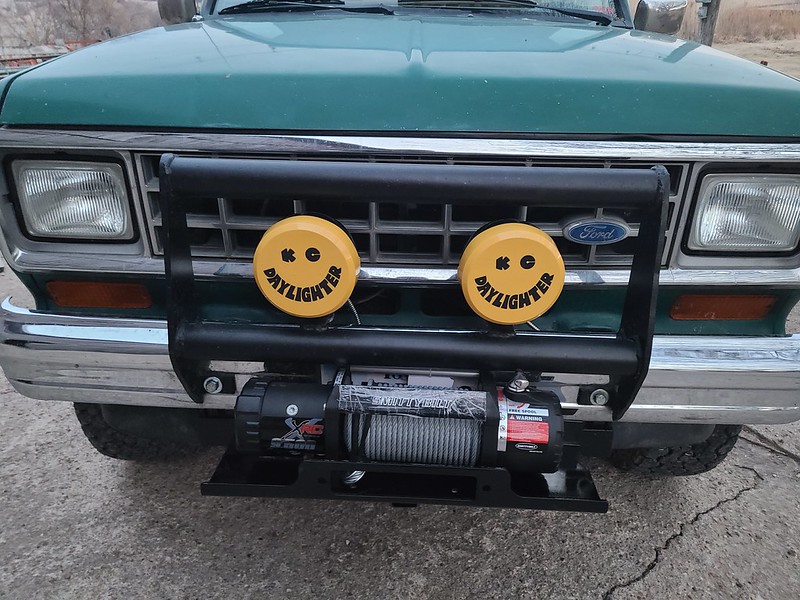

Just set the winch in there for giggles.
'85 Ranger Restomod
'85 Ranger Restomod

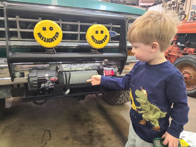

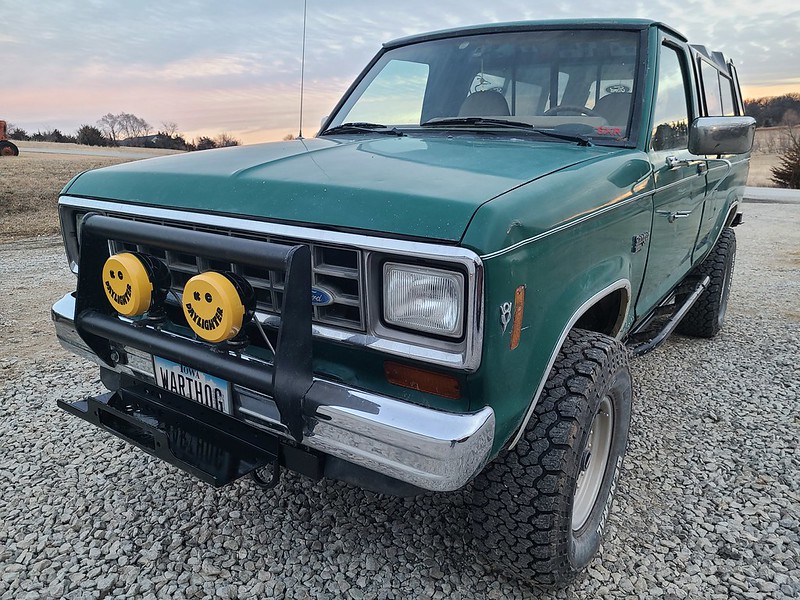

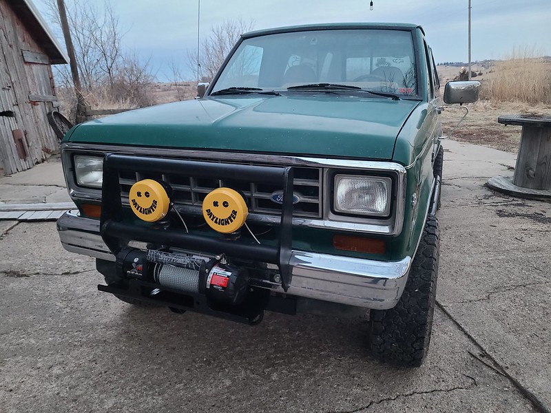

Not functional with my current grille guard, the clutch lever has to be unlocked for it to sit there. I can't get it to the locked position, it turns 90* and hits the bottom tube of my grille guard.
I am thinking I might try to mount it anyway this weekend. I can still use it to mock up my final grille guard.

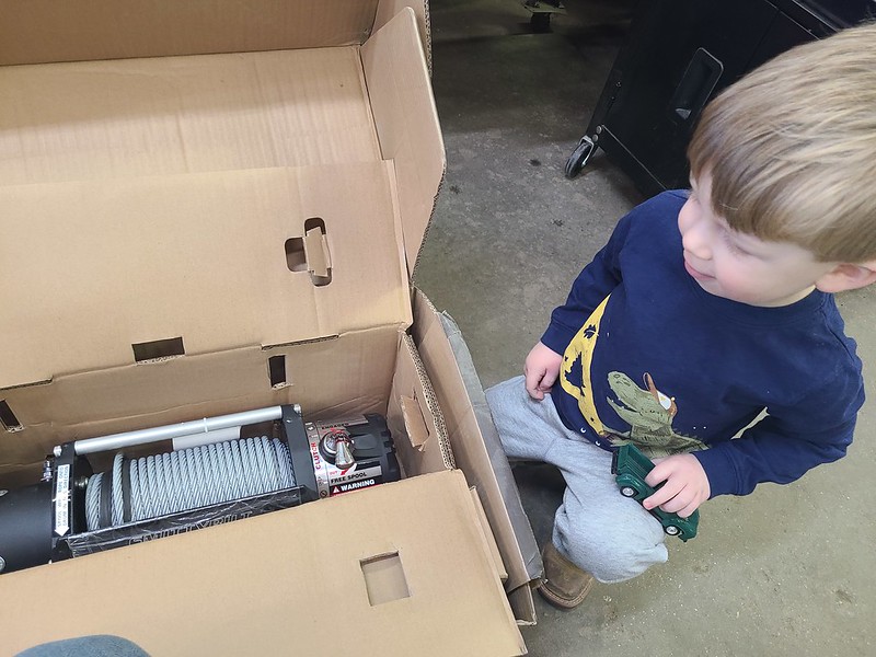

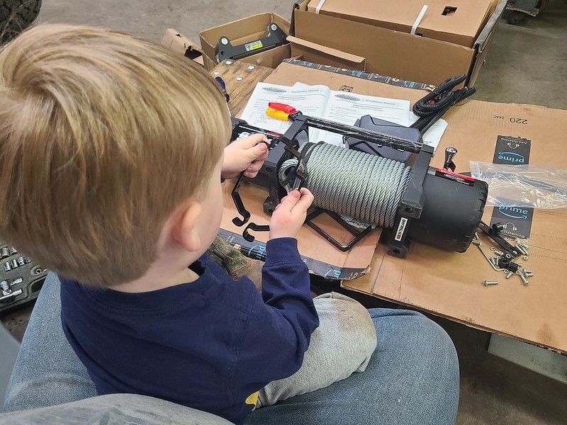

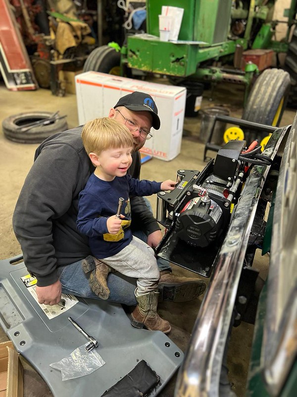

Little guy has been bonkers about me needing a winch. Possibly too much Matts Offroad Recovery at night... Anyway it has been in the barn for two years so I don't know if he really knew I even had one.

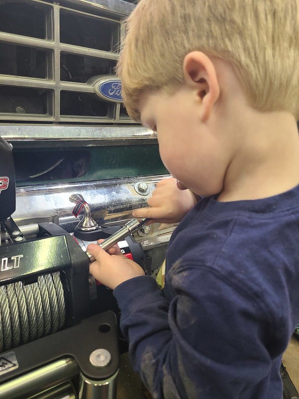

So today I loaded him up and took us to dad's shop to put the winch on it for his first project.
'85 Ranger Restomod
Pretty excited about this!
'85 Ranger Restomod
Test fit.
'85 Ranger Restomod
Got the book out, I see there is wiring on the bottom of the motor so I can't just add it later. So I might as well put the wiring on it when I put it in. Which means mounting the controller which is just as well because it is going to have to go on the top and that would be nice to have mounted while I do mock up. Which of course means me current grille guard has got to go too.

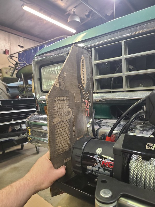

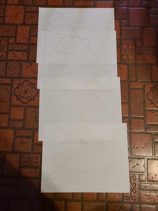

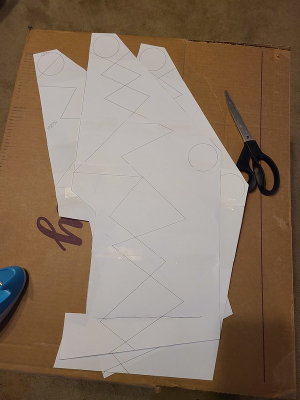

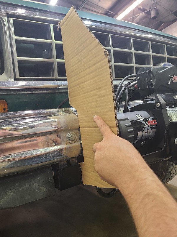

With little fingers gone time to break out the boxcutter and do some cardboard aided designing.
'85 Ranger Restomod
It will go higher, easy to set that after the bottom gets dialed in.
'85 Ranger Restomod
Grabbed a chunk of exhaust pipe from the scrap bin to see how things will clear. It has to be ahead of the control box (check) and above the clutch lever (check)
'85 Ranger Restomod
'85 Ranger Restomod
'85 Ranger Restomod
Fired up my rapid prototype machine:
'85 Ranger Restomod
It did take a couple tries to get dialed in, mainly how it fit around the bumper.
'85 Ranger Restomod
So now onto the lower tube placement, I want to get it as low, and rearward as I can...

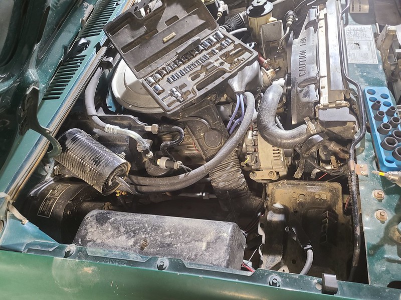

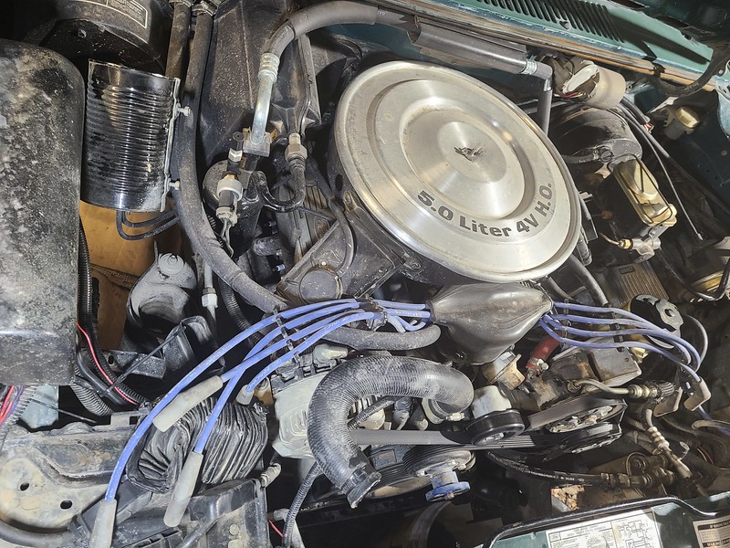

Yanked the battery and inner fender.
'85 Ranger Restomod

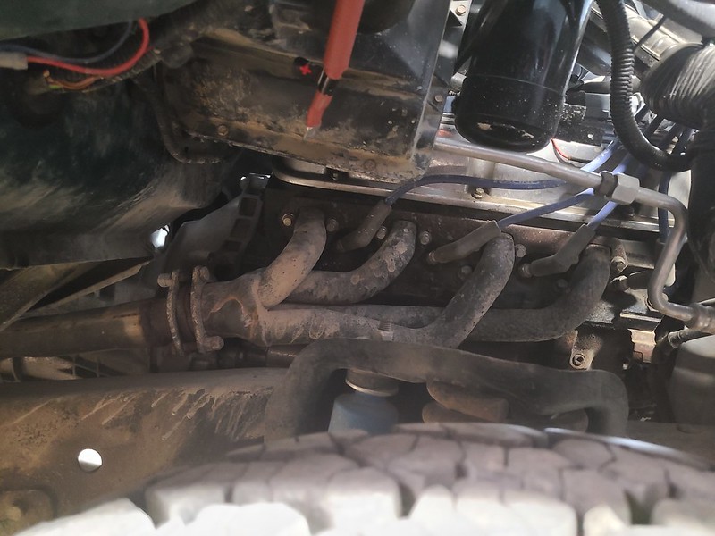

Which gives me beautiful access to remove the PS header.
'85 Ranger Restomod

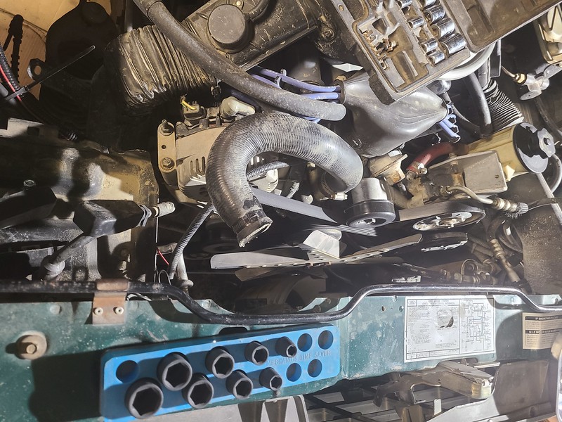

Then out comes the radiator and shroud
'85 Ranger Restomod
And fan.
'85 Ranger Restomod
Tomorrow I am hoping to get the other inner fender out and start picking on the top of the engine. Carb, coil, dizzy, alternator, maybe intake depending on how things go. DS has the dipstick interwoven in a manifold never intended to have a dipstick in the block and PS has A/C which I forsee being my two biggest snags.
Yes, the great E6 head swap is happening for real. Really hopes it comes out a gain with oil burn and maybe a bump in low end power. With the touched up valves maybe a bump everywhere I dunno.
For those just tuning in it does go thru more oil than I like on our road trips but it only really ever smokes when I downshift, some hot starts and when it is left to idle for longer periods of time. Screams valve seals. But the valve seals were new in 2012 and only have a couple thousand miles on them, they shouldn't be wore out... unless the guides are wore out. I don't remember if/how I checked them before I put the heads on. So I went thru the E6 heads that are original to this engine, touched up the valves and seats, trick flow head set (new springs and valve seals) and checked the guides for wear. Everything came out good.
