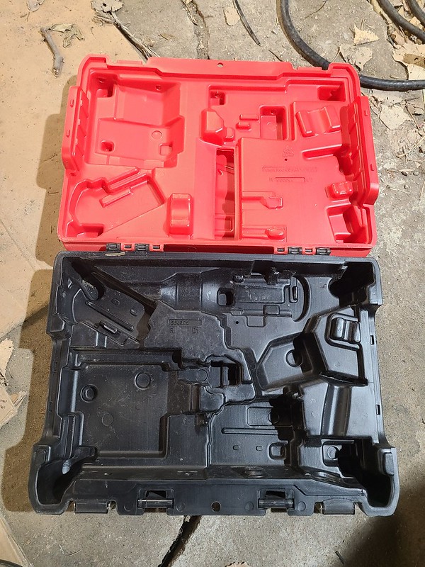

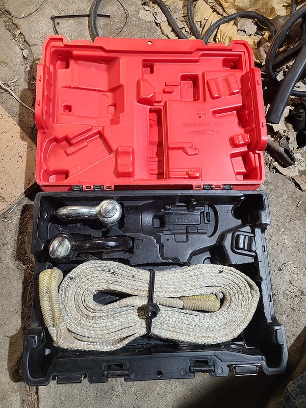

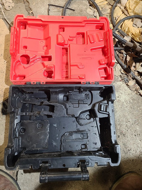

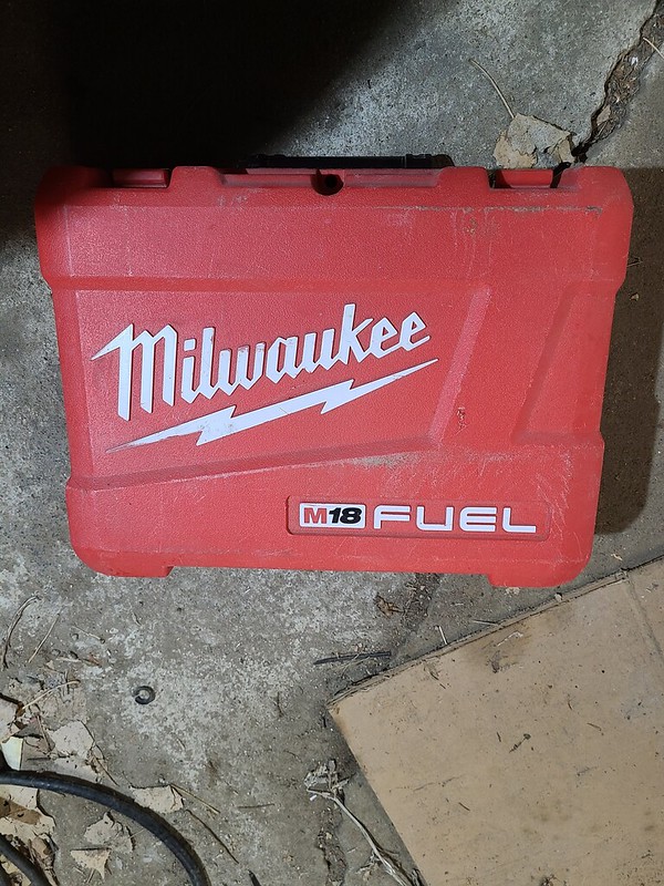

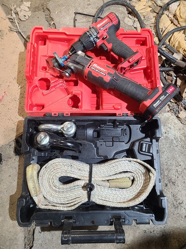

And then today my wife found this Milwaukee case when she took the recycling in.
'85 Ranger Restomod
I have been thinking about a way to get my recovery gear organised so it is nice and neat and not just strung all over the rear floor of my truck. And bingo, I think I have it...
'85 Ranger Restomod
'85 Ranger Restomod
'85 Ranger Restomod
So Milwaukee and Bauer came together to make this recovery gear case. It might have room for a snatch block, not super positive though.

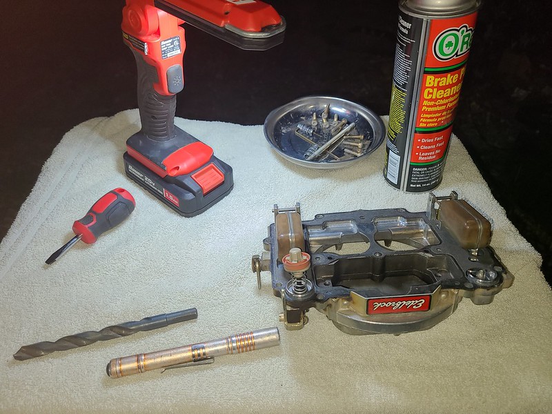

Pump really wanted to run 7psi so I stuck a Summit Holley knockoff regulator on it a few days ago and knocked it down to just under Edelbrock's spec. Also popped a new set of needles in it while I had it apart. I read that too high of pressure can screw with the viton coating on needles where they seat and cause them to leak. Possible hot start cause?

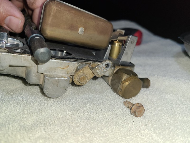

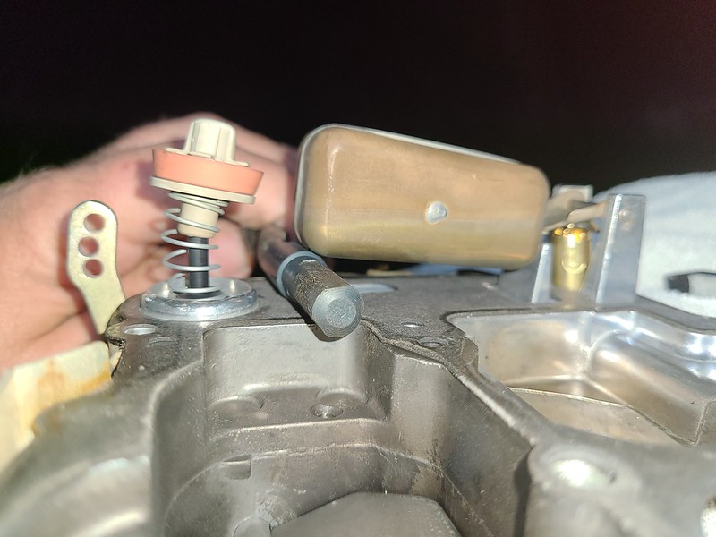

I did more digging into adjusting floats since I would be messing with them and found this video:
Then we operate.
'85 Ranger Restomod
Float top end was way high, no wonder it hot started so weird. Supposed to be 7/16" right at the edge of the curve of the top edge of the float.

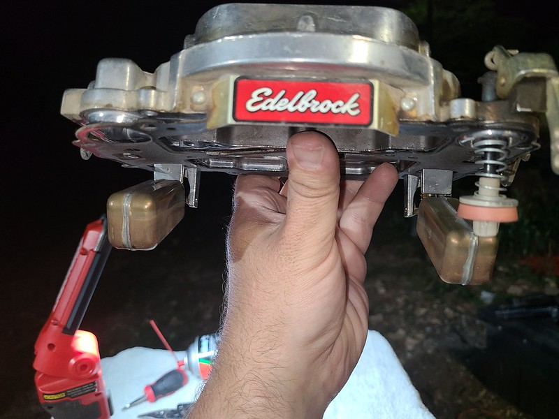

Ok, got those adjusted. Now onto the drop. Spec is 15/16", mine were like 1-3/8"
Left is adjusted, right is how they both were when I started.
'85 Ranger Restomod

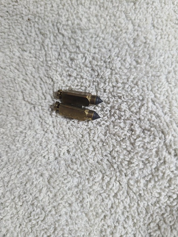

Needles were not horrible, since they are a special order thing I threw them in my tuning kit just in case I get in a bind down the road.

Cranked it up, ran fine. Got in the highway and let her have her head. Just smooth, no flat spot it just freaking runs like a striped ape. Revs really snappy, generally runs better than it ever has.

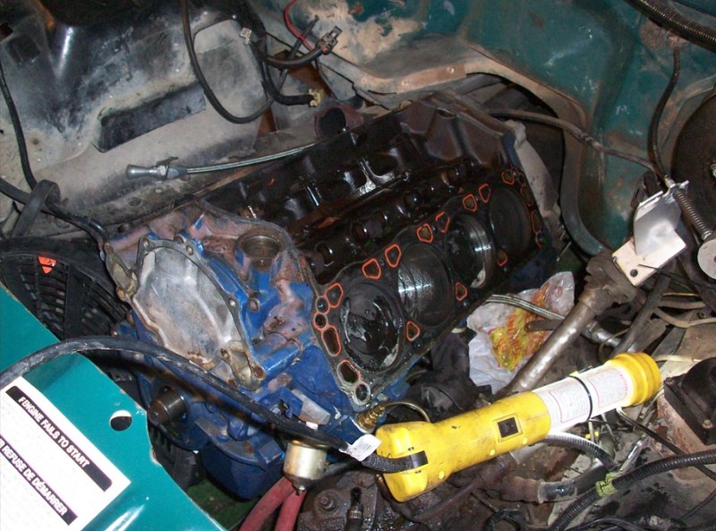

Had a pretty productive holiday weekend...
'85 Ranger Restomod
Good greif, took ‘er down to the short block! Time for different heads?
Gonna get rid of that occasional little puff of smoke?
