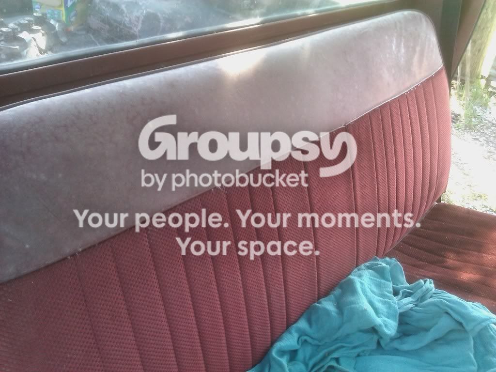

after getting her home i went to work immediately....
the interior had to go
