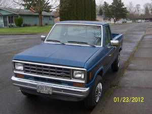

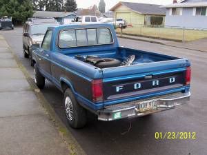

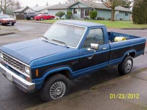

'84 Little blue Ranger in Oregon - Mild off-road project

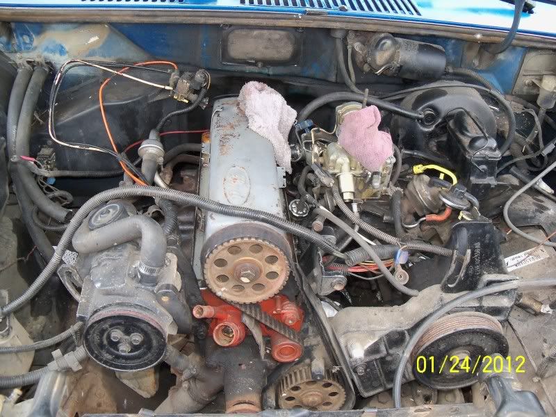

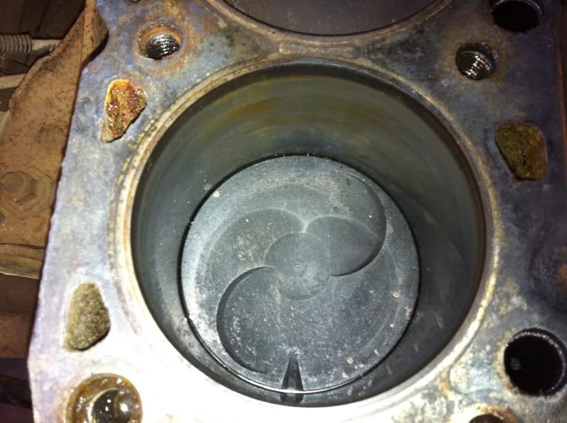

very clean =) nice engine btw
Thank you! I intend to make it a nice, clean looking engine bay.

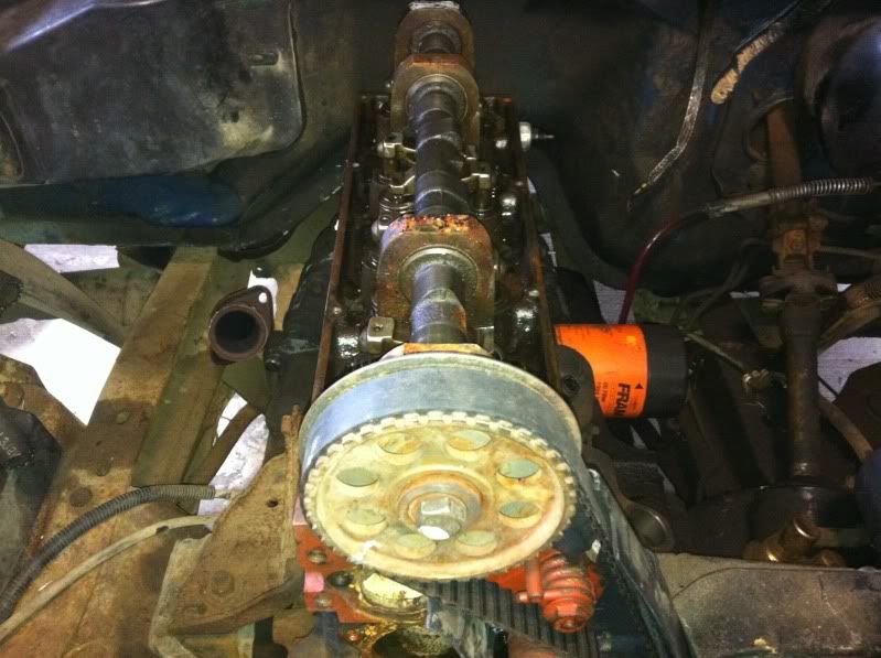

looks like fun. looking at the pics of the motor reminded me that i learned how to rebuild a motor with a 2.3L. good luck with the build.
Thanks, I’m looking forward to starting everything for sure. I definitely love how simple and well designed these engines seems to be. Simple inline engines are my favorite!
Haha, yeah maybe eventually if I can find some deals on good parts… I don’t have the money for that right now though. I think what I have in mind will suffice.
i think a 94 2.3l have a header like exhaust manafold on it (dont judge the spelling) and i know there is a advance cam gear for the 2.3l that run i think about $75 to $125 bucks. that could give you a little hop up you might be looking for.
Thank you for the suggestions, I have already bought a '96 Ranger header, and plan on going with a ranger roller cam, and possibly the adjustable cam gear.

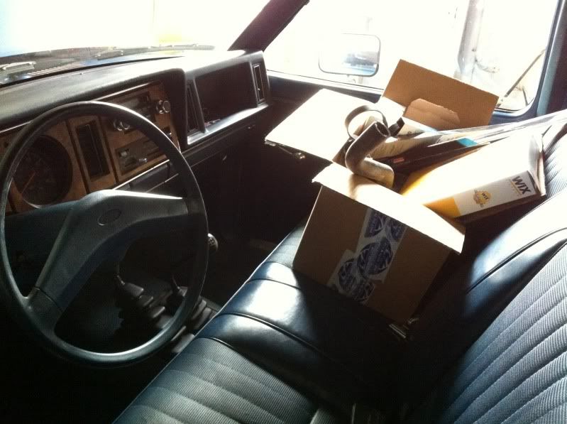

I ordered the rest of the parts I think I’ll need to get it running, and a few extras…
Parts include:
-Oval port cylinder head with roller cam
-Motorcraft/Autolite 2100 .98 carburetor with 1” spacer, and all necessary gaskets
-“Superflow” triangle air cleaner
-Ignition coil
-Head gasket
-Intake manifold gaskets
-Exhaust manifold gasket
-Valve cover gasket
-Oil pan gasket
-Back timing cover
-Front and rear crankshaft seals
-Fuel pump
-Front brake pads, rear shoes, and hardware
-Skyjacker hydro shocks
-3.5° adjustable caster/camber bushings
-2” aluminum spacers
-Belltech 6400 shackles
-Polyurethane bushings from James Duff:
-Coil spring seats
-Shackle bushings
-Radius arm bushings
-Had intake manifold and valve cover powder coated
-I’m also thinking about picking up a stock appearing adjustable cam gear, but haven’t ordered it yet.
I think that is everything…? :icon_confused:

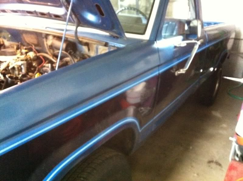

I also pressure washed the engine bay and cleaned it up a bit…:D
Before:
After:
