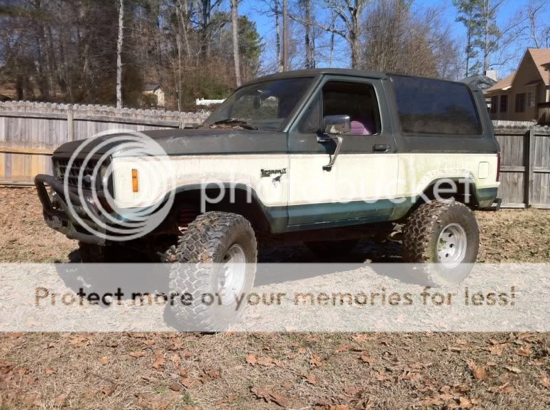

13 years ago, I purchased my poor little Bronco II from a guy that picked it up in a heavy equipment auction. He wanted the equipment, but had no use for the little BII. It wasn't running well.. turned out to be that the plug wires were not in the correct firing order. It was also missing the air cleaner and the catalytic convertor that I replaced. Got it running well and fixed it up some. It went through a few iterations of off-road duty. 2 inch lift and 31s on black steelies then 3 inch body lift and 33s on aluminum wheels. after a few years, I lost interest in off-roading and picked up a few motorcycles and now I do a good bit off back country, dual sport adventure motorcycle trips. the poor Bronco II sits lonely in the back yard.
today, it looks like this...
my daughter is 15 and soon to be 16 and has convinced me that it'll be a good idea to fix up the old BII for her to drive. so the purpose of this thread will be to document the reanimation of the Bronco II and making it something my Daughter will be proud to drive. She's offered to get greasy and help.
the plan is to return it to a more "streetable" version of it's former glory, but still be able to hit the mild trails.

There's a bit of surface rust on the roof (crappy paint laking off), and a spot on the back side of one of the rear windows. The benefit of beinga Georga vehicle. No salt on the roads and in the Atlanta area, we're far enough from the cast to not have to worry about sea air. There's a few dings, but no major bdy work needed. It actually cleans up pretty well for a 30yo vehicle with original paint.

It's got a nice stance. You only have a body lift on it with 33's? I'm guessing they're 10.5" wide?
Either way, It looks very solid. It's going to look really, really good. Looking forward to seeing the rest of your build.
3" body lift, 2" coils in front and add-a-leaf and '97 Ranger block in the back.
33x12.50 Pro-Comp MTs on 15x10 wheels. Opps.... That should be 15x8 wheels.
