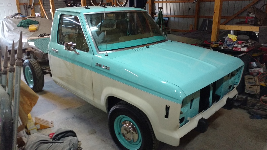

Thanks guys. 76mojo . . are you willing to sell one? or at the least loan me one? I have made molds of parts before and could possibly make a mold and produce a few. We could start with a couple close up pics so I can see exactly what I'm dealing with. Hope you're willing to help.
Truck looks awesome! Wish I had the part you're looking for, both of my tailgates are missing that stupid thing.
