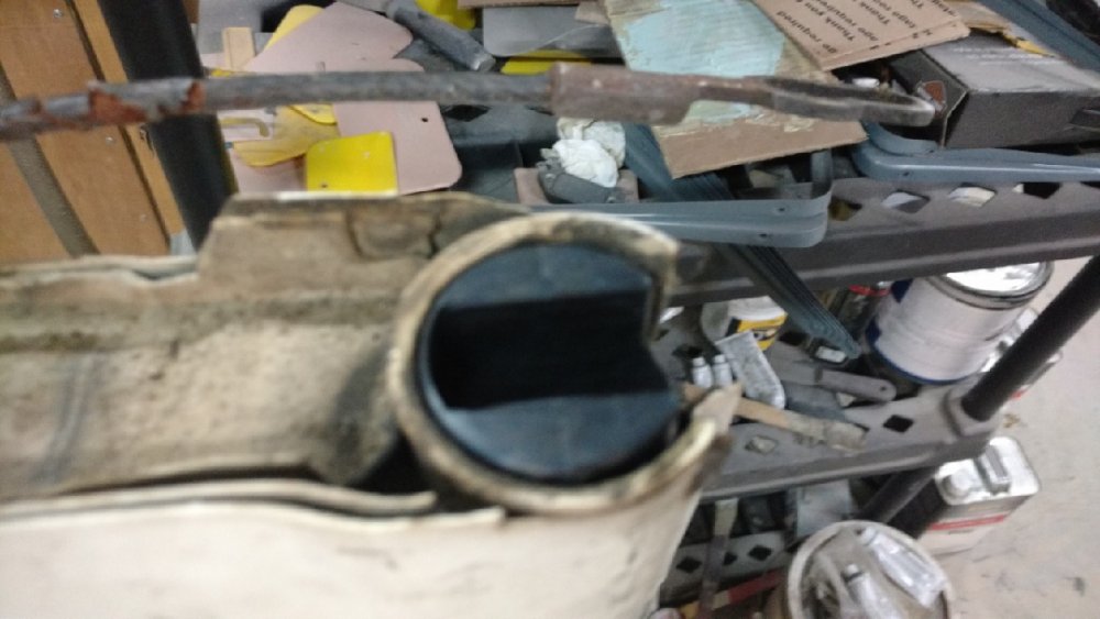

Pete, I'm working on my tailgate as well. Here's a pic of what I think you're looking for. I picked mine up at a salvage yard a couple years back. If you need a different angle or something else, let me know and I'll post it for you.
1qaz . .thank you. Yes I figured that is what it looked like, although I thought there would be some more meat at the thinest area. I could turn one out of wood, and then make a mold. Then using ABS would be easy enough. I'm pretty sure that is ABS you are showing. Thet fact that they are so thin in that area is probably why they are breaking. I don't have any aluminum rod that large ( they are about 1.75" dia ), but that might be an option too. Thanks again.

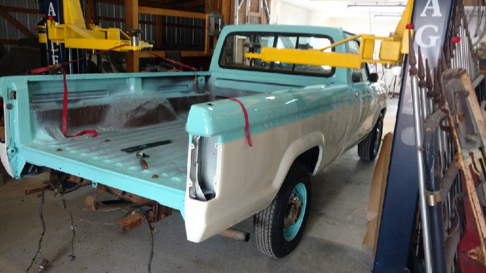

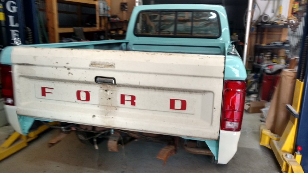

I installed the tailgate to see how it fit. I reinstalled the painted bed today, tailgate fits perfectly now . . time to paint the gate.
