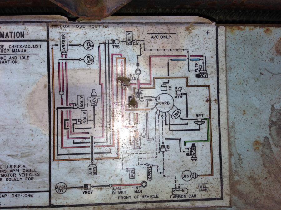

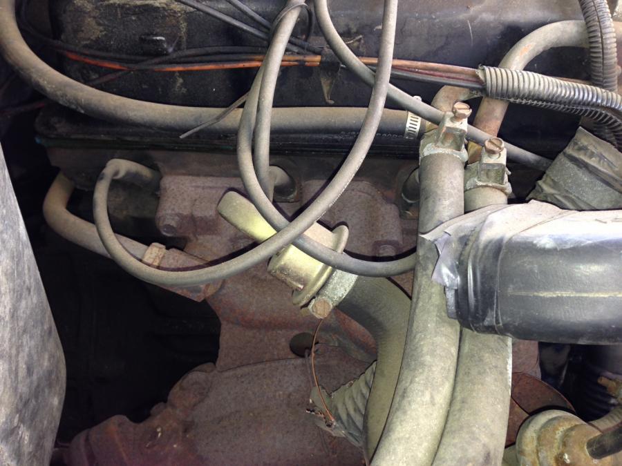

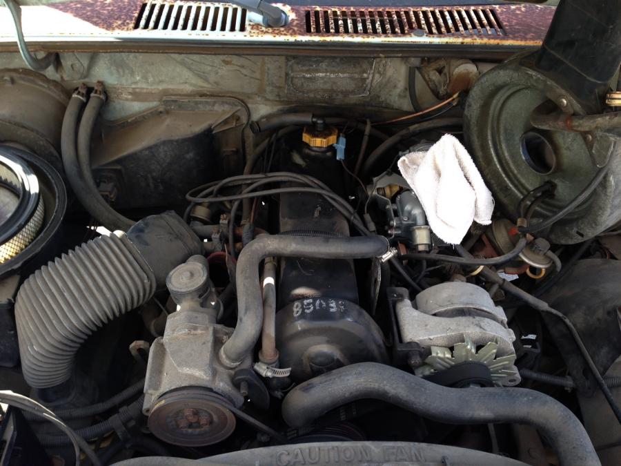

Here are some pictures not sure if they will help with anything or if i need some more at a diff angle let me know.

Nice pics btw...you are probably one of millions that actually has that emission diagram so you may be a bit of a celebrity on here...so many people looking for that routing diagram over the years...you could probably make a few bucks just selling the image...lol
