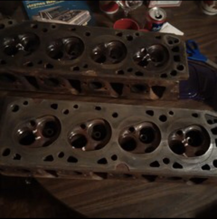

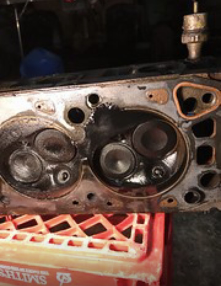

The dual plug head on the lima 2.3 is the “head-cracker”. mine was cracked multiple places on every valve seat, had my junkyard replacement checked and it was cracked also. Theres just not enough material with the dual-plug setup to deal with the thermal cycling, and eventually it cracks. My head gasket failure was between cyls 3 & 4. and the gasket had eroded to the oil return, so it was drawing oil into a cyl then pushing it into the exhaust. 2 cyls and fogging for mosquitoes! It would go through a qt of oil in 4 miles. Ended up with a “remanufactured” head from autozone. at least that way I knew it was good, got new cam bearings, valve seals & valves that way as well. Its been 4 years since that was done and I haven’t had any problems.

I been trying to find a reman head but no one has them. I ordered one from a popular online rebuilder, that shall remain nameless. The head came to me with receded valves. I took to a machine shop that I use for all my auto stuff. He looked at it and laughed.
