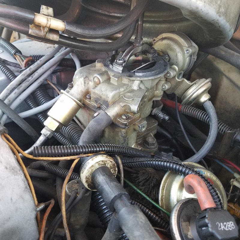

28646
That's a photo on my carb. I gave it a good shake and its doesnt wobble for say but I can see it move a little.
The throttle is closed.
I notice to when running seems like Its running too rich from the smell.
Sorry for the long reply. I apologize and appreciate all the help
It shouldnt move at all.
You see those 4 little screws down where it bolts to the flange that bolts on the intake? Pull the carb and tighten/locktite those screws and try it,
I doubt its rich if its idleing high.
After you get the screws tightened and the carb bolted back on (with new gaskets), look up the idle MIX setting. Most carbs are 1.5 turns out from lightly seated. But check on yours for sure.

I will get the 4 bolts tight. Which carb do I have anyone know?

As for the carb bolts I can see one. I can feel a second across from the one but that's it. I dont see or feel 4. You sure this carb bolts down with 4 bolts

I think you have a C-1 YFA Carb
