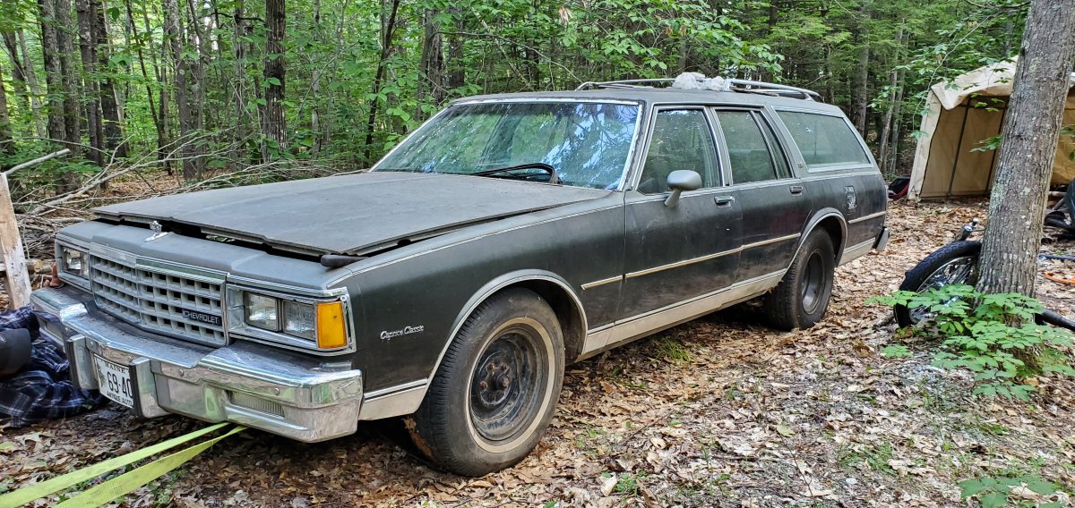

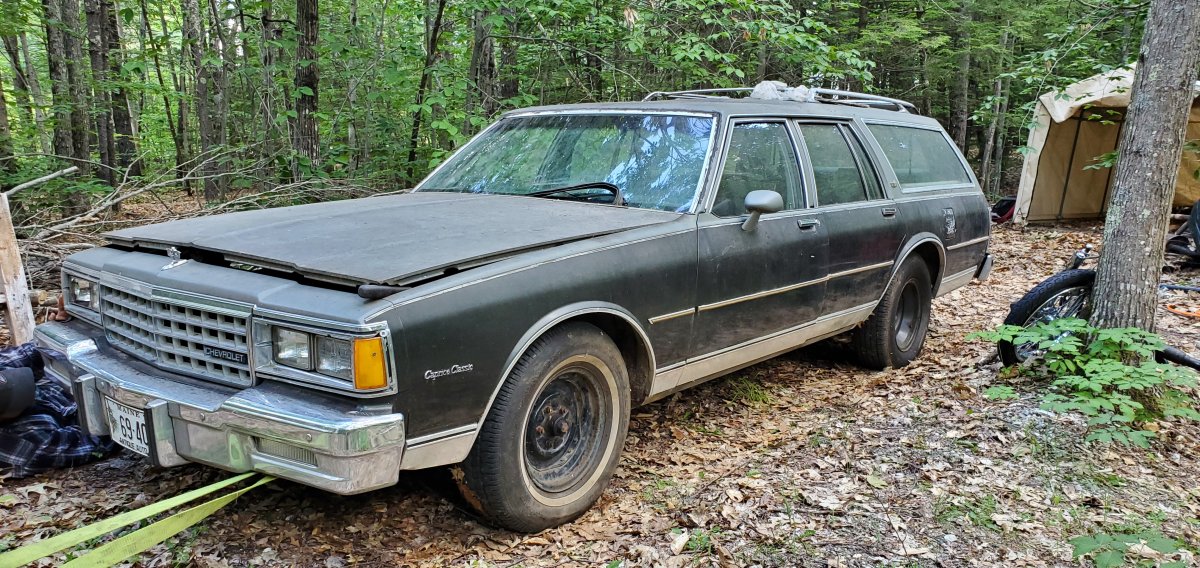

I fell in love with wagons while owning a turbo subaru outback. I fell in love with big v8 rear drive American cars while owning a crown vic..
So when it was time to purchase a weekend cruiser.... I combined my loves and bought a big one.
1983 chevy caprice classic Station wagon. Fully loaded. Dismal 305/700r4 combo. 2.72 rear gears. 15.6 seconds to 60. Wouldn't spin a tire. It DID get 21ish mpg though.
Drove it for the summer, decided it would be more fun if it was fast.. and started amassing sbc turbo parts.
When I learned about how much easier it was going to be to make big power with an LS.. I sold off my sbc parts and jumped on the bandwagon.

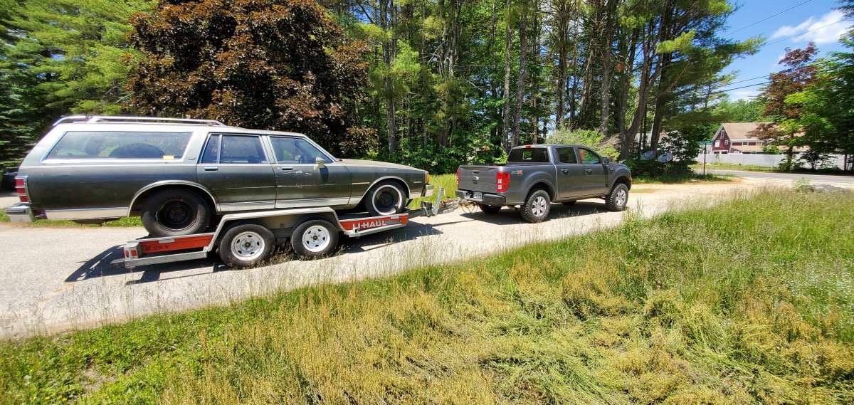

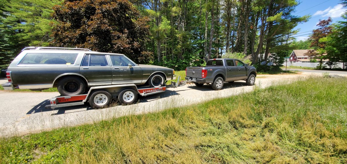

Now... 4ish years later... after acquiring a bank breaking amount of parts... I've finally got the car from where it had been hibernating to my house where I can finally start the swap.
Hopefully next weekend will bring the removal of the old motor & tranny.

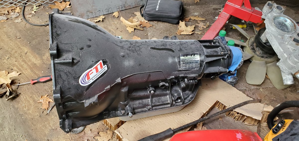

All said and done.. the car will have an e-carbed 4.8 twin turbo LS, an FTI level 4 transbrake th400, a ford 9" rear end, big sticky tires, and hopefully still look like a complete bucket.

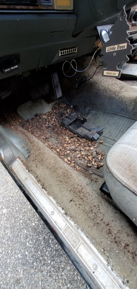

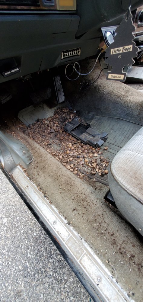

Making the interior safe to sit In after years of mice inhabitation will probably be more work than all the mechanical crap..

I don't believe the th400 was put in a g-body from the factory, but I could be wrong. I think it being a th350 Is more likely.
The th350 pan would be square with a corner "cut off" a th400 pan is weirdly shaped.

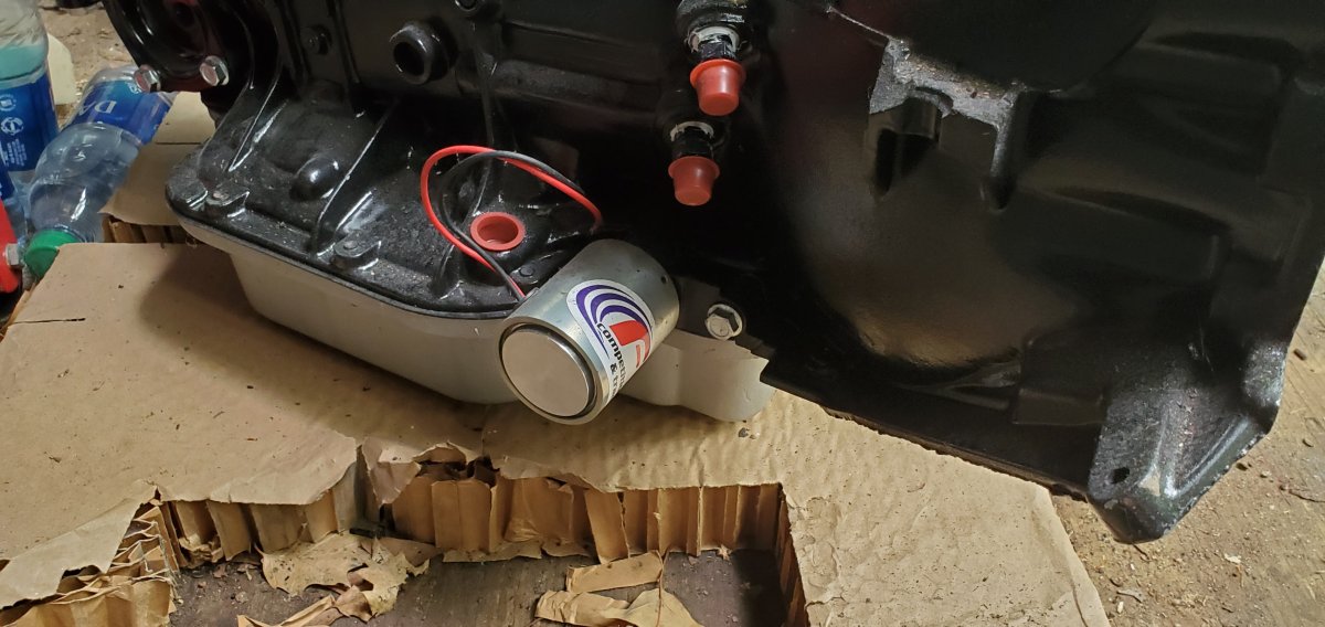

Sometimes, solenoids make for great fun. This is one of those times.

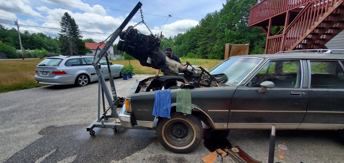

Got the old garbage out today, and made a huge mess of the driveway.

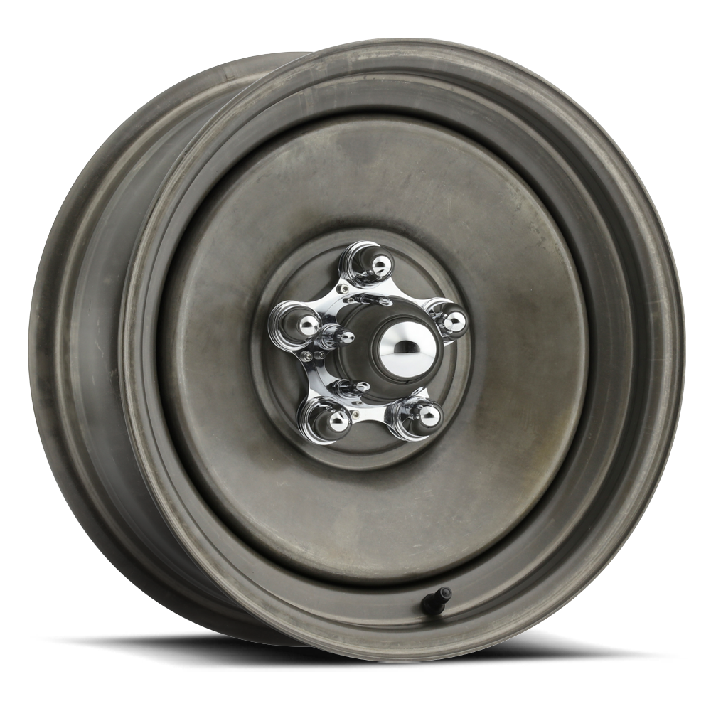

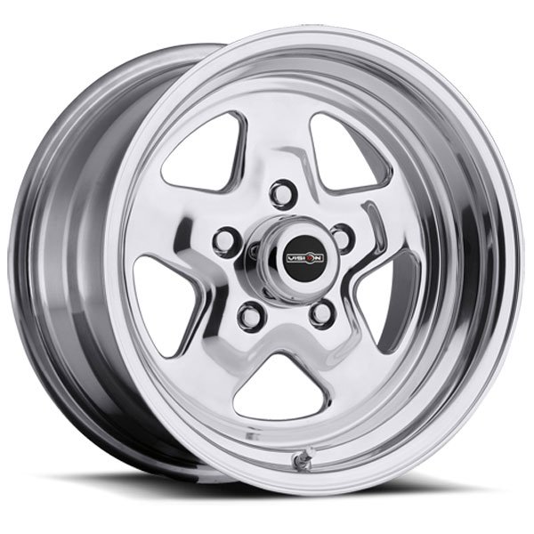

Ordered a pair of these for the front. 15x4. Gonna wrap it with a 28 or 29x6 tire.
You sure do make a mess...
Nothing about those wheels say "sleeper"
And your wife is gonna be mad when she finds out you used her hair towel to wipe your greasy hands...
I'm probably going to have the wheels powdercoated, so they look rusty. There's a powdercoat place super close to where I live conveniently.
I originally wanted these..
61970
Buuuut.. the size I wanted for the fronts is sold out everywhere, and I want to make immideate progress. Oh well. Having a lighter wheel will be nice.
*science everybody knows time*
1 lb unsprung weight, depending who you ask, equates to anywhere from 5 to 7 pounds sprung weight.
This means that the 28lb savings on my wheels by using aluminum instead of the steelies I wanted is almost the equivalent of removing 140-196 lbs from the interior of the car.. and if ET's were super important.. that weight savings would make me anywhere from .14 to .19 faster down the drag strip! Weeeoooooooo!
Oh, and they're old towels. They got relegated to garage duty a while ago lol.
It looks like the old engine changed it’s own oil regularly.
