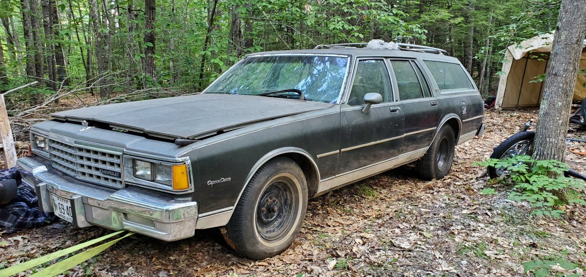

1983 chevy caprice classic Station wagon. Fully loaded. Dismal 305/700r4 combo. 2.72 rear gears. 15.6 seconds to 60. Wouldn't spin a tire. It DID get 21ish mpg though.
Drove it for the summer, decided it would be more fun if it was fast.. and started amassing sbc turbo parts.
When I learned about how much easier it was going to be to make big power with an LS.. I sold off my sbc parts and jumped on the bandwagon.
Now... 4ish years later... after acquiring a bank breaking amount of parts... I've finally got the car from where it had been hibernating to my house where I can finally start the swap.
61696
Hopefully next weekend will bring the removal of the old motor & tranny.
All said and done.. the car will have an e-carbed 4.8 twin turbo LS, an FTI level 4 transbrake th400, a ford 9" rear end, big sticky tires, and hopefully still look like a complete bucket.
Making the interior safe to sit In after years of mice inhabitation will probably be more work than all the mechanical crap..

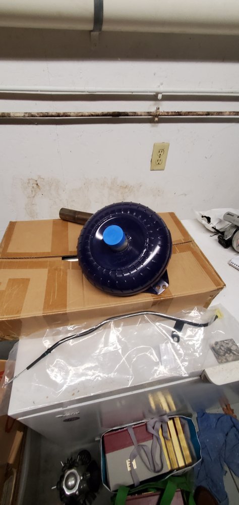

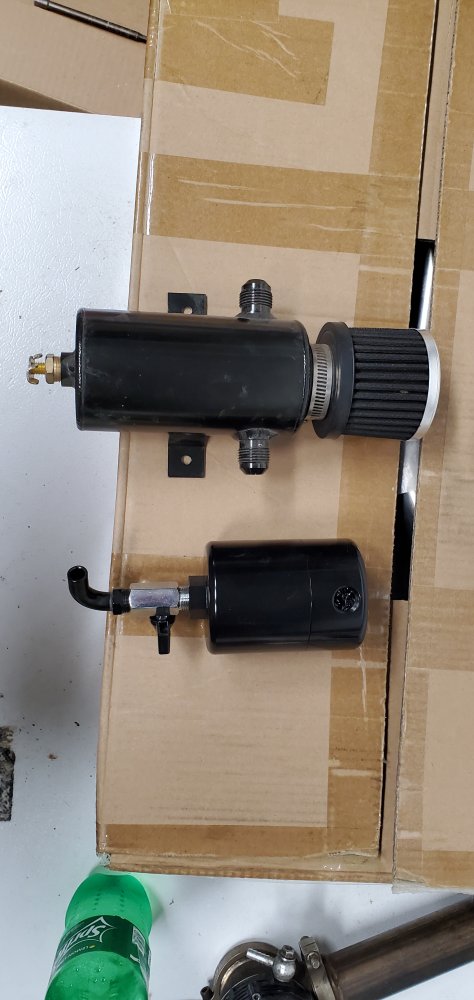

(Terrible) parts pictures!
In order..

•b&m nitrous holeshot converter 2700rpm stall (for now), holley dipstick

•ChingChong breather tank & air oil seperator
At my mothers is an FTI level 4 th400. Rated for 900hp, trans-brake, retains engine braking in 1st and 2nd. Google "th400" if your too impatient for me to take a picture of this.
I have everything I need to put the motor and tranny in the car, minus new mounts. I'll just need to figure out at what position I need to put the conversion mount plates on the motor, and move my tranny crossmember back a few inches.
