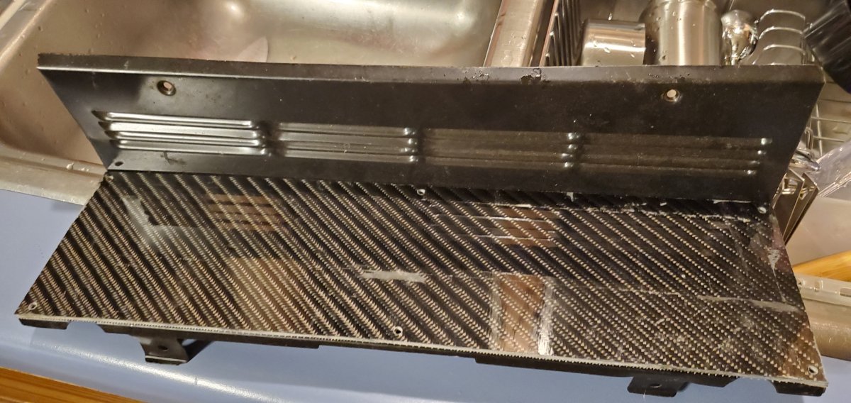

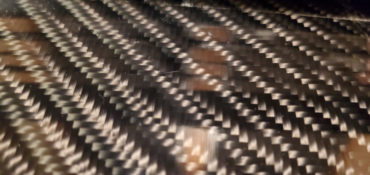

A racecar needs carbon.. somewhere.. so I bought a very small 'sheet' of it off ebay to make a guage panel out of.
Just need to figure out the guage arrangement and find my holesaws.
The carbon piece will simply be riveted to the factory stamped cluster face or whatever you wanna call it. I got a handful of copper rivets to use laying around somewhere.
I cut the piece to size with a grinder, and drilled my holes for the rivets with the gun in reverse, both methods worked perfectly.

The carbon idea was mostly out of irony lol.
