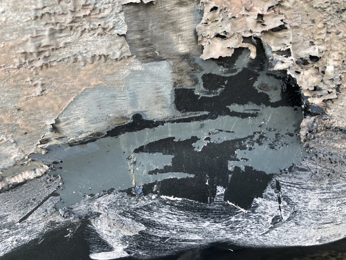

i used the Citristrip. It works! It actually doesn't strip very much OEM paint at all, but attacks the hell out of aftermarket layers and/or accidental splatters from somewhere. Amazing. I will 100% end up using it to remove something or other in the future.
After letting a few coats dry with reapplications between, the thick grey primer peeled right up using a plastic cooking spatula. Farily easy to lift.

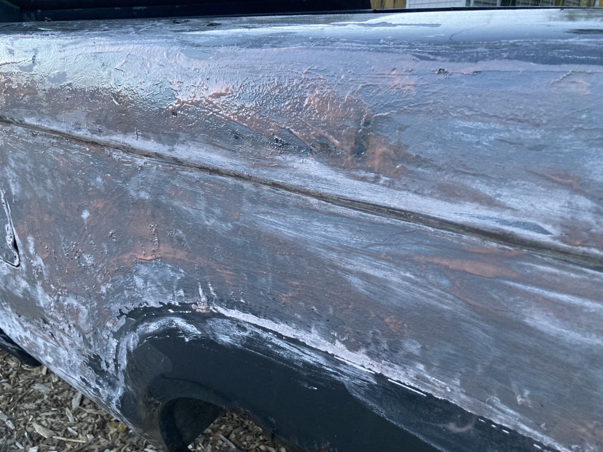

First pic is the left side of bed with Citristrip sitting wet, second pic is right side of bed after i had already Citristrippd that side and hand scraped the bulk of the loosened grey primer and then dove right in with the rotary sander.
Here's my current working theory about the history of the truck... Somebody bought the truck used cheap for off roading purposes but it had a business logo on either side of the bed. Some random mom and pop business logo isn't going to do, so they took a wire wheel and just ripped right into the logo. In doing so, but not caring much, they made the raw metal appear super toothed up with grooves all over the place. Then, having some wisdom about raw metal quickly rusting, they hand slapped a thick coat of some enamel primer very hastily. Then they thought they'd just make it even rougher and (thankfully poorly) slap some truck bed liner all over the cab.
As i was removing the layers, i swear i could make out some letters that were green and red. Additionally some negative spaces of OEM paint that surrounded those letters. I'm now also noticing that the patches of light green on the hood are actually on TOP of the black oem. So it's starting to make sense. There must have been logo work there too.
I only spent about 20 minutes rotary sanding. 40 grit because i wanted to move fast and also i already have to make lots of grooves smooth so why i not just add to it. I didn't get through the whole side of the bed but fairly close.

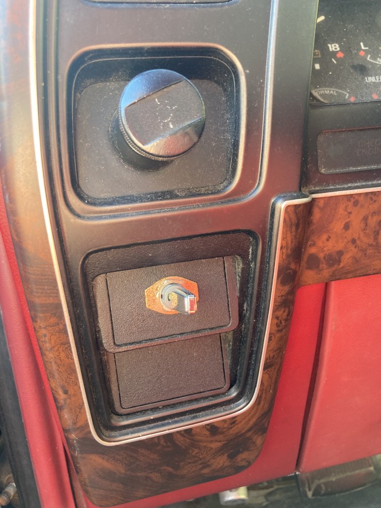

What is this switch at the bottom? It's a momentary toggle, ON/OFF/ON so there are two temporary positions and otherwise it stays in the center.
51159
Not factory so your guess is as good as ours.
Possibly a horn or something.

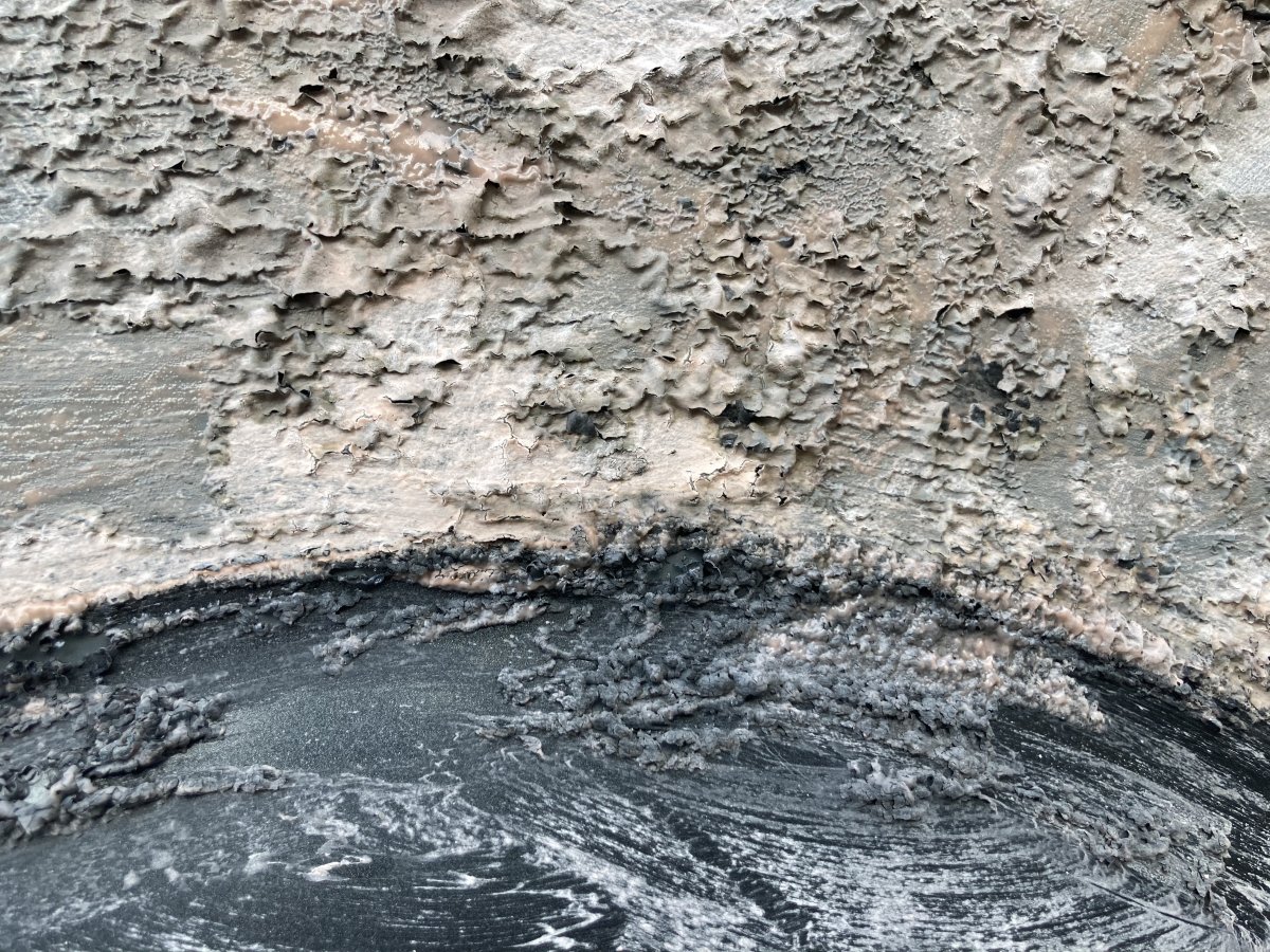

Here's the Citristrip after sitting for 16 hours with grey primer lifted off, above the OEM paint around wheel well.
The second pic is after about 3 swipes with the spatula, about 5 seconds of work. If you look in the first pic for the non-Citristripped OEM paint towards the left, that's what we're honed in on in the second pic and you can see the blotch of OEM paint still sits there but the OEM paint is in fact removed around it. So, given enough time, the Citristrip will remove OEM paint too. But i think that it will be a great product for letting sit for an hour and removing stuff that's blotched on top of the OEM.
In the second pic you can also see the handiwork of someone prior revealed under the thick grey primer. Sure looks like someone had attacked it with a wire wheel.

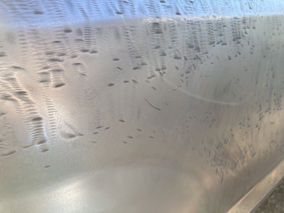

Below is a fully raw side of the bed. I got both sides to this point. Had to go at it with a DA using 60 grit for hours at high speed and a whole ton of elbow grease to get all the hand brushed thick grey primer, then factory black, then some kind of red, then the factory grey primer all off. So here you see the damage done by some previous owner, I’m still guessing a wire wheel.
I applied some self etching primer on both sides of bed, then after drying I applied a first layer of black sandable primer. I decided I wanted to at least see the whole general result of that first, then start digging in with whatever body work seems appropriate. This truck has so many flaws that it’s just not worth going about this in a traditional sense, so I’m going to let a lot of the beat up character make it’s way into the final look. Fine by me. I enjoy the history. I’ll probably end up with a satin kind of level of gloss, so that the paint doesn’t look like it’s trying to be flashy and new, but more like something that was a thrift store find.
A lot of those wire wheel marks are rather filled in by a smattering of stuff. So, after doing an etching layer and a first primer layer, it’s already looking far far smoother to the eye than what you see here. I forgot to take a pic of the etching layer which was an army light green. I’ll follow up with pics of the black stages as they come. Later in the week. Might be pulling the truck into the garage tonight since I’m worried about morning dew.
