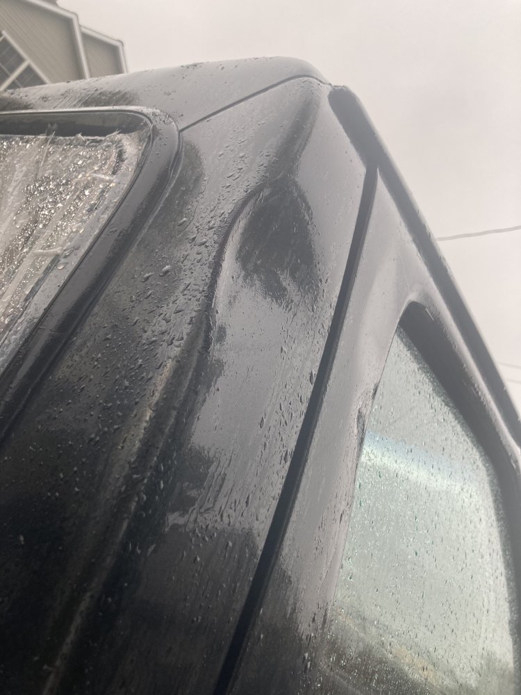

On the note of small holes....Here's a pic of a dent in cab edge. There are a few spots like this, inconveniently along the edge so will be a bunch more work than just pulling.
Anyone recommend a particular small dent puller for sizes like this one? I mean the kind that screw in a small hole and then yank. No need to be "paintless" since i'll be doing lots of bondo work anyways.
This truck will never get perfect but it can be fun looking pretty quick.

I would remove the interior trim and beat it out from the inside. But I'm not a body man.
Yeah i'd prefer that too, but i believe i checked and there is a second interior cab wall behind the exterior one but i may have misinterpreted that. Will inspect again.
Yeah its double wall there.
IMO unless you know what you are doing you are just going to make it worse. It will be hard to "pop" out since it is on a corner AND it has a hard crease in it.
Yeah, i may just attempt to bondo fill the whole thing and see about sanding aggressively to get it as close to original form as possible. Probably would turn out half decently and is lower risk, so long as it's not too thick per the bondo limitations. Fortunately this is the only one that's so severely messing with an edge. The other spots are all much smaller.
It’s going to be pretty thick. IIRC bondo says like 1/8” or less or something like that.
The old racer back things from back in the day might cover it up though.
Replicate it, evenly spaced, the rest of the way down the cab corner. Then do the same on the driver side. Then call them "speed dimples" like on a golf ball.
Hahaha.
Well I think I just saw somewhere that bondo can actually be 1/4”. If so, that might be sufficient for all my dents.
In any case this will never be a show car, so I’d enjoy testing the limits with bondo cause what do I have to lose! Worst case is I am limited by bondo thickness/stability so just back off some and the dent ends up still present but much shallower. Or I keep it thick and something cracks a little bit later and I patch/paint.
I’m probably going to end up spraying the truck myself.
Build it up in thin layers with about 24hrs cure time between layers.
