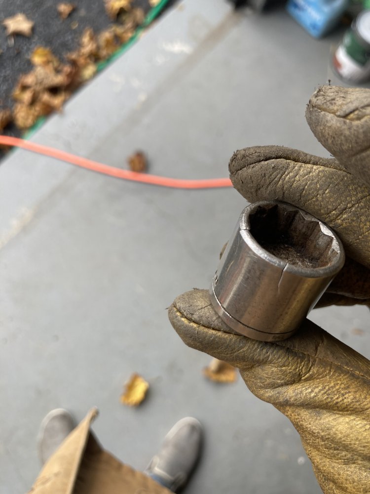

First attempt at unbolting the bed mounts after a couple rounds of PB Blaster sitting 24 hrs each. I have a large breaker bar and so I knew I’d find the weakest link in the chain pretty fast. Took me about 10 seconds to figure out that it’s the 19mm socket, not the bolts.
It’s about 45 degrees outside so maybe that’s a big factor. But if all these in bed are this tough where as the cab ones are almost all undone and loose already, I may be keeping the body lift for a while.

Try a cheap impact socket from Northern or Harbor Freight. It will be thicker walled, stronger than regular socket and only 6-pointed, so less likely to round off the bolt head.
ok will do.
