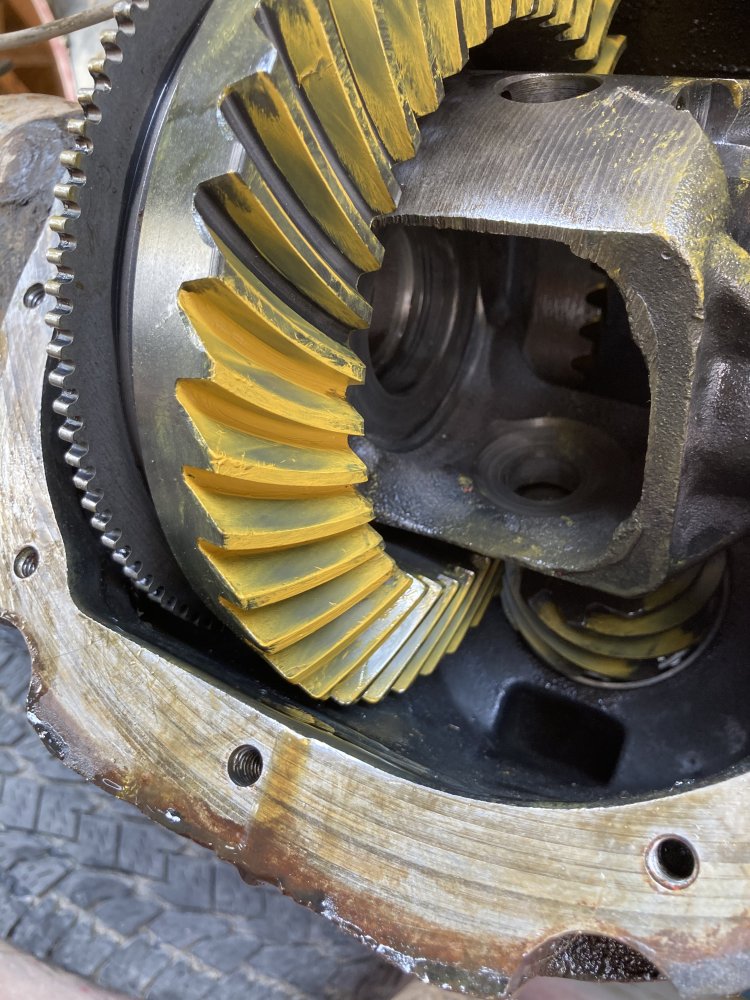

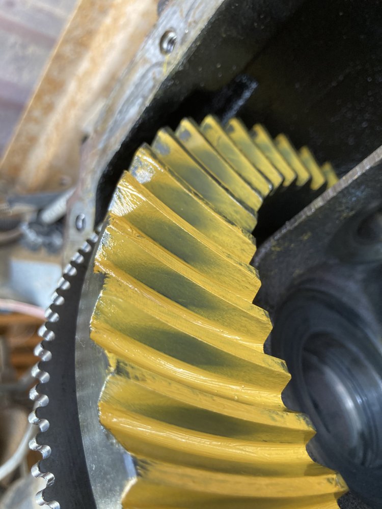

What’s the consensus? It looks good to me, but this is only the 2nd set up for me.
It's not bad, I'd like to see a longer contact on the drive side. The factory accepts worse.
I'd drive it.
Thanks guys, I think I’m gonna run it. Everyone I’ve asked said it was good. Walt has had the most criticism so far. I appreciate everyone’s input.
