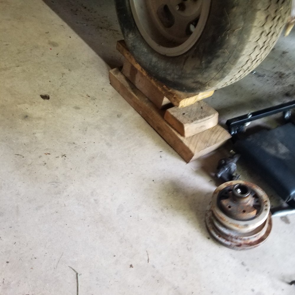

Im only using one block under each tire...stuck under the tires facing front to back. Its not going anywhere.
I have stands but i used the blocks incase i need the stands for other stuff
EDIT-...
Ive always used cinder blocks in this manner...figured if they would hold up a house trailer theyll hold a car. After googleing maybe its a better idea to use the ramps i got. I didnt realize it was dangerous. Good call.

Solid wooden blocks are way better than cinder blocks, but jack stands are adjustable. And cheaper than a crushed rib cage.

I got some steel ramps as well as some big homemade wooden ones (basically 4x6s nailed togther).
Stand would be fine on the rear but up front theres no real good place to put them. The front suspension arms are curved and with the back end still on the ground its angled to much to go under the frame.

i cant see anybody arguing against that. and i was only stating that there is indeed a safe way to use blocks...and reminding rusty to mind the orientation of them to maximize safety.

cinder blocks do take knowledge of what they can do and how they can be utilized into account...so i can see where i should not consider to recommend this...at least to inexperienced people.. rusty is not in that window.

Its weird we are having this discussion....for some reason this is the only car ive ever had weird premintions (sp?) About crawling under. Maybe cause it sits so low? I dont know. But either way thanks for pointing out my error. I was ignorant to the danger of cement blocks

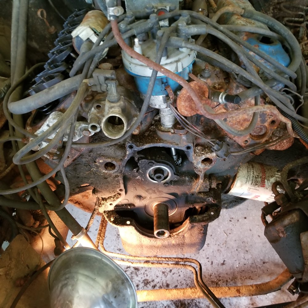

Got the old gears and chain off...
Even managed to save the oil slinger...

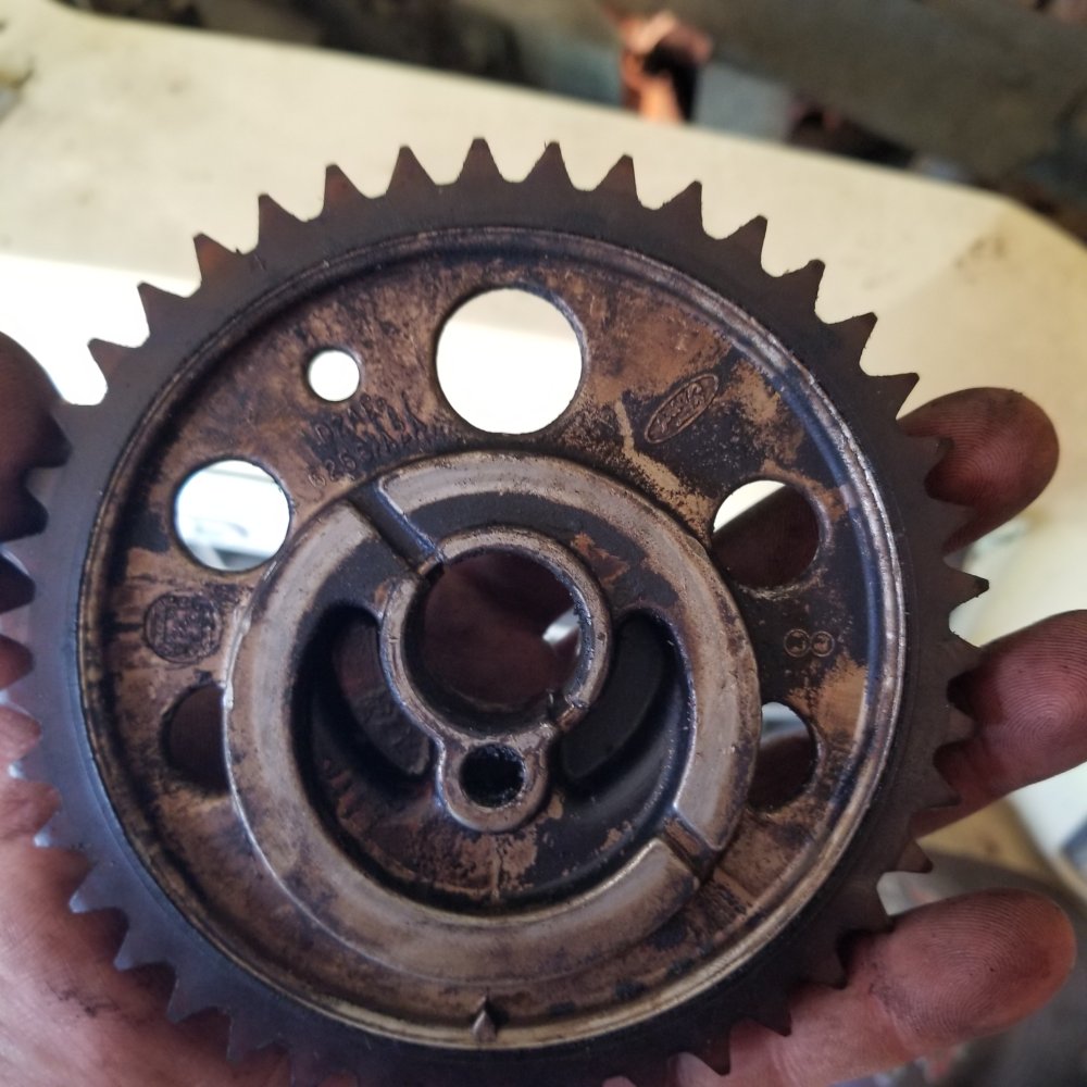

Old cam gear wasnt as bad as i thought when i compared it to the new one...

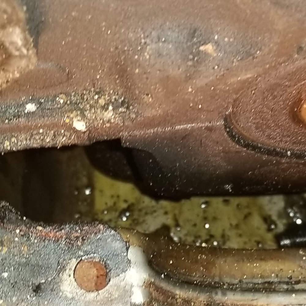

However i did not get the new set installed as planned because i dropped the cam bolt inside the friggin oil pan...

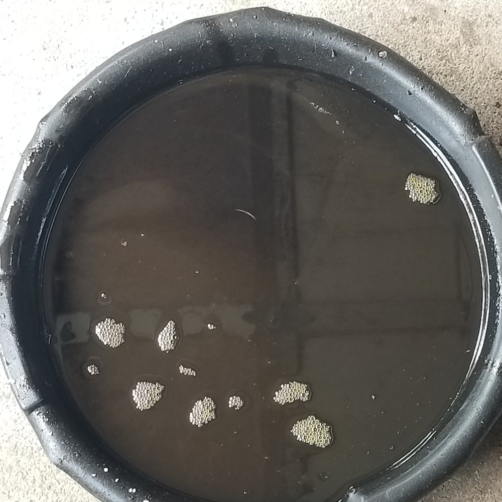

Sooo i drained the oil...
Looks like 2.9L oil. Full of what im hoping is condensation (it has sat since 2006 in a non temp controlled garage)
Oil pan is full of milkshake....
(You can see the end of the bolt to the right of the pic....i broke my magnet working on the yazoo the other day...dont ask)
Next steps gonna be dropping the pan and cleaning it out good...supposdly it can be done in car after lifting motor up. We'll see.
