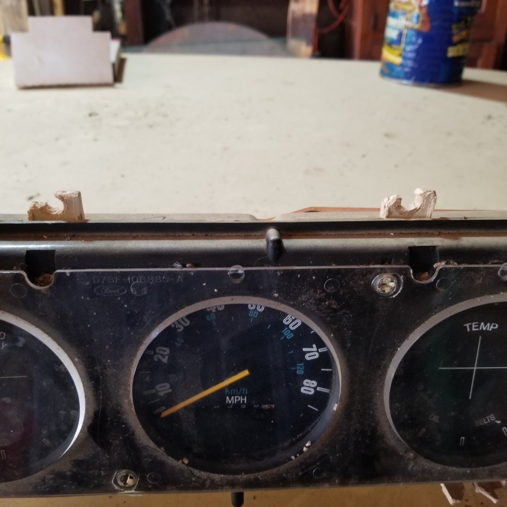

So i went back out today with every intention of working on the motor...and what did i do? Fiddle F around inside the car again.
Pulled my old cluster out...
77 LTD II

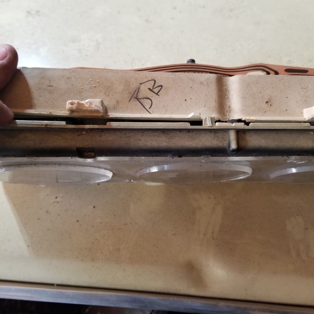

Its looking pretty rough...i noticed when i was messing with it the other day it seems the lenses were seperating from the body of it...and i was correct...
77 LTD II
77 LTD II
Also looks like damage to the printed circuit...

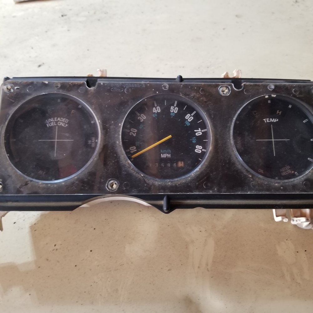

So whats a guy to do? Well test fit his sport cluster of course...
77 LTD II
The sport cluster isnt in much better shape then the regular...and im not 100% sure if im gonna run it yet or not. But you can buy everything needed to "rebuild" the sport cluster...including the plastic "chassis"....not so for the original...all i can buy for that is the printed circuit.
Whats your guys opinions? Sport cluster or standard? The sport cluster gives off that swanky 70s vibe like crazy...but itll require wiring work

Sport cluster.
I like mo stuff to look at.
Same. Sport Cluster.

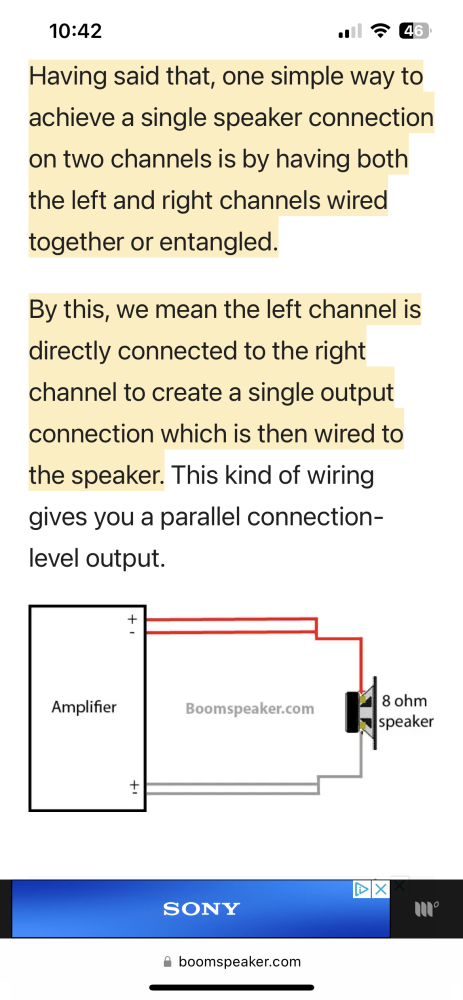

As i get more off track and ahead of my self...it currently has an AM only radio...and since id like to listen to stuff other then talk radio does anyone know if you can wire a AM/FM stereo into a single speaker and not have it be a jumbled mess of noise?
I dont really wanna cut up door panels and things for speakers...plus its alot eaiser to find am/fm OEM stereos of this vintage then it is to find the rather rare AM/FM mono radios some had
Why wouldn’t FM work on a single speaker?
I think you’re confusing a mono vs stereo system. Mono plays the same sounds out of all the speakers. With stereo, each speaker has its own output and the sound can fade across the speakers or have different sounds coming from different directions.
With Fm, even though the quality is better than AM, if you only hooked up one speaker on a stereo receiver, I doubt you would tell much difference. I think a lot of newer aftermarket radios will let you switch between stereo and mono outputs too, making it even less of an issue.
No i know FM can play through a single speaker....just didnt know if an radio designed for stereo would work with one speaker.
If it’s true stereo sound like on a CD or something you will me missing some of the sounds by on having one speaker. Some FM stations do transmit in Stereo, but I think it would be as noticeable.
I’ve never tried it, but I did a quick search and it sounds like if you wire both the L and R channels to the same speaker it should work find and have full audio.

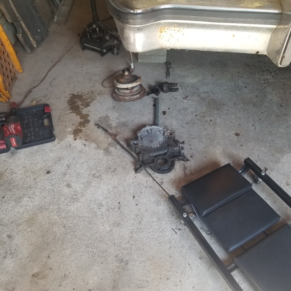

Ok went out and got dirty today.
Got the front end put up on blocks so i could get my fat ass under it. Once on cinder blocks i was able to sit between the core support and grille...lol
Anyways...got the crank pulley off, balancer off, pulled the fuel pump...and got the timing cover off....
77 LTD II
Everything went supriseingly smoothly there.

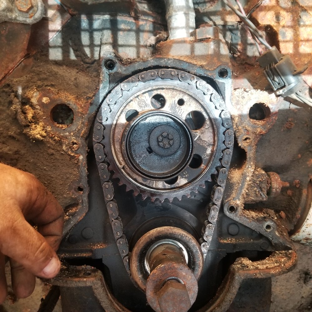

Now....look at this chain/gear...
77 LTD II
77 LTD II
Hard to see in the pics but this is/was for sure the issue. The crappy plastic teeth are wore pretty good and the chain is loose as shit.

First, go get some friggin' jack stands, they'll be cheaper than getting crushed.
Those flat chains used to be called silent chains and they always stretched something awful, as the engine turns the cam snaps back and forth and will soon peel those nylon teeth off the cam gear and jump timing. Pontiacs and Ford 460's used to jump timing at around 40k, small block Chevys would often jump in the mid 30's, but everything had excessive slack. I always use a double roller chain in everything I build, when I built the new engine for my Mustang in 2009, I resused the Ford Motorsport timing set from the engine I built in 1992 and it's still in there.
