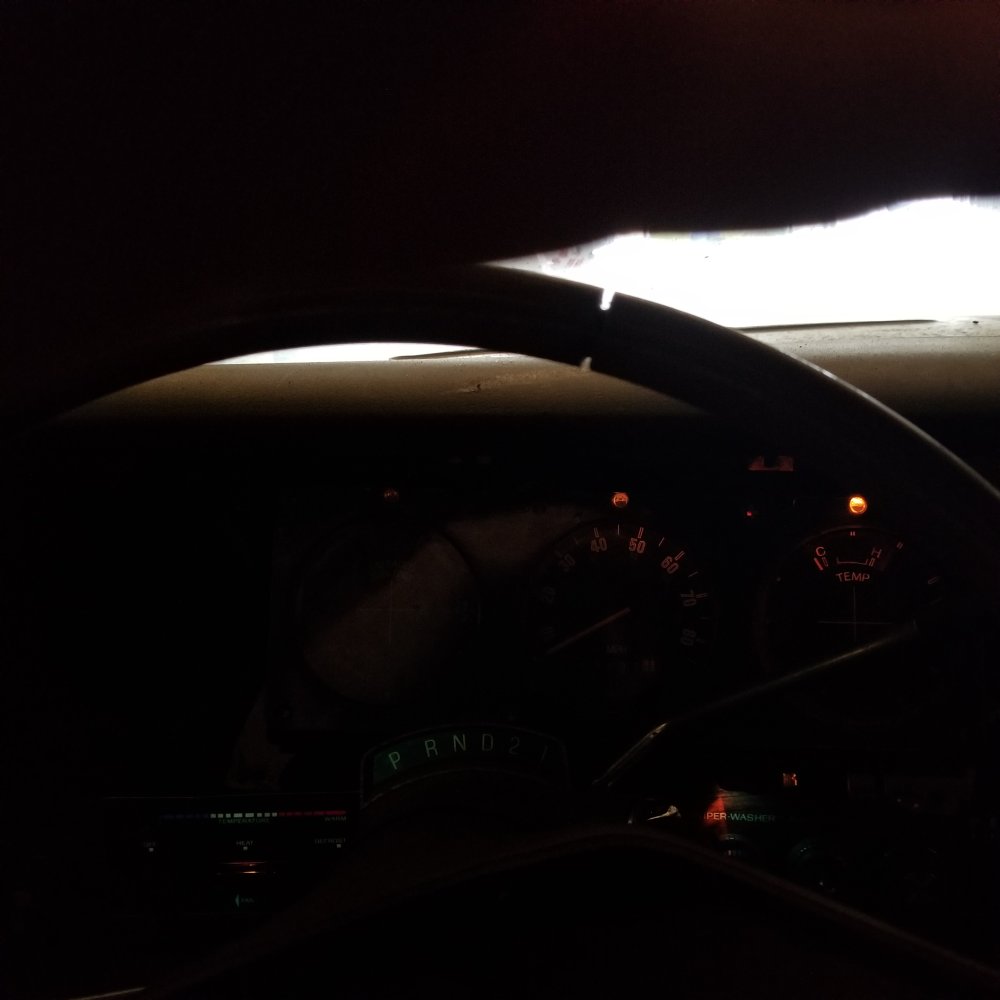

I pulled the dash bezel off, removed the fake clock insert, shined behind the dash and *luckly* all the wireing was intact. It doesnt seem like mice really did anything to it besides chew some insulation. So im happy there.
I pulled the battery out of rusty 2.0 and stuck in, hooked back up the solenoid wires, and seen what was working and what wasnt....
Shitty pic. I know. But all the lights on the bottom of the dash (radio, hvac, wipers, etc) fuctioned fine, as did the dome light. However the cluster as you can kinda see needs attention.
I may end up having to A) source a different cluster, as the top plastic brackets disentgrated (i maybe able to washer them, i dont know) or B) Install the sport cluster i bought for it...but that requires some wireing harness work from what ive read, but its pretty cool as it has a tach and gauges instead of idiot lights
The radio, wipers, blower, and switcher doors all worked properly.

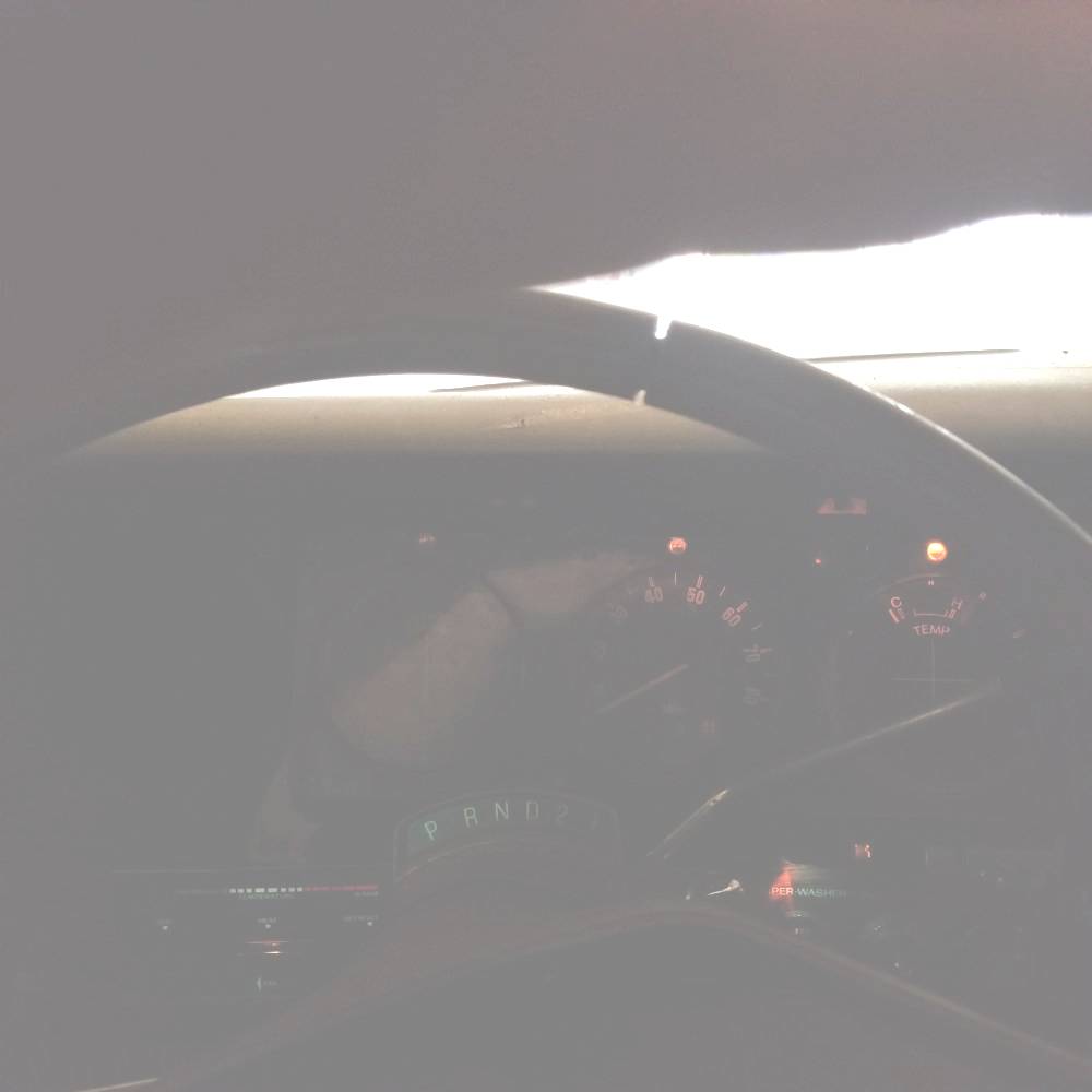

I couldn't help it much either. That's with a 100% brightness and 25% contrast
