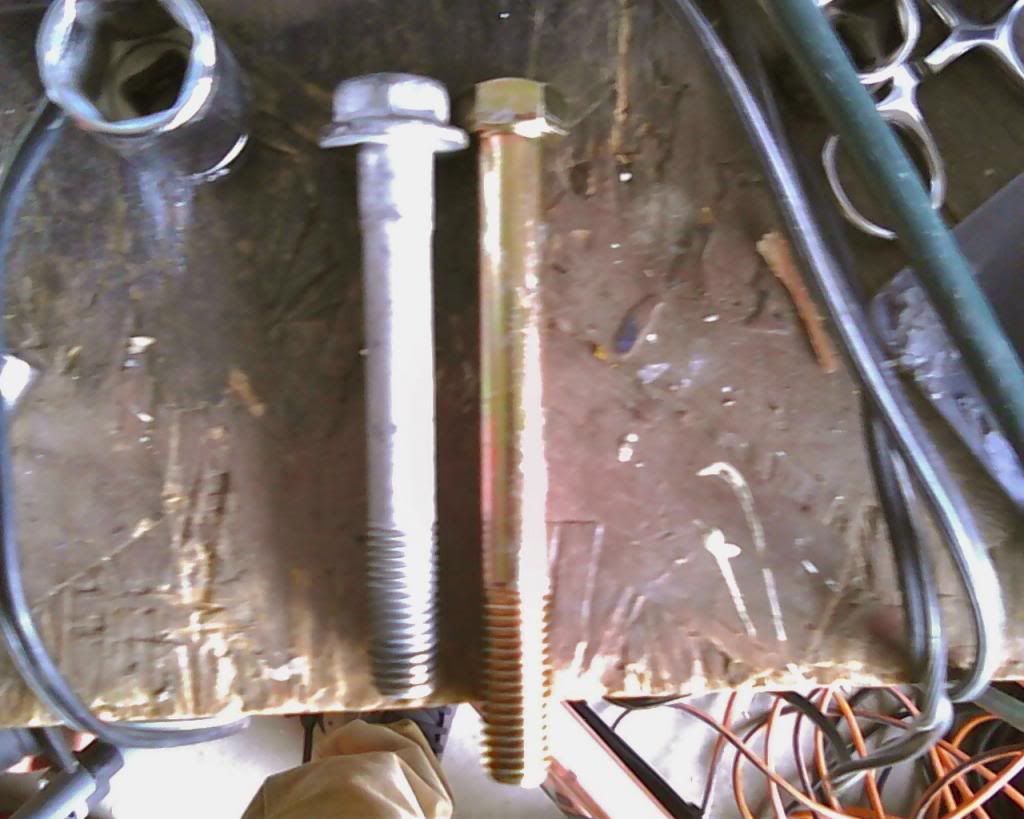

The nightmare started when I ordered energy's 4.2134 kit, front bushing didnt fit. Ordered the 4.2154 "98-11" kit front bushings were the same exact size and the "54" kit didnt work just the same as the "34". Called them up, they were super helpful, I told them the newer rangers have a 1.75" front main eye. They sent me out a set of part# 2184 bushings with a od of 1.7506" same day at no cost. Sleeves in the kit need 9/16" hardware.
wrong bushing from kit left, new correct size bushing right.
