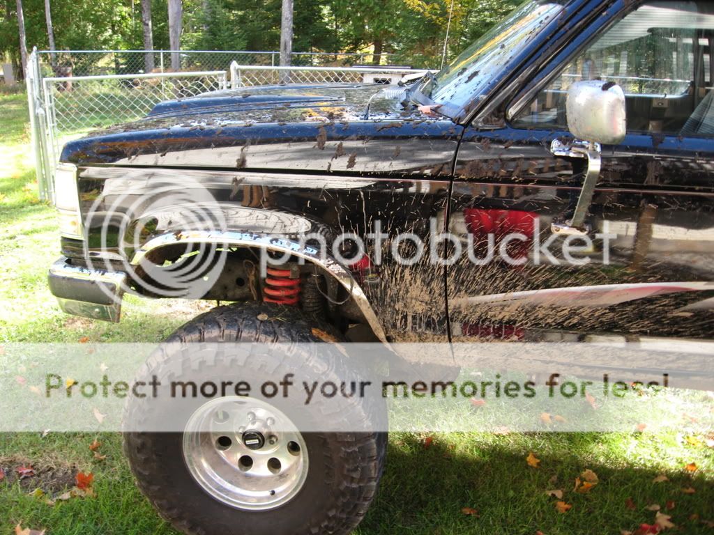

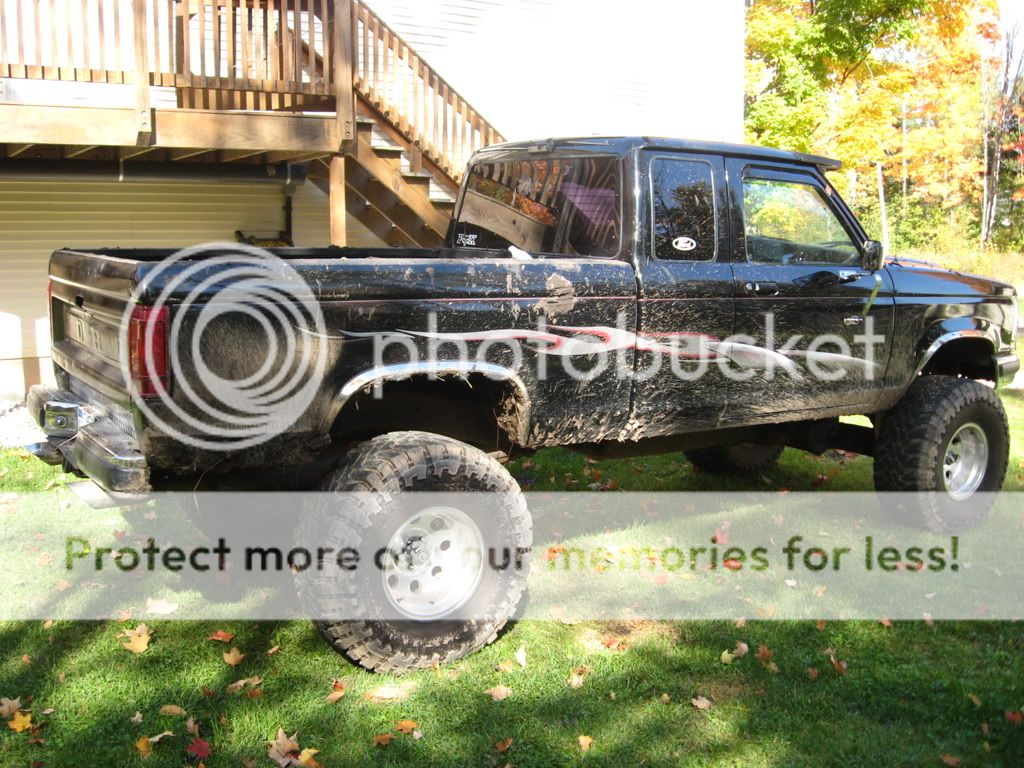

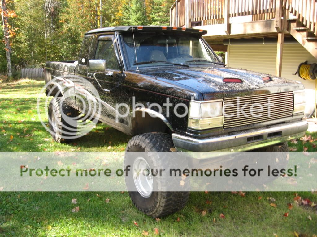

Truck when i bought it:
1989 Ford Ranger Supercab
2.9
5-speed
6" suspension lift (sold to beaujt)
3" body lift
35" toyo M/T's
paid 2000 and gave the guy my 1988 jeep cherokee 4x2

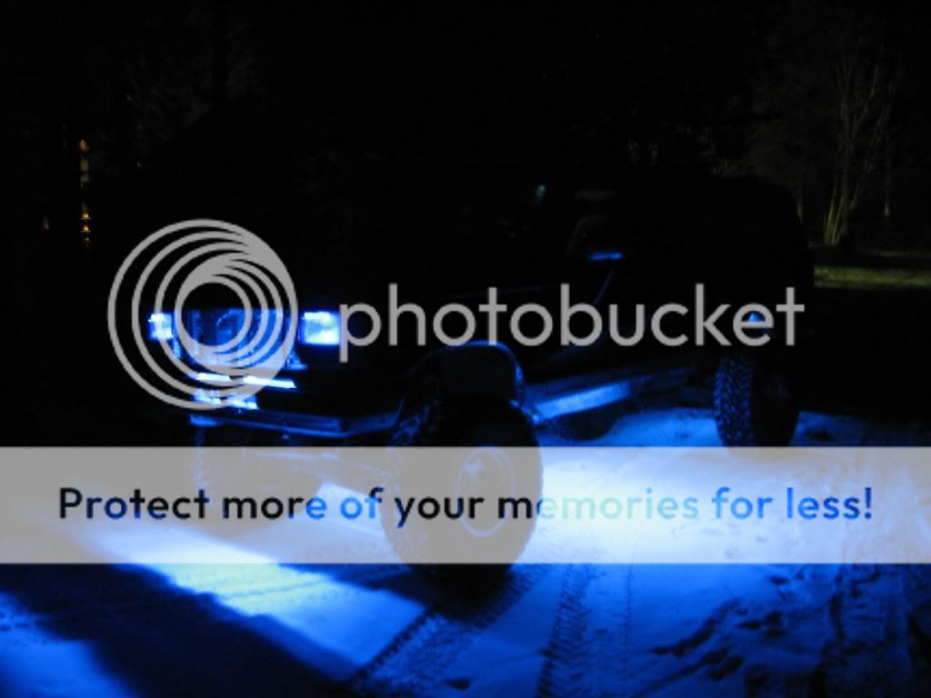

first night i brought it home:

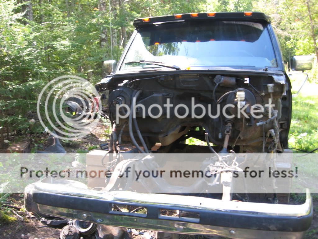

After a Few months of wheelin, i blew up the mighty 2.9. (cracked the heads) so i decided i wanted to do a FW SAS and a V-8 Conversion.
my dad had an old 79 F-150 in the back, so he gave me the axles for Free.

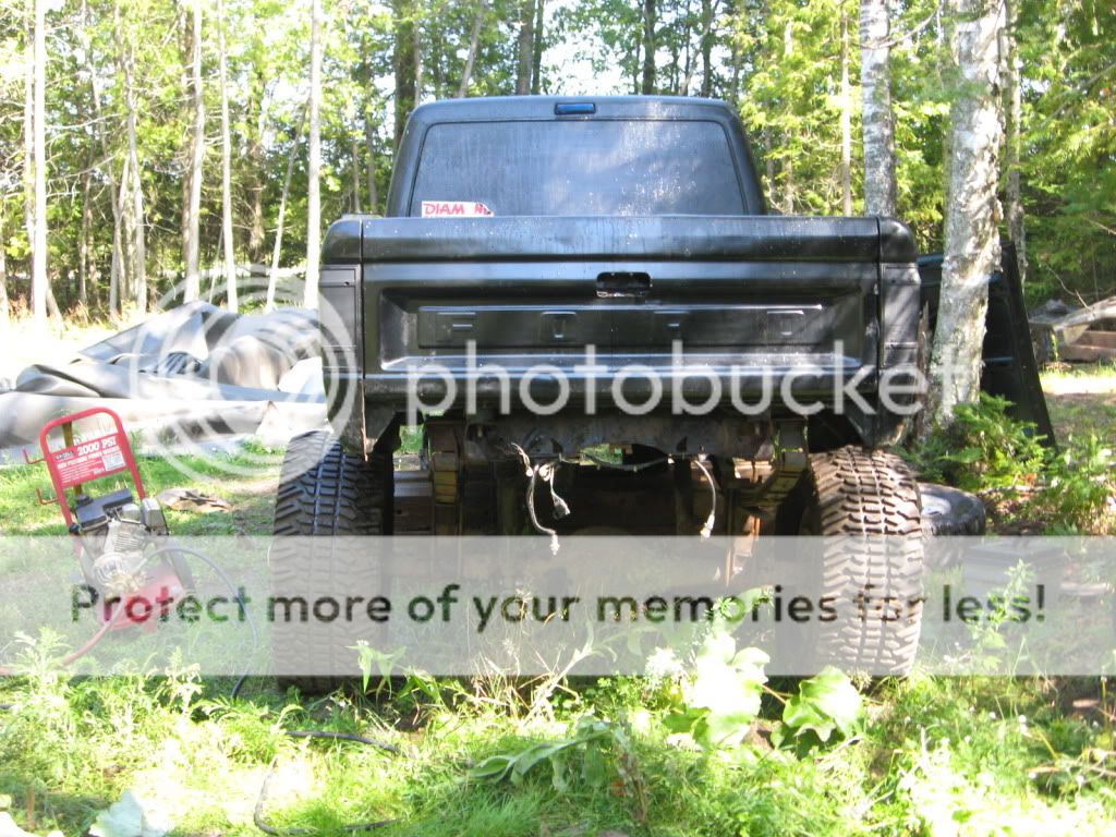

i got the rear put in (temporarily with blocks)
then i got it sitting on blocks so i could sell the front lift.
The 2.9 Is Gone FOREVER :yahoo:

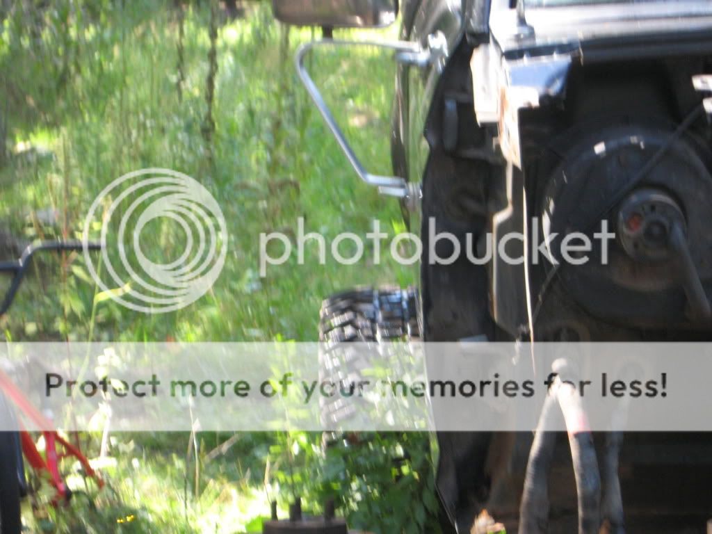

realized how far my tires stuck out with my new axle and tires so i had to get some fender flares, traded them for the tranny for the 2.9.

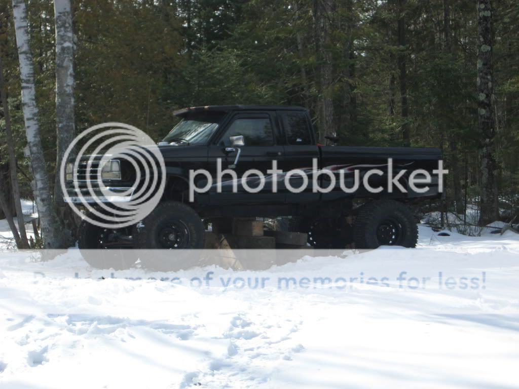

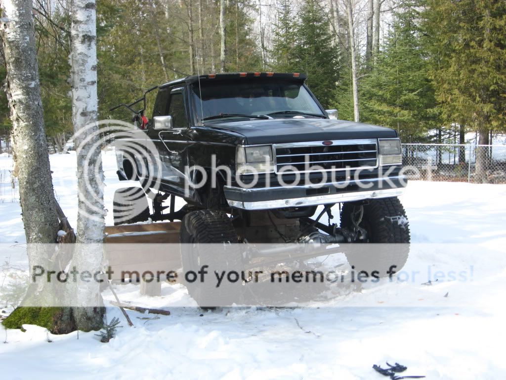

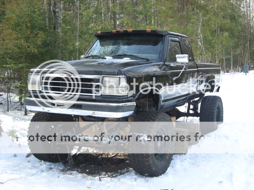

some current pics just to show what the stance will be (little taller in the front cause theres no engine in it at the moment)
to answer some questions before theyre asked:
1. no, i havent done anything about the rear blocks yet
2. it is coil sprung
3. tranny is a C-6 with a B&M slapshifter
4. yes, i am workin in the woods. garage is full of other projects
5. this will be my DD. i know its above the lift law but i just dont care!!
