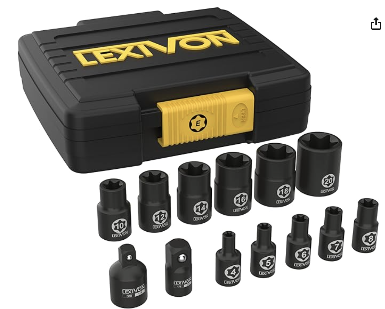

Might try hammering on an E-Torx socket if the extractor sockets aren't working for you.
Just know that you'll probably be tossing the socket with the bolt.

7.5 rear end frozen bolt something like this?
