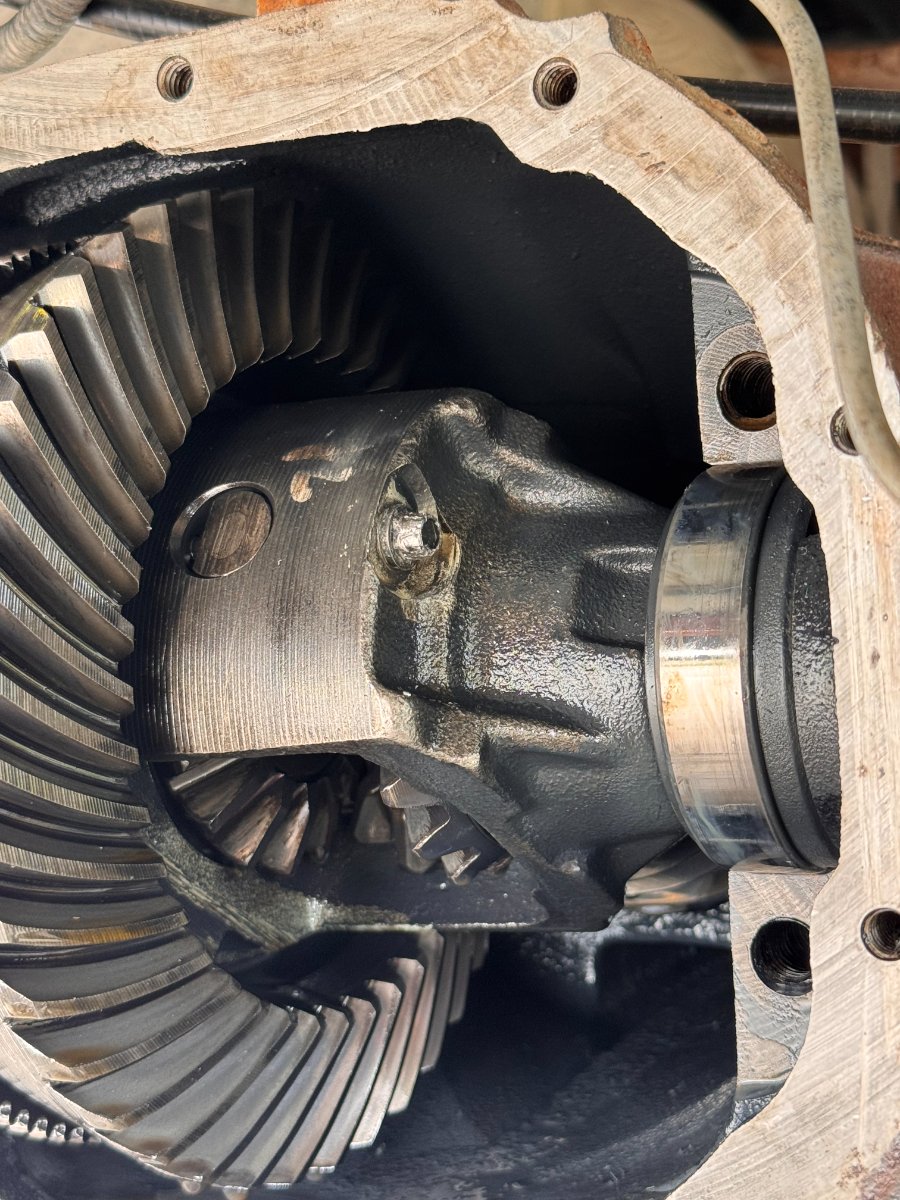

I'm working to replace the axle shafts, seals, and bearings on my '97 and the little 8 mm bolt that holds the big pin in place in the diff has decided that it doesn't want to move at all and when i tried to use an open end wrench, it ended up stripping a good bit.
Any ideas on how I can get the bolt out? A regular socket doesn't fit in the opening unfortunately :(

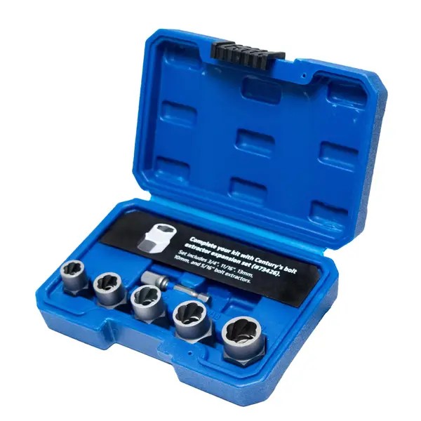

Tried heat and also that bolt biter thingy, the 5/16 (8mm) is too big because the bolt head is rounded off and the next size down is too small even with using a hammer to try and tap it in. vice grips didn't work either
😭 note, that when i ran heat it was for about 5 seconds, should I try it for longer?

5 seconds wouldn't even have burnt off the gear oil sheen, by heat what were you using? A butane torch would take a couple minutes, propane torch 30 seconds, hair drier like an hour...
Just realize you're trying to heat up 1/2 pound of steel to 300 degrees... that takes time!
That and that bolt head is screwed, oof...
benzomatic (blue cylinder) torch so butane I think ? Propane. Yeah that bolt head is...gone...I'm praying that with heat I can grab it with a pair of vice grips...I need to apply heat to the carrier housing right, not the bolt head?
Yeah, heat the spot between the bolt head and the cross-pin. Try not to put too much heat into the cross pin, but you need to heat that section between it and the bolt head because that’s where the threads are, it’s just a pin end into the cross pin, the threads are in the carrier.

Drive an extractor onto that bolt head... add heat... remove
That rounded bolt has a pretty healthy flange.
A little careful chisel work may get it loose, especially with some heat. Tap a sharp chisel on the flange edge, toward "loosen", to make a small cut and a step on the flange perimeter. Then with a blunter chisel give it a couple of good hard knocks in the loosen direction with a BFH.
If you use patience and finesse, you shouldn't damage the host part. I used to deal with so many rounded bolts like that at work, I had a collection of chisels that varied in sharpness, bluntness and bit profiles just for that task.
I tried and the 8 mm extractor is too big and the 7 mm one would not go on there for the life of me, I guess I could apply more brute force but I didn't know if that was such a good thing? I was tapping it with a hammer through an extension to get a better swing
