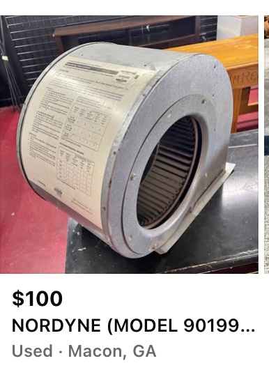

For a few years, I was a regular at Goodwill, and I bought every breeze box, oscillating, etc. fan I could get my hands on. They were usually $5.00. I must have 10 or 15 of them. This time of year, even if I’m working in the driveway, I set one up blowing on me.
I just picked up a residential 110 V squirrel cage blower from a furnace. The housing and the motor is OK, but the squirrel cage got damaged and it’s out of balance. Those things move a ton of air for little money. I’m thinking if I mounted it up high, it will never be in my way, and it would probably blow a good stream of air, the length of the garage.
I had a ceiling fan for a while, but the problem with that is all it did was pull a very hot air from the top of the trusses down on top of me. I’d love to have AC out there, but I’m usually fine if I just have some air moving on me. If I can’t get the air moving, I’m worthless when it gets over about 85, especially with the Georgia humidity.
I guess my underlying thought is by the time you fiddle with two or three pedestal fans, you could pick up a squirrel cage blower and move more air, more cheaply, and with less noise.

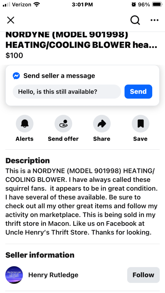

Macon, FB marketplace
