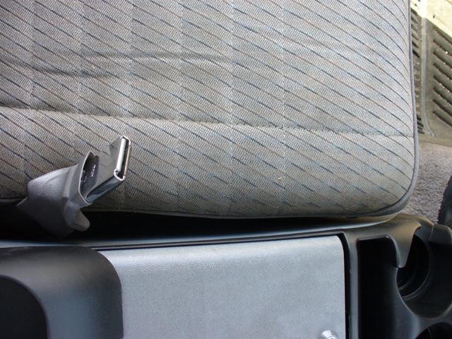

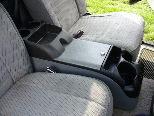

Did you get the $30 Clutter Catcher? That's what I grabbed last night, sounds like what you're describing. I didn't do anything to the console, just put a short piece of 1x4" wood against the floor and bolted it down, then set the console on top and screwed it down.

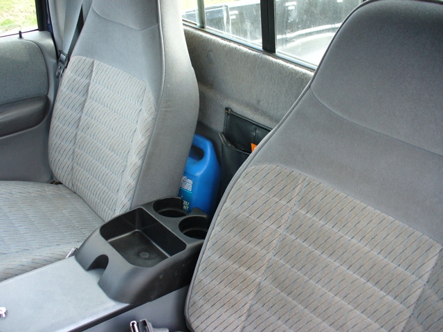

well i did it and it looks clean turned out better than i thaught =]
looks dangerous having the sub firing that close to your elbow, etc
ever bump it on accident?
what's on floor?? the two box things (sorry if it's obvious... it's 12 am here lol)
