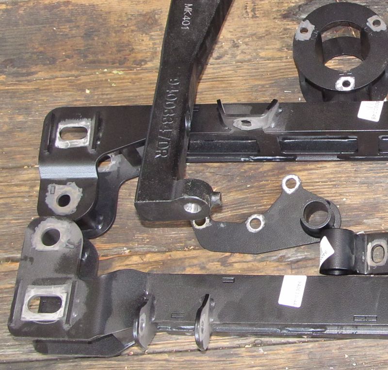

Any thoughts on small welds on the new cross members on the BDS 6 inch lift. Particularly where the cross members attach to the frame with the new bolts.
Certainly can't hurt to do that if you're worried about it moving around if you, say, bang it into a rock (you'd have to bang it pretty hard though)...
What I always do is sand the paint/powdercoat off around the bolt holes. This also helps things stay in place better. These areas can be repainted/undercoated after assembly if you're worried about rust.
Example:
