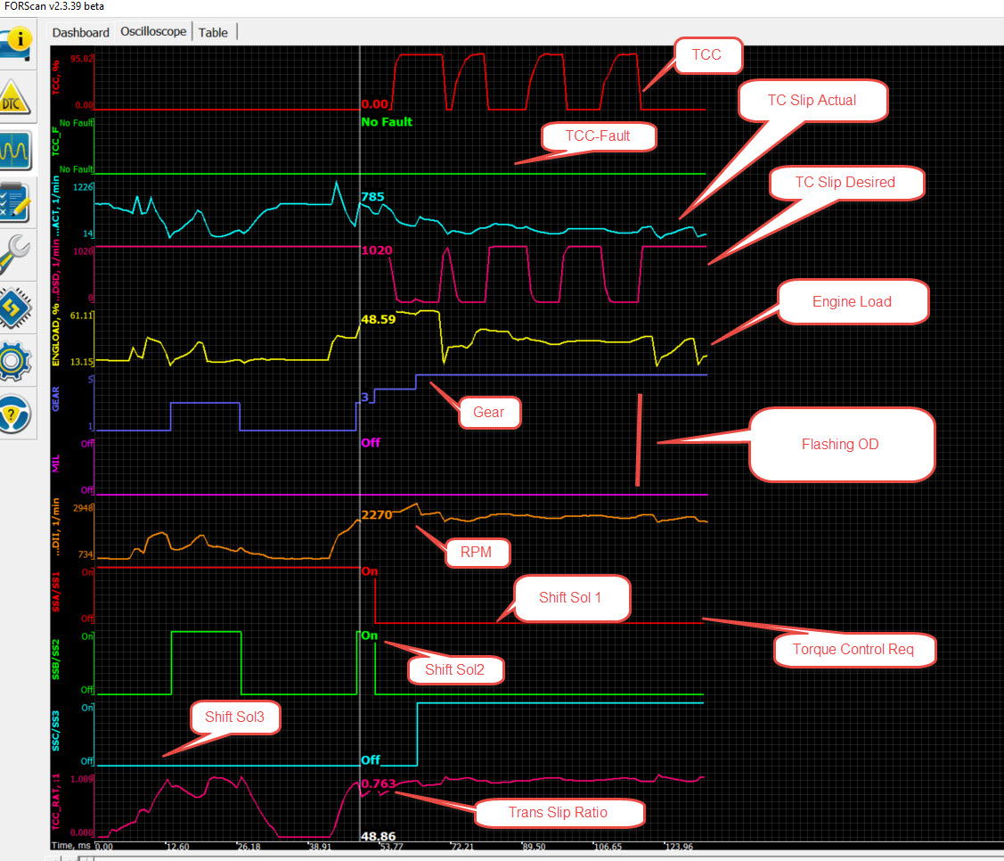

Rebuilt VB installed, Runs/shifts excellent - right up to the TCC lockup fail/flashing OD. Attached is the FORScan leading up to and including the fail. Any hints for you FORScan guys?
