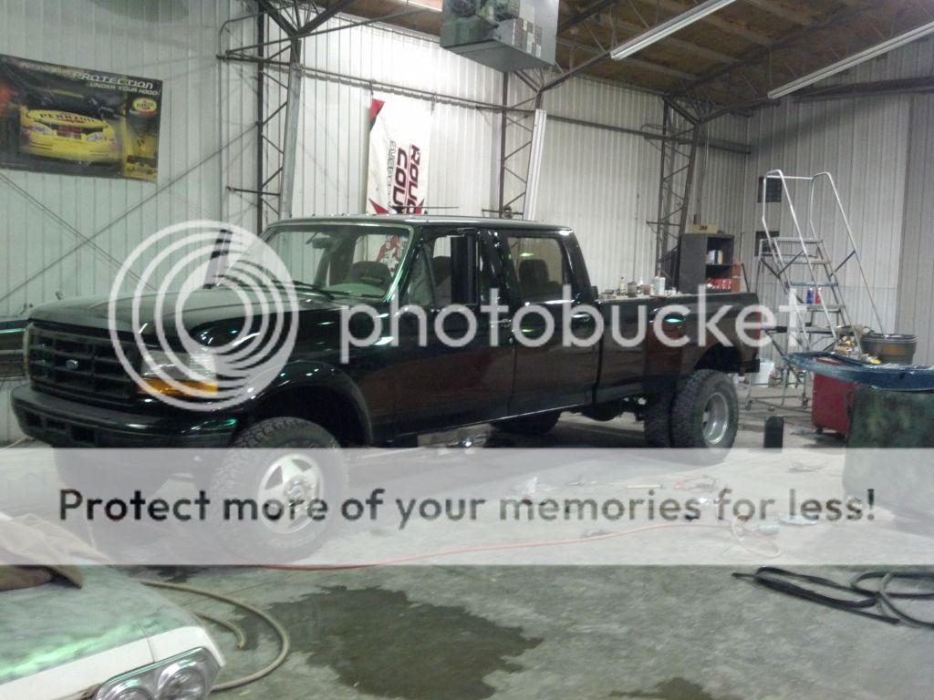

This was a 2wd dually. converted adn on 37s

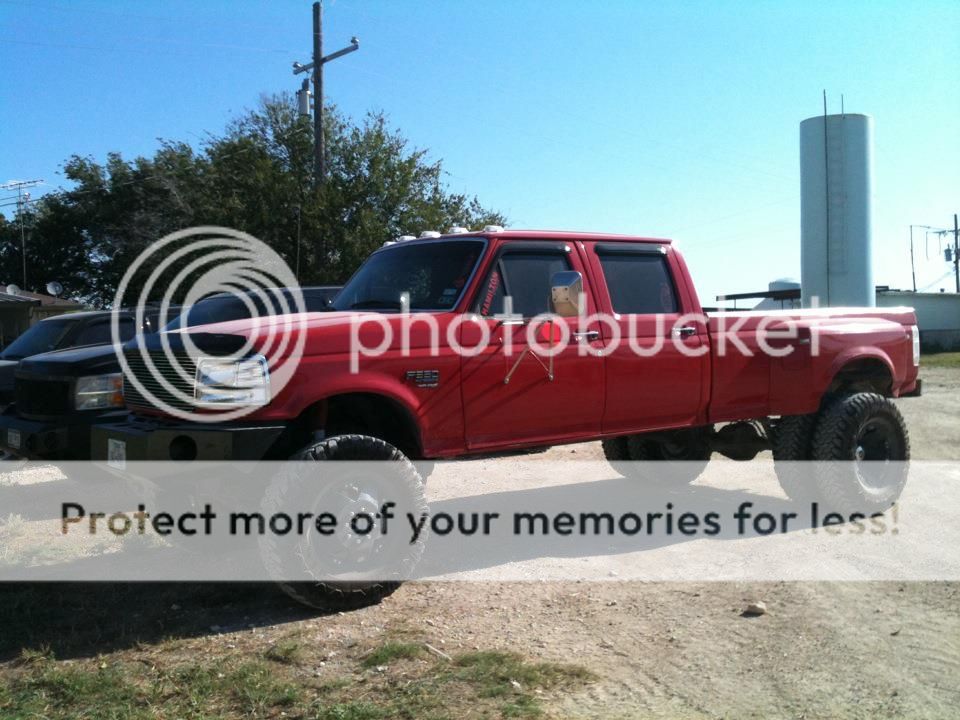

This is on 36s, was a 4wd F-250

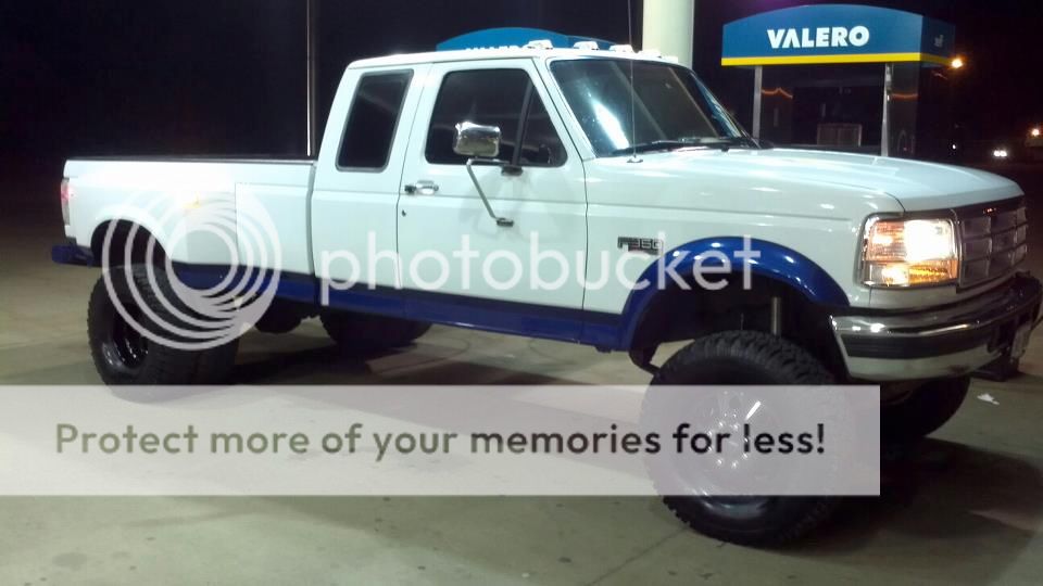

This is on 35s (315s). I really like this one

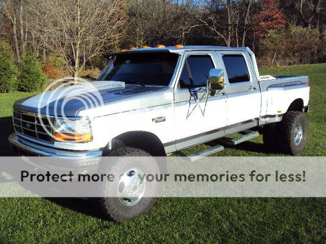

285s... i think
