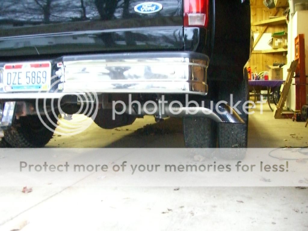

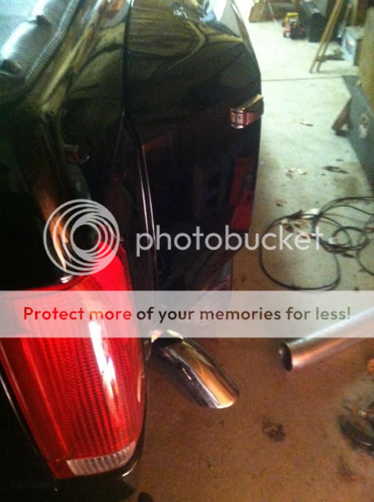

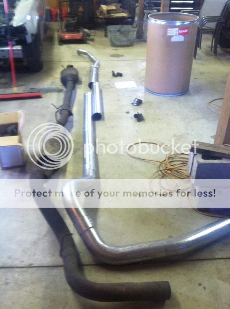

About 2 months later, the stock exhaust was replaced. I replaced it from the turbo back. I gained 1.5 mpg. I also added an intake, no pics though.
I am trying to keep this truck classy. So I added the classic turndown.

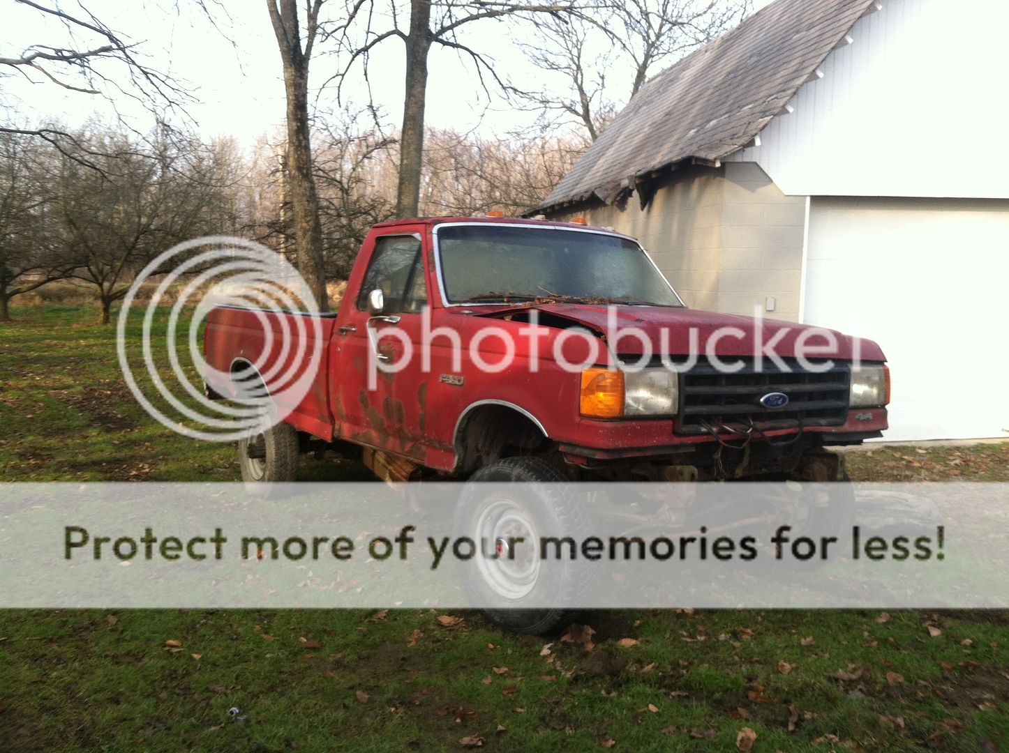

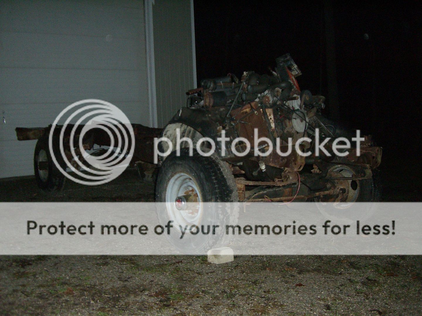

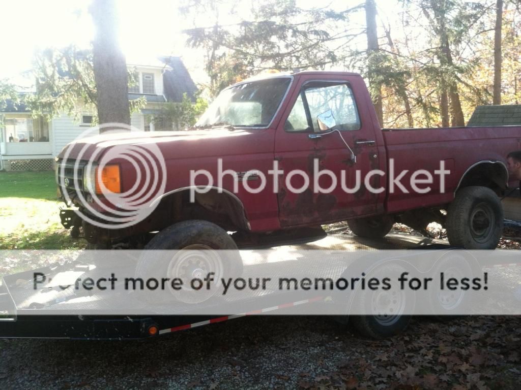

Then my buddy found this truck. He bought it to use it. Decided not to use it. So it was delivered to me for $1000. Its a 1987 F350, 351w, C6 auto. It has been sitting since 2002 and the intake is missing. So it doesnt run. But it rolls. That is what matters. This truck also has 3.55 gears which is a plus. I want to run 305/70/16 tires. About 33s.
Here she is. What a beauty. haha

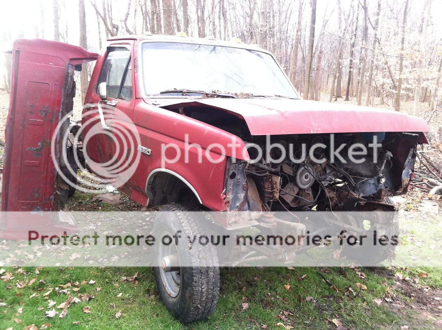

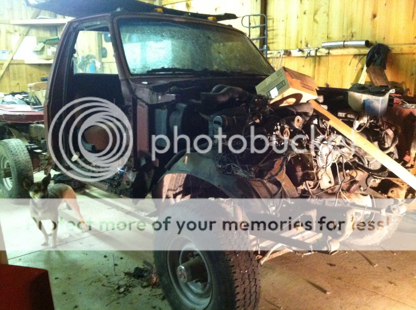

I have been tearing into the truck after my family goes to bed.
After 3 nights, I have removed the doors, front clip, bed and cab. This weekend will be the t-case and trans. I sold the frame to a friend which is why I am stripping it down.

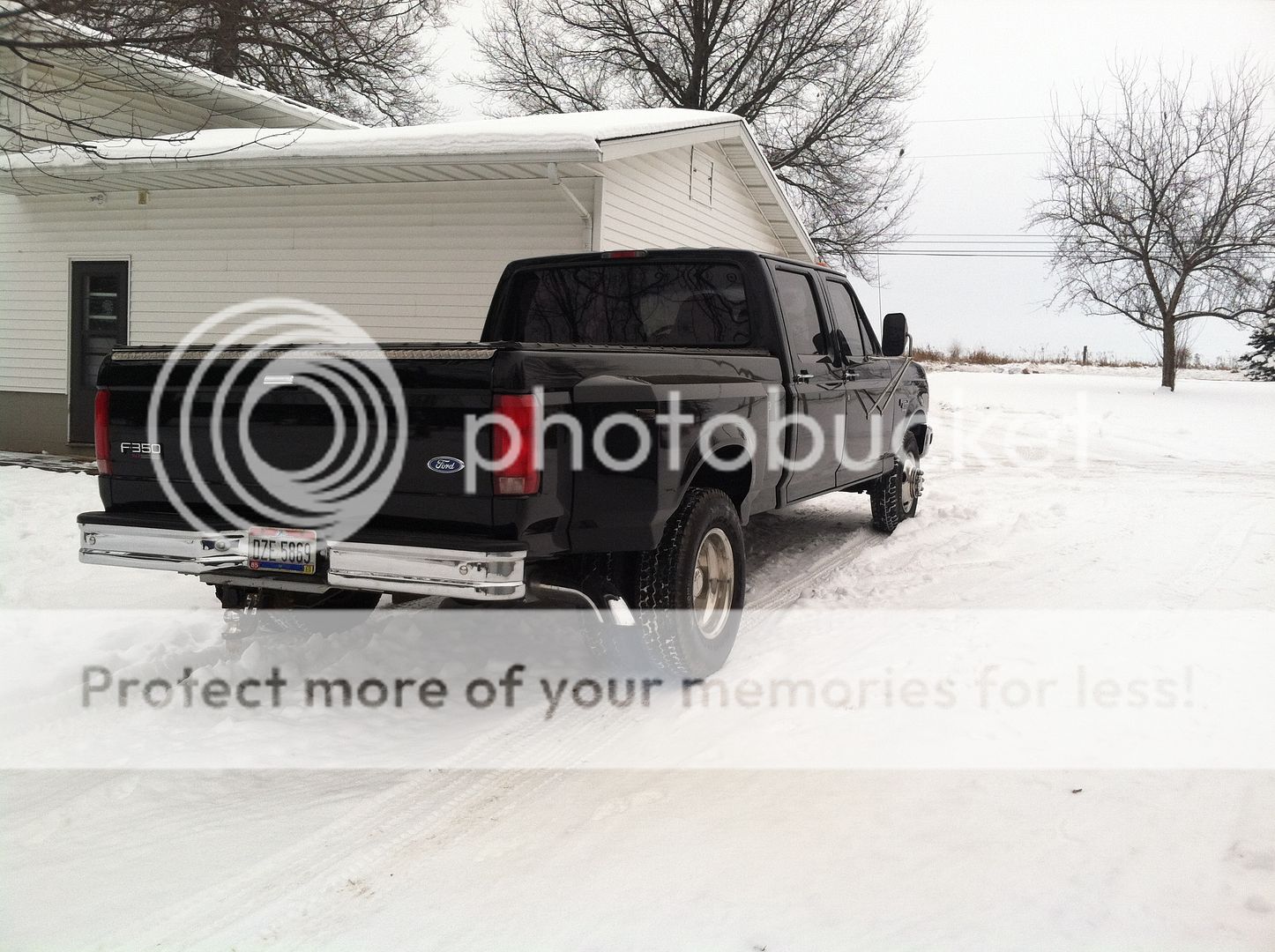

Got some better tires on the front

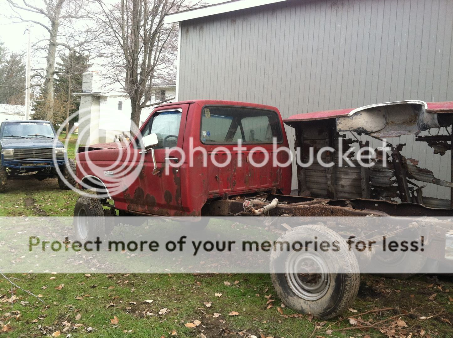

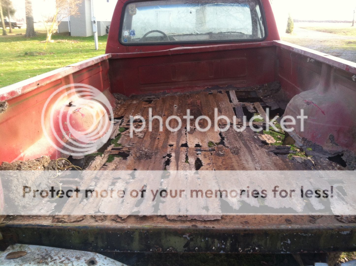

Pulled the plastic bed liner. Whoa

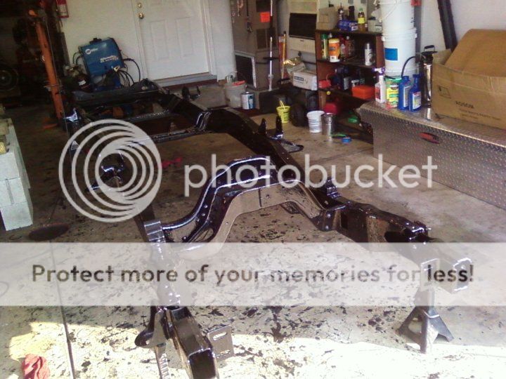

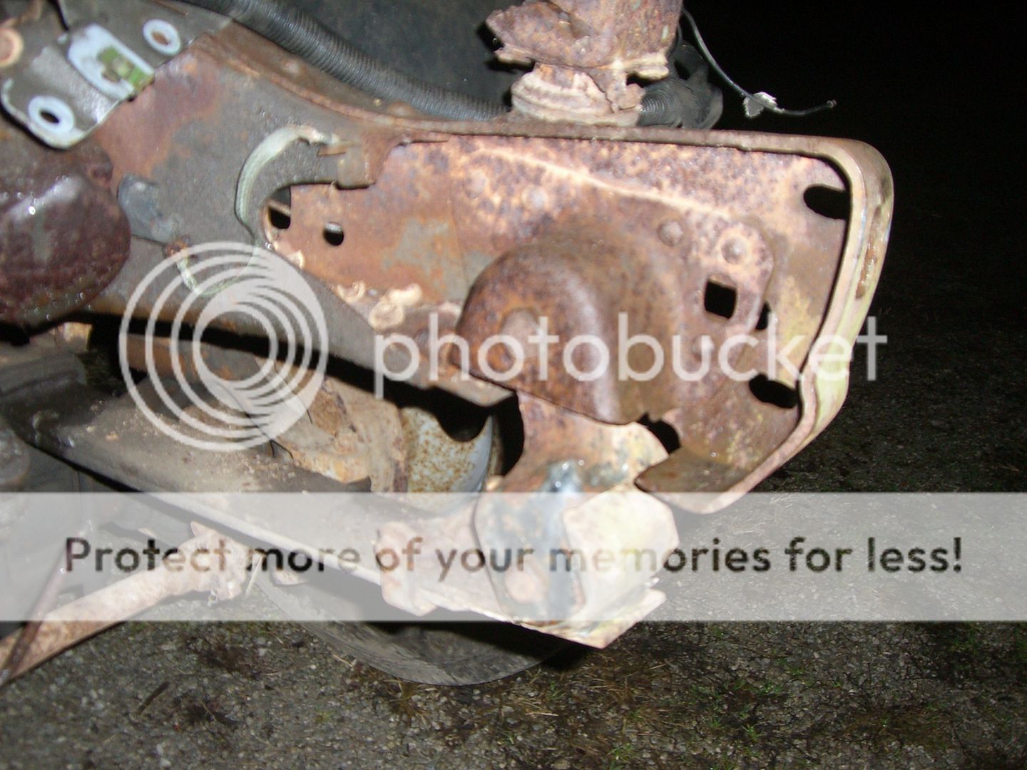

This is when I noticed the frames on this body style are not boxed. This might save me some work.
This is what the frame horns look like on a 92-97 4x4. I took then when my buddy was restoring his 1992 F350
My buddys 93 ext cab Cummins was not boxed either.

As far as frame horns go, can you just knock the rivets out and use the brackets of the donor truck?
-PlumCrazy
-PlumCrazy
As of right now, that is my plan. The rear brackets will be new from Ford.
Those front brackets taht you are talking about are different for the 92+ trucks. I'm sure you could make the older ones work with some trimming. The newer style is made different for the bends in the front by your frame horns. As far as the other stuff goes its all bolt in for the most part. If you drill a few holes you can use all the factory stuff. You do need to run the track bar unless you plan to swap the shackles to the rear of the axle. You get a bad death wobble with out it and the factory shackles. You will also need to use the factory dana 60 pitman arm. the boxes are the same but the dana 60 uses its own pitman arm. I'm seen alot of trucks converted this way with factory parts. When you bolt that inside plate on the fram horns you will have to add a shim to the front shackles against the outside of the frame. The factory 4x4 frames have an indent there where the shackle bolt passes through. Otherwise 2wd and 4x4 frames are the same.
Thanks for the info!
Yeah, i looked at my buddies 92 last night. The front hanger is much different than it is on this 87. Like you said, on the 92+ the frame walls are indented on both sides and the shackle goes through. I have no idea what my 97 2wd frame horns look like yet.
I am also tossing around the idea of running the shackles at the rear and 'fixing' the front. I dont know what will work since I have not looked at my truck yet.

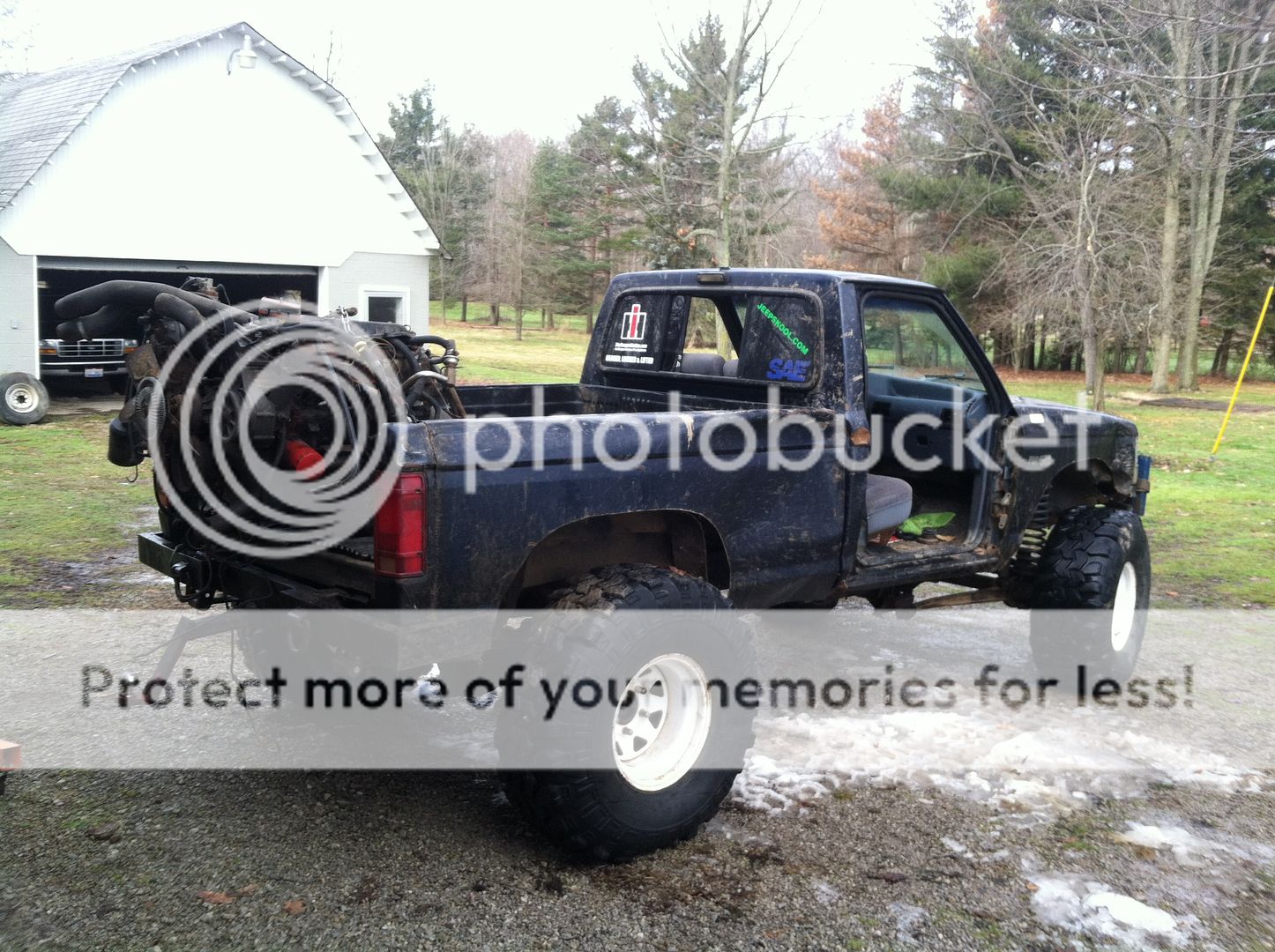

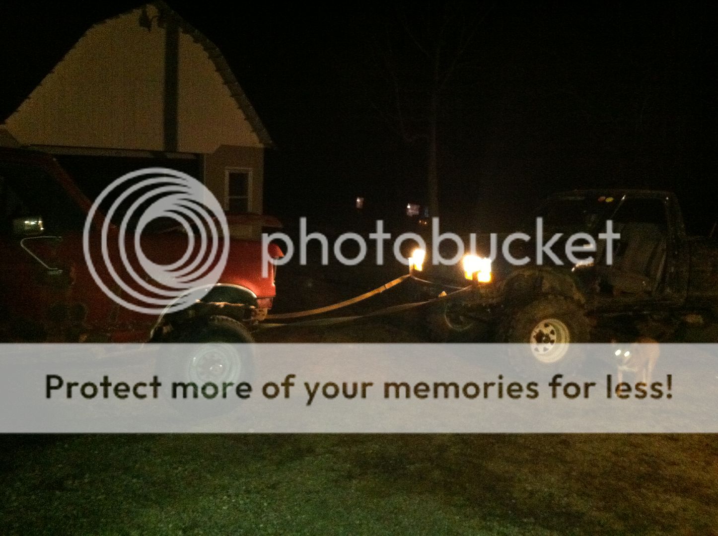

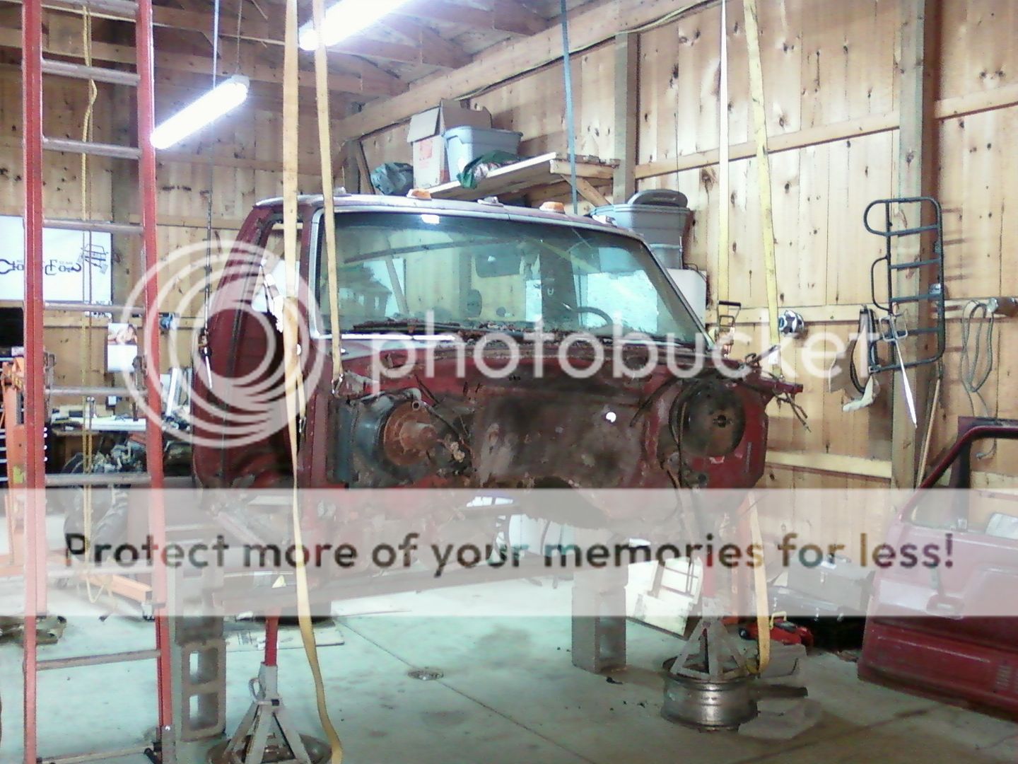

Got the cab out of the garage. Lifted it with ratchet straps hanging from the rafters. Then dropped it on the ranger to store outside until I make a scrap run.

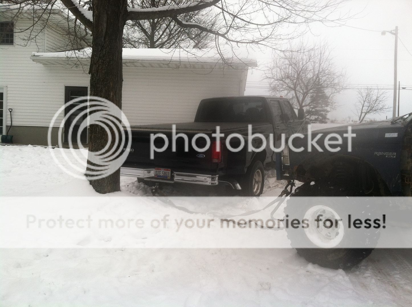

Then I got stuck haha. Another reason to do this swap even though I do not drive it in the snow.

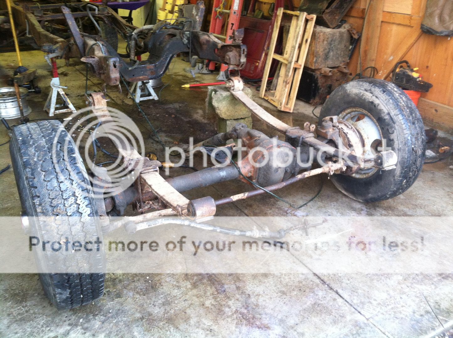

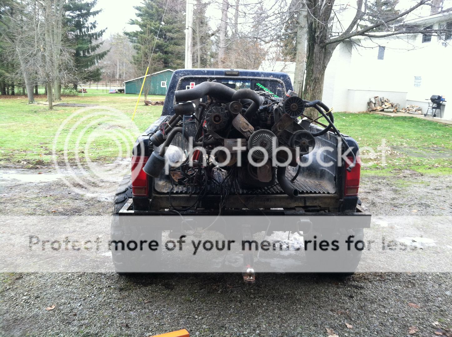

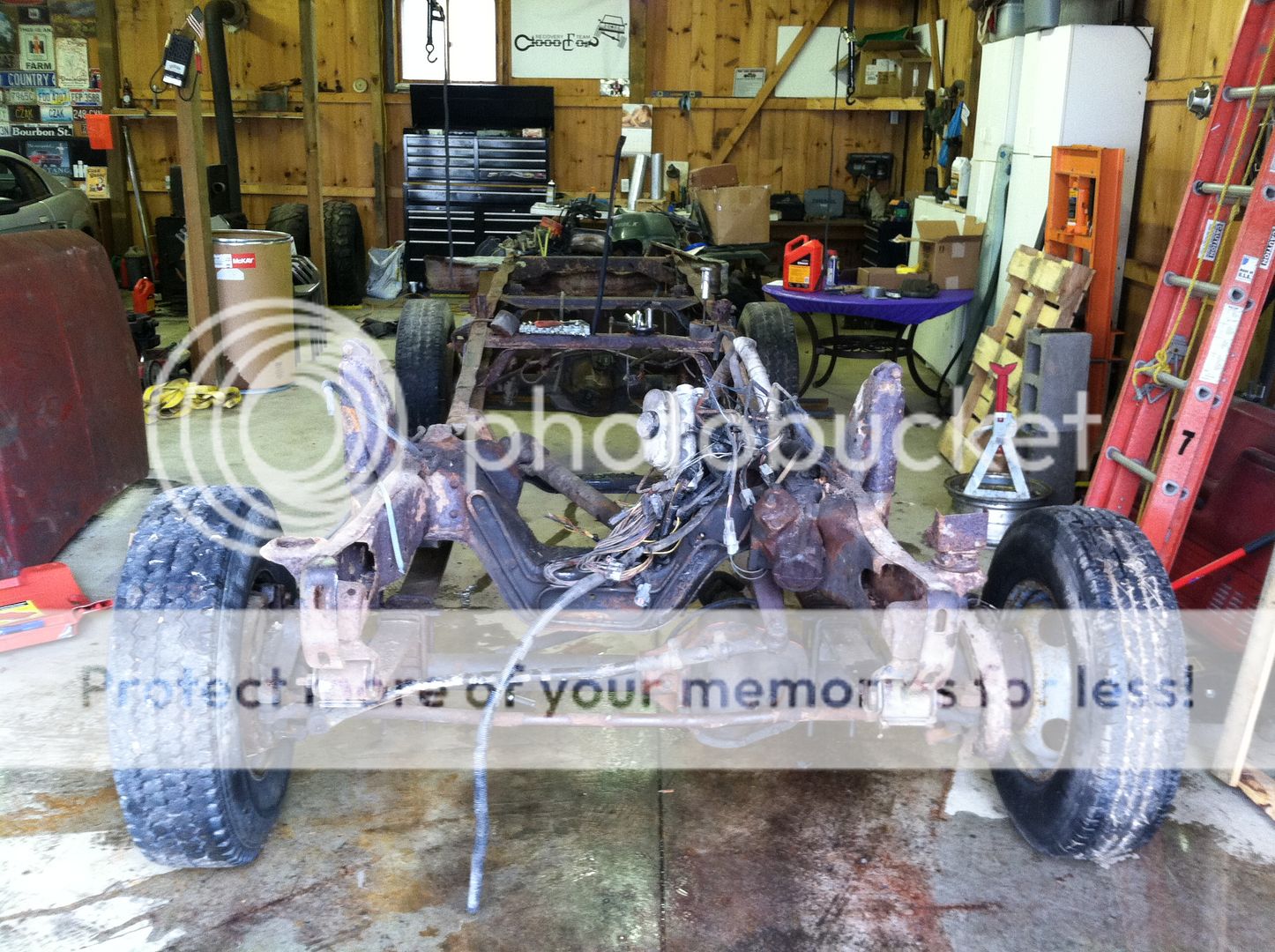

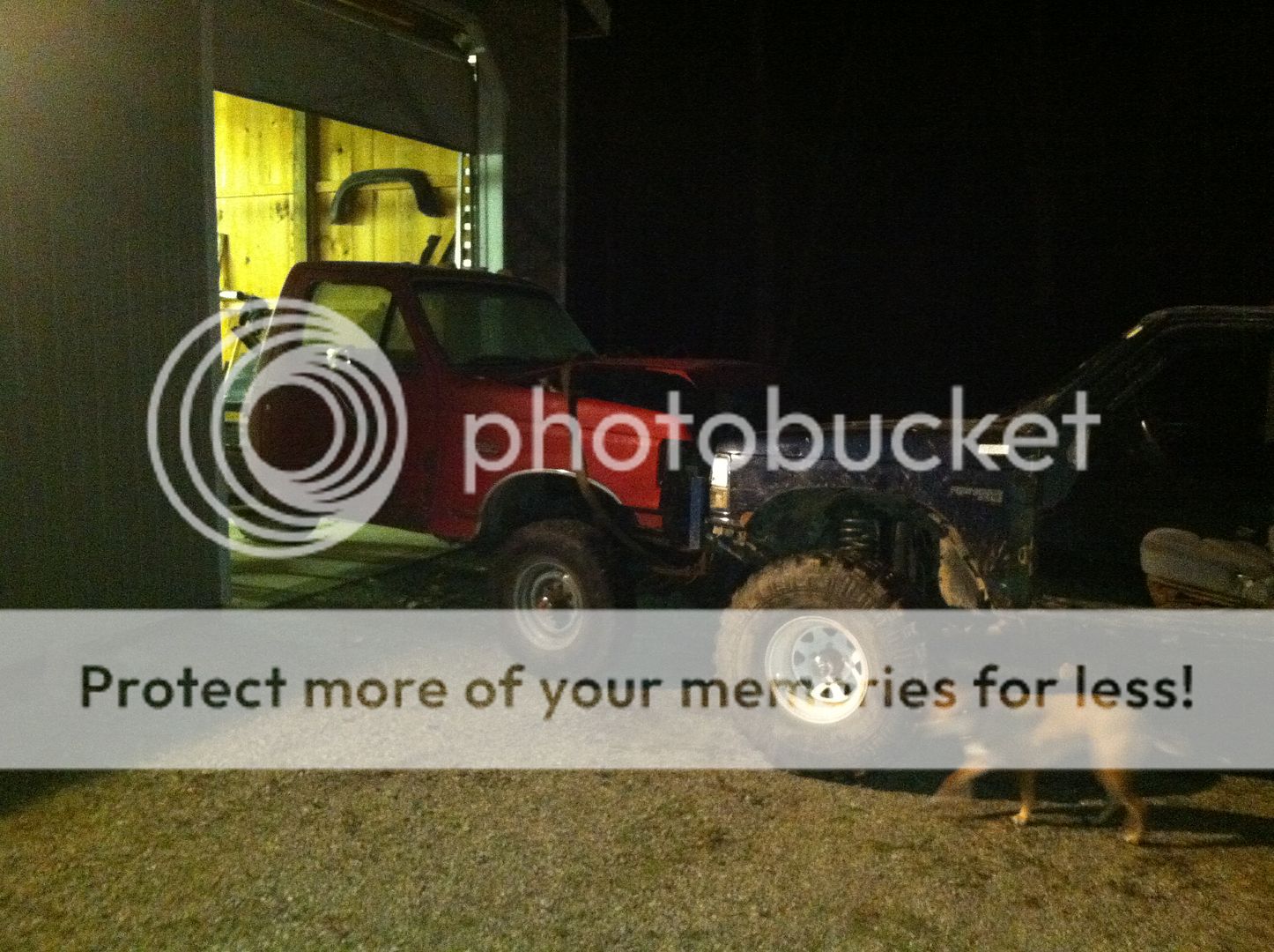

Got the 351W, C6 and front axle out. I ran out of cut off wheels so I will have to pull the rear axle and front springs at a later date. I am trading the track bar and front leaf springs for dually outer hubs. I still want to run a radius arm setup. We will have to see how much I get or owe uncle sam.
