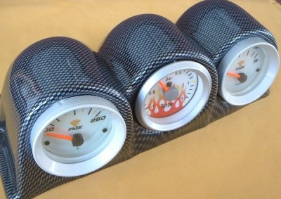

I used a spare Radio bezel i had sitting around. I bought a cheap 3 gauge pod off ebay (APC universal pod -- $11 shipped):
