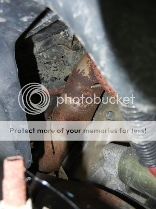

pretty tight. the down pipe was made out of the original pipe, just cut up and welded to the angle i needed. its a little rusty and the turbo got all pitted, only part that sucks about living next to the ocean.
