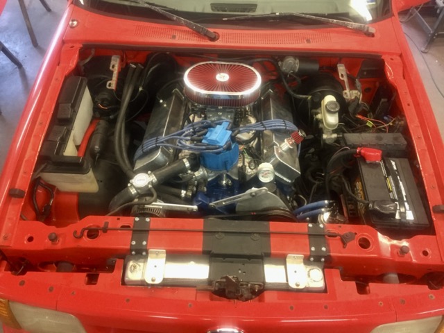

We've seen people put 4.6L V8's in those Rangers which is a pretty big engine.
www.therangerstation.com
The 460 is 2"-4" longer than the 4.6L and 2"-3" narrower. Physical Size Comparison (Approximate):
Here's one in a 1994 Ranger:
A 1993 Ranger:
Obviously, it's going to be different with your setup because the suspension and steering is different, but it's doable.
I would look at these so you understand what's involved in doing a V8 swap in that style Ranger:
Explorer 5.0 Swap In A 2000 Ford Ranger
Install – 2000 Ford Explorer 5.0 Into 1998 Ford Ranger
Explorer 5.0L Swap Into 1998-2011 Ford Ranger
2000 Explorer 5.0 To 2009 Ford Ranger V8 Swap
The Ford 4.6L (281 CID) Engine - The Ranger Station
Have you ever thought of stuffing a Ford 4.6L engine into your Ford Ranger. Here's some information that you may find helpful.
- Length: The 460 is slightly longer, at roughly 32–34 inches, compared to the 4.6L's 28–30 inches. (5.0L Explorer is 27.5")
- Width: The 4.6L DOHC is actually wider or comparable to the 460. The 4.6L DOHC is approximately 30 inches wide (valve cover to valve cover), while the 460 is roughly 27–28 inches wide.
- Height: The 460 is generally taller than a 4.6L SOHC, but comparable to a 4.6L DOHC, with both sitting around 26–30 inches high.
