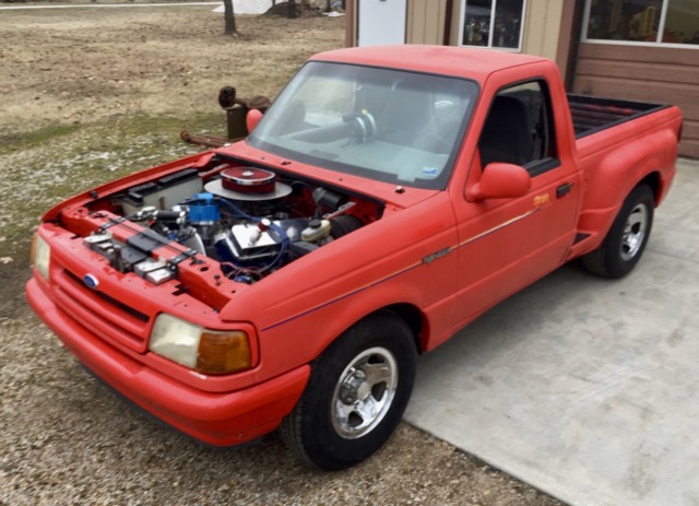

I want to thank everyone on this board that has posted information to help me build my Ranger project. My intention for this vehicle is to participate in Hot Rod Drag Week this fall. I do not know if this will happen but I built the truck to their rules to run in the street race non power adder class. This class does not allow for the firewall or floor to be modified and made this swap more difficult. I have just started driving the truck this week. There are a few little problems but overall things seem to be going okay. It is perky.
This week I am building the cowl induction hood.
466 cubic inch, C6, 373 Explorer rear with my own cal trac style traction bars, custom made wide rear wheels, drag radials.

Love it!
But how the ever loving shit did you fit a 460 without firewall/floorpan mods?
Thats gonna be one hellacious sleeper.
Yes @wz junk , Inquiring minds want to know how you managed to stuff that in there.
In order to instal the 460 without modifing the firewall or the floor, I had to do some things that you would not normally do and are not good practices. The engine is slightly offset. Thats not really unusual though as many factory engines are not centered. The engine is also at more of a tilt than you would want in a normal swap but I had to set it this way in order to go under the floor and over the front suspension and frame. The engine is also skewed slightly to the right at the front so that it clears the steering shaft. Time will tell how this will affect things like universal joints and vibrations.
I made the center section of the core support removable. This is the only way that you have enough room to get the engine in and out of the engine bay. Fact is, there is not enough room to instal the engine with the fabricated valve covers on the engine. Everything is very tight. They were many little things that took a lot of time. The hood latch took about 3 days. When you look at it you would wonder why it took so long. The radiator is in front of the core support and the lower part of it is between the modified frame horns.
I used the original transmission crossmember by cutting the rivets on the factory brackets and moving the brackets forward, then drilling holes and bolting them back in place. The center section was changed to accommodate the c6 transmission mount. I used a Winters floor shifter. The original speedometer cable is connected to the transmission by using a later model c6 speedometer drive. (it works now but I need to buy the correct gear so that the speedometer reads correctly).
By installing all the original senders in the 460, all the gauges in the dash work. I do have a redundant gauge panel under the dash.
I removed the original electric fuel pump from the tank. I used the mechanical pump on the engine. Most of the fuel system and lines were hand fabricated for this application but I used the factory tank with the fuel level sender.
The rear end assembly is an Explorer unit with Explorer springs. I fabricated the the lower spring plate and lower shock mount. The axle tubes were welded to the center section. I added air shocks. The change to 4 wheel disc brakes did not require a change of the master cylinder but I did defeat and eliminate the anti lock brake system.
You might note that I have a heater as I plan to drive in cold weather. I removed the air conditioning heat exchanger and modified the plastic housing by fabricating a fiberglas cover that will allow it to work and clear the right side valve cover. A simple thing that was a lot of work.
Lots of other stuff. If you have specific questions, I will try to answer them. Note that I am 70 years old and it has taken me the last 6 months of on and off work to do this swap. I was motivated by the naysayers that told me it was not possible.
Today I will work on fabricating the fiberglass cowl induction hood scoop. Then I plan to drive it some more and critique (road test) my work. Tomorrow my new front springs should arrive, after they are installed, I would like to take it out on the interstate.
We need some more in depth pictures and measurements. It looks good. From what I can see in the picture above. I'd like to see headers, exhaust, motor mounts, little factoids like that.

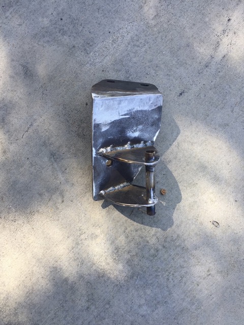

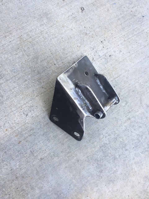

I have some photos of the mounts. I fabricated a bolt in mount using part of the original 4 cylinder mount on the frame and the factory 460 mount on the engine. I am not happy with my welds. They are probably functional but not pretty. I plan to remove them and redo the welds. I decided to use factory cast iron manifolds instead of headers. You have to make some choices on a project like this and I did not think that the benefits of the headers were worth the effort. The right side is a truck manifold.
The engine started life as a 1969 429 Thunderbird but it is now a 460. It has a Edelbrock Performer intake, a 750 Holley carburetor, and a Lunati cam and valve train parts.
