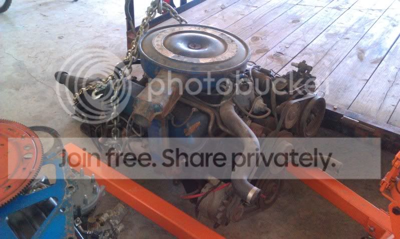

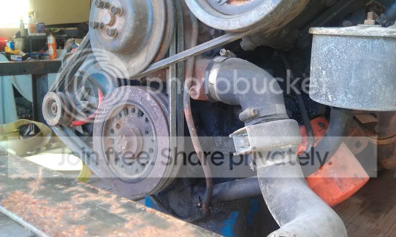

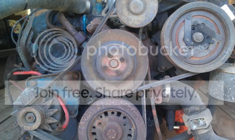

Hopefully I can start my 460/C6 swap into my '93 this week.

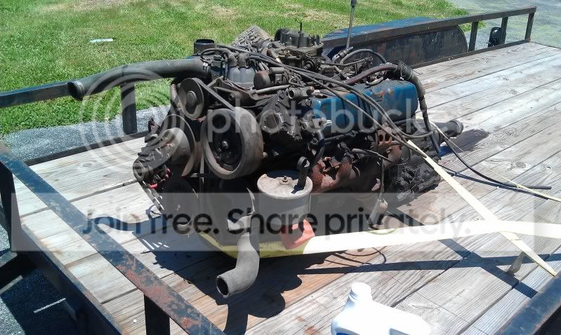

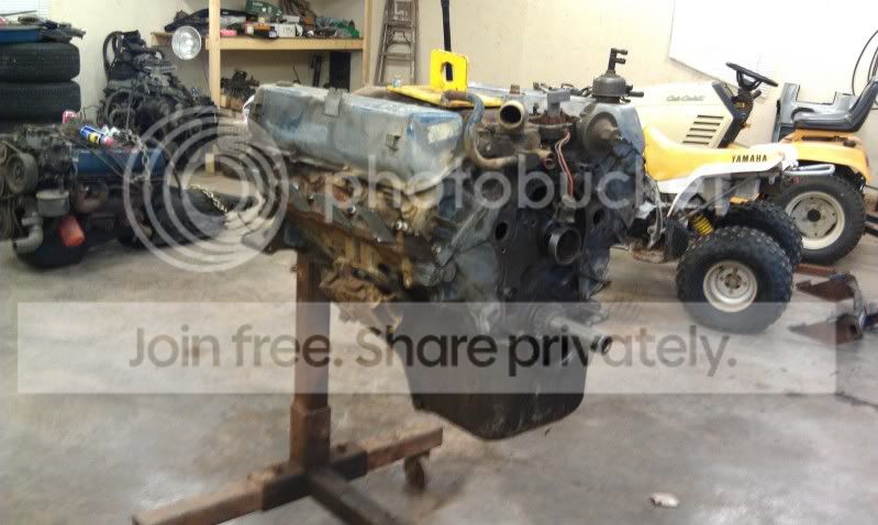

I have two 460 motors, one than runs from a '70 Lincoln and the other that doesn't run from a '69 Lincoln. I bought the '69 motor mostly because of the complete FEAD on it. It has a short style water pump (there is no crank pulley, the belts ride in the balancer) and the crankshaft mounted power steering pump that I'm thinking about trying to use. The '70 has alternator and power steering brackets on it, but they are from another engine family and the belts don't line up perfectly like I want, but I may be able to get them to work. Another option is to sell the FEAD and timing cover from the '69 (big $$$ from what I've read) and use that money to buy the right brackets for the 460 and use the standard power steering pump.

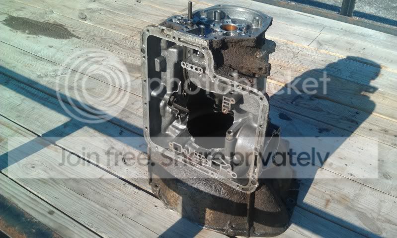

I brought my C6 to the transmission shop and he emptied the case for me. It's a lot easier lifting an empty case into place for the mock up than a full one, especially since I may need to do it several times.
The plan is to get the motor mounts done using the empty transmission case, then bring the case back to the transmission shop for him to rebuild it. Then paint the motor and swap a cam in it and throw a Stealth intake on top.
Anyway, here's a few pics of the trans and the '69 motor to look at for no productive reasons whatsoever...

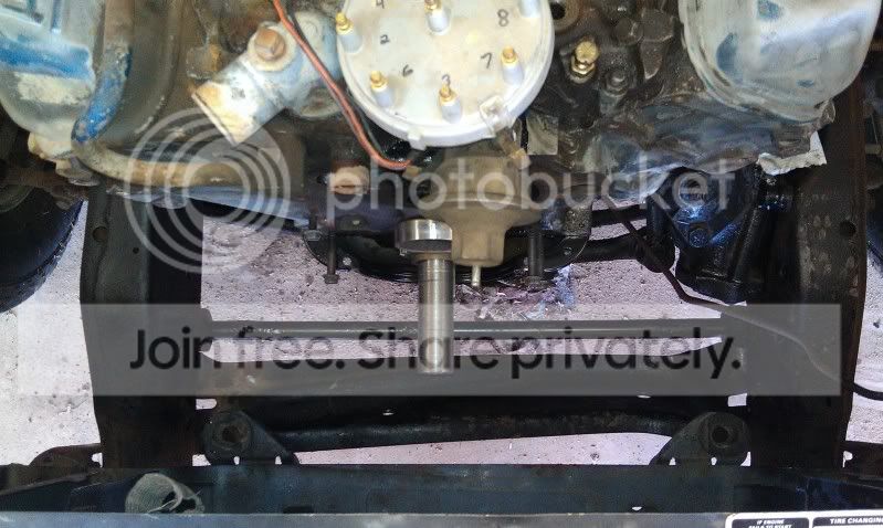

Is that the power steering pump behind the harmonic damper?
Yes, it slips over the crankshaft and bolts to a special timing cover.

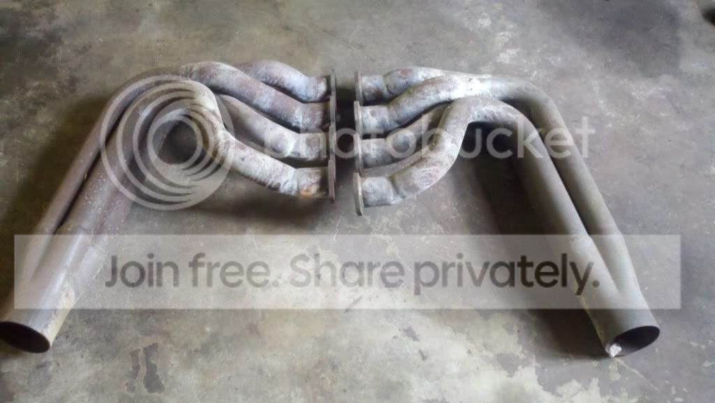

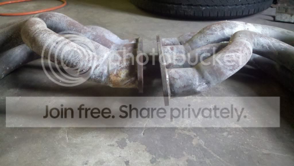

snapped some pics of my headers today while i was in the shop with my phone. they are not pretty yet and the stuff thats on them is OSPHO a rust neutralizer. i didnt want to ge them all ceramic coated and find out i hav to tweak them a little more in the future.
anyway these are heddman weld up headers for a BBC then i got some BBF header flanges. they are 2-1/4" primary tubes with a 4" collector. in order to go over the frame i had to make little 45* pieces that will make the primarys go straight off the head to clear the frame, my motor is set down low as possible in the frame. since im running fully hydraulic steering i dont hav to worry about going around a steering box. the way i built them the collector is about 3-4" away from the cab mount under the front of the doors with as a downswept header and with a slight angle-out. took me by myself about 1 full day per side after i had all the 45* pieces cut (i just got a piece of tubing bent and cut off little sections of it).
both headers together. youll notice one is narrower than the other, thats because i had to shift the motor to the passenger side to get the valve cover to clear the steering column.
460 swap
here you can see the flanges with a little 45* pieces.
460 swap
wish i woulda took some pics with them on the truck, IMO they look freakin awesome. during the short time i was running the motor i realized that these are VERY loud. definatly not suitable for street use.:icon_rofl:

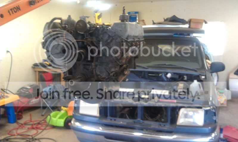

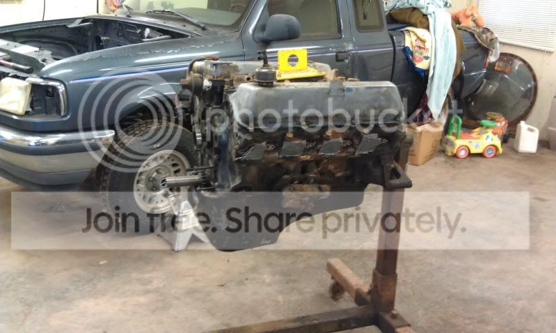

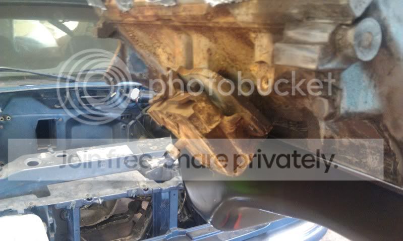

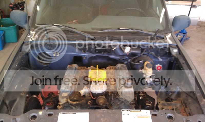

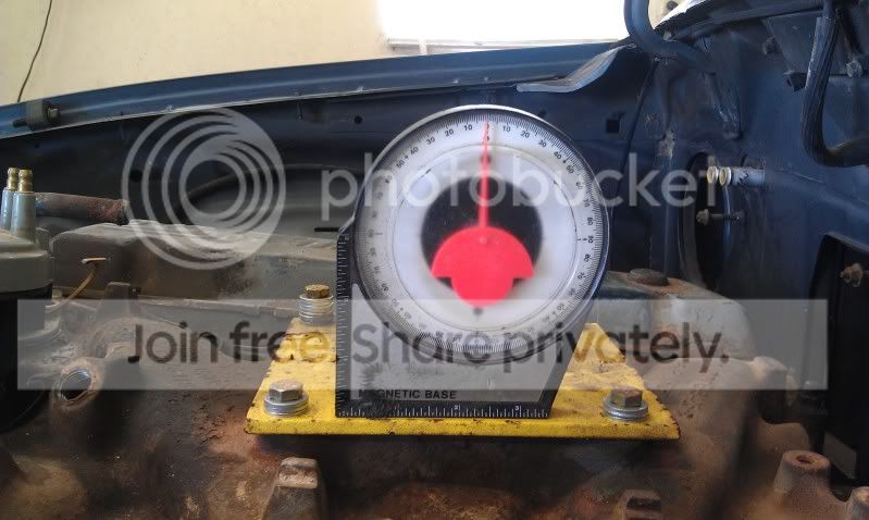

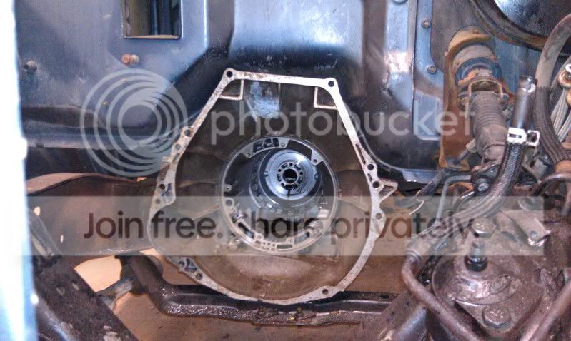

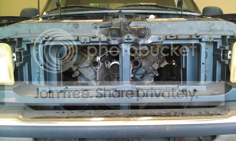

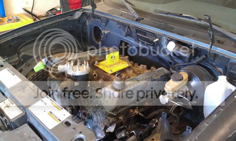

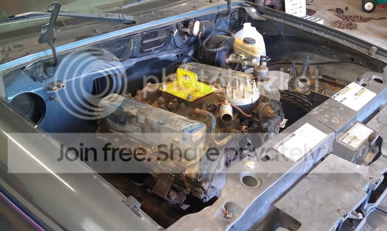

The motor mounts are going to be easy for this. I've got the motor sitting as far back and as low as possible. The right side top transmission bolt was touching the firewall. The left cylinder head was touching the firewall. The oil pan is about 3/4" off of the I-beam. When the final motor mounts are done the motor will be moved away from the firewall about 1/4". The left cylinder head is 1/4" from the steering column where it comes through the firewall. The motor sits about 2.5" off center toward the passenger side.
The motor mounts I'm using are 460 swap mounts for putting a BBF into a late 70's F250. They consist of a steel plate that bolts to the block and a rubber mount that bolts to the steel plate. The rubber mount has a threaded stud just like the stang 302 mounts.
I'm thinking a thread-on oil filter adapter will fit between the block and power steering box, there is about 1.5" of clearance there. The #8 header primary tube will be tight because it's pretty close to the steering shaft. I'll have to swap the shaft for something else.
Taking rough measurements, the 460 isn't much longer, if any, with the FEAD than my Crown Vic motor with it's FEAD. The Crown Vic FEAD is a fairly thick package though for a 302.
The transmission will NOT fit if trying to install it from underneath, there is not enough room between the radius arm mount crossmember and the transmission tunnel/firewall. Rather than making the crossmember removable I just dropped the transmission in through the engine compartment and that worked just fine.
Overall things are going great!

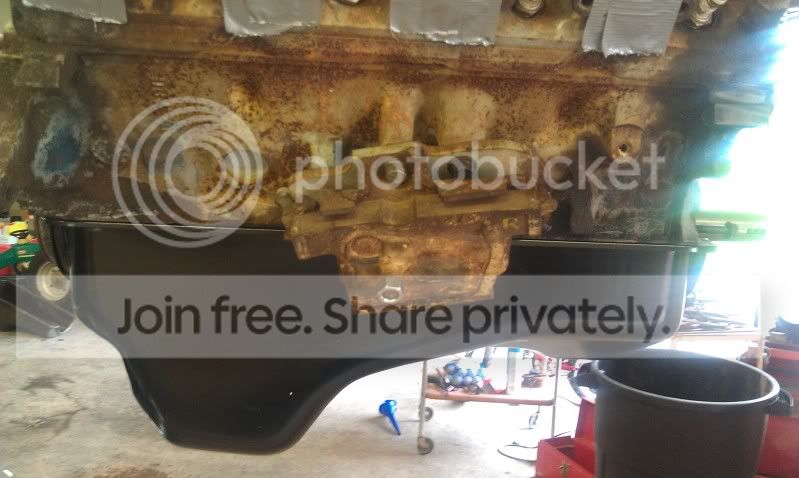

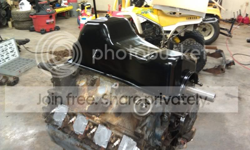

New oil pan
460 swap
