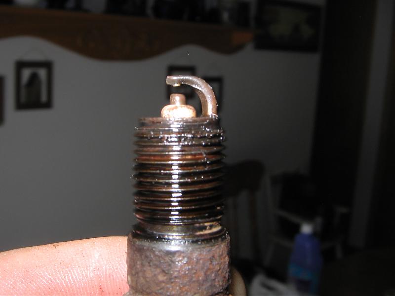

a month ago i was havling a #4 cyl misfire, and random cyl misfire cel codes.. it ended up being the #4 plug was part of the problem, it still sparked, but it must have been weak or something. so i replaced the plug, and it ran good for awhile.
yesterday i had the same poor running misfire condition, and the CEL came on saying #4 cyl misfire.. while trying to figure out the problem last time, i swapped the #4 injector with #6, i also replaced the upper intake gasket, and the o ring in the egr tube. but the intake manifold was dirty scummy nasty, especially around the egr tube.
my only thought is that the egr is bad or something and contaminating the #4 cylinder since its the closest one to the tube. i really dont know what the deal is. idea?
thanks

Are those crusty white deposits?
As in, burning coolant? Are you consuming coolant?
The EGR will not introduce slime into the intake. But the PCV valve might. Oil slime doesn't explain the crusty white deposits.
And that doesn't look anything like a month old spark plug.
And you might want to do something about that valve cover leak. You don't want your vehicle tracked by smell, do you?

i am consuming a slight amount of coolant, but i had a small leak at the heater control valve, and i replaced it multiple times--but the new valves developed leaks within a few weeks. i posted about it, and people basically just said the valves suck. i ended up putting some pipe in so it constantly feeds the heater core, but i just noticed today i have a slight leak from one of those connections..
the spark plug was a spare old plug from a tune up last year, i threw in to test last time i had the problem, and it ran great-- so i didn't replace it.
so you're thinking i have a head gasket leak into cyl #4 causing the plug to foul out?
and you say replace the valve cover gasket because you saw all the junk on the spark plug threads?
IF those white crusties weren't there when you put the plug in, you either have a head gasket (or head!) leak, or that new lower intake gasket is leaking. I believe there is a coolant passage next to #4. You can tell the difference with a leakdown test -- pressurize #4 to 100 PSI at TDC/compression with the rad cap off. Bubbles in the rad neck point to the head or head gasket. A blown lower intake gasket will pass a leakdown test because the intake valve is closed.

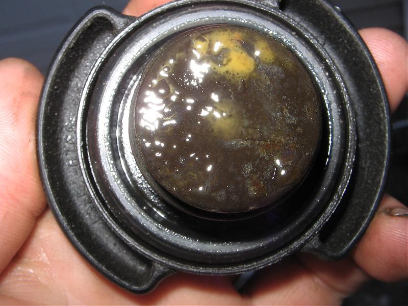

How does the oil cap look?
Yes, oil all over the spark plug threads is a strong indicator of a nasty and fresh valve cover leak.

im pretty sure thats mostly wd40 overspray on the plug, i was thinking of removing the egr, so i sprayed the bolts and stuff.. i probably hit the plug wire and it traveled down.. i do have an oil leak on the front of the engine, so maybe its the vc and it leaked back.
btw i replaced the upper intake gasket, not the lower.. the lower was done 30k miles ago by the dealer before i bought it.
oil cap was a little gooey.. the dipstick looks good. coolant loss is very slow. i also only drive the truck a few times a week now.
the truck dosent seem as fast as it should be for having 4.56 gears.. the jump from 3.27s to 4.56 wasn't as great as i though it'd be.. so maybe a head gasket is going.. the truck seems to over cool sometimes too, if i'd just coasting down a big hill on the highway or something, the temp gets down to like 150-160.. but going up a big hill it can get up to about 210

I wouldn't quite jump at the boat anchor answer, but I don't like the looks of that oil cap.
There are other leak sites besides the head or head gasket that can get coolant in the oil. Particularly the lower intake gasket, as that can also get coolant in #4. The front cover can also leak coolant into the crankcase.
