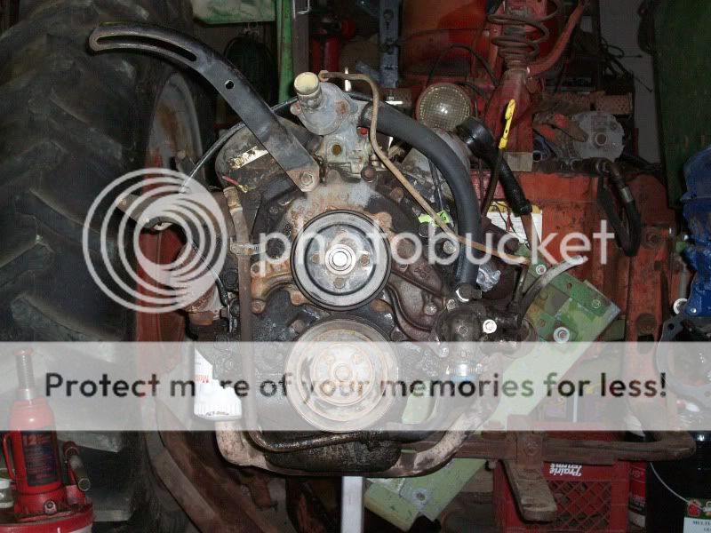

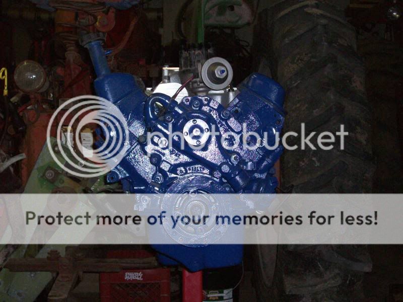

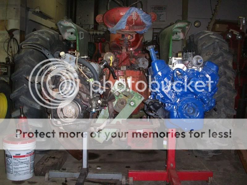

60 degree 2.8 (basically the same on the outside as a 2.9), and a 90 degree 302 on the right. The outside of the heads are angled which helps with fitment and throws off the look of the 90 degree engine a little, but it is 90 degree.
