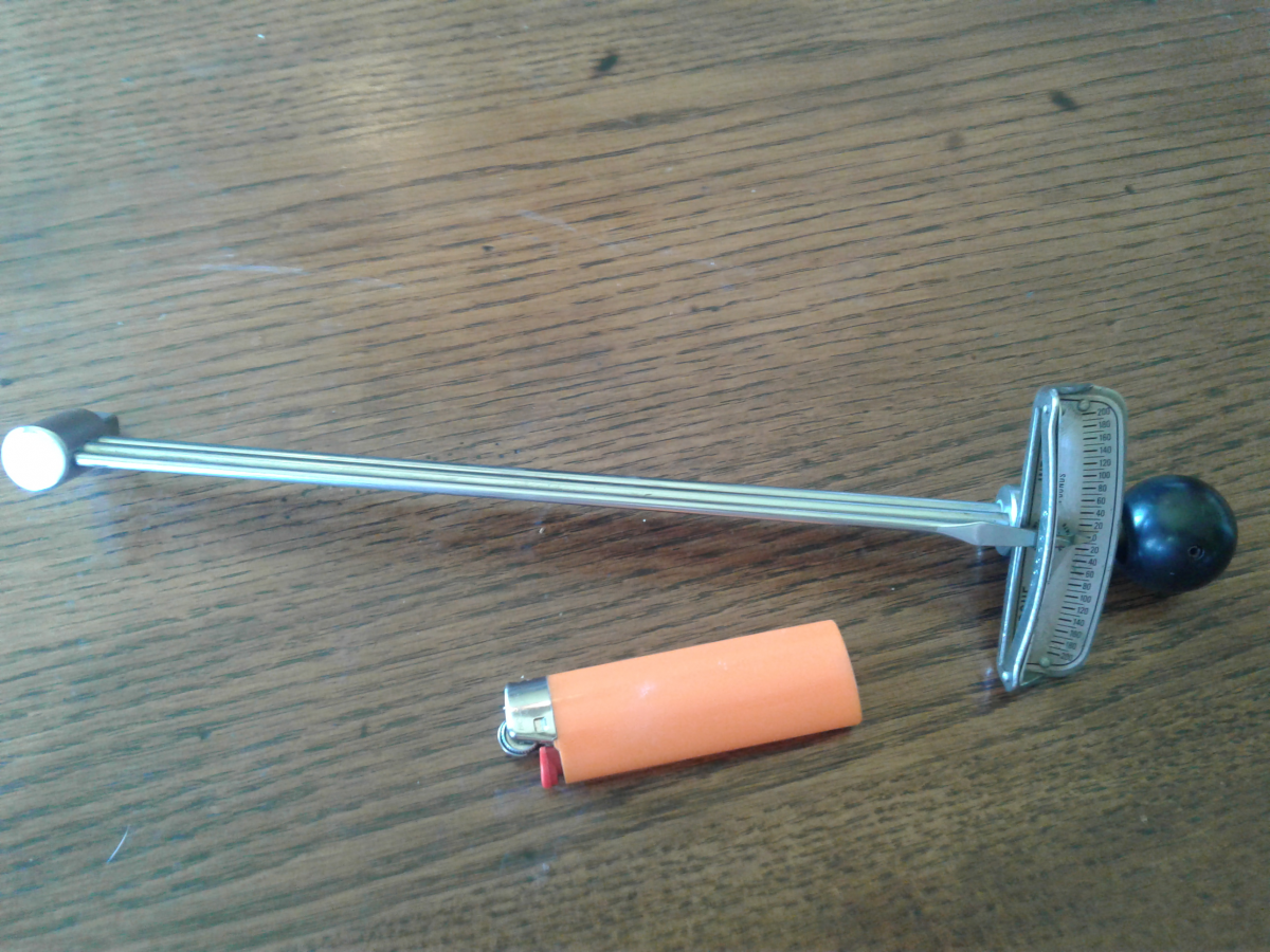

I used a beam style torque wrench. Just a few bucks at local auto parts store.
So what I did for preload, is just get it tight enough to have a slight resistance when turning by hand. Inch lbs is very minimal and I use an inch lb torque driver at work for setting battery caps on our air packs. Basically 15 inch lbs is what you can tighten a screw to, using your thumb and index finger while pinching a screw driver handle with straight fingers, not having your fingers wrapped around the handle. If that makes sense.
I've never seen them in inch pound though. I have a beam style but it starts at like 20ft lb.
I have one... probably the least used torque wrench in my box. I bought it for a couple jobs and one of them was setting up rear ends.
60603
The one I have is a 1/4" drive, inch/lb. Only issue I had was I needed a 1/2" drive socket.
Same here. I had to "reduce it up" to 1/2".
Im searching the Amazon for one right now. Dial torque wrenches are just too damn expensive. I never thought beam styles existed that small so figured I was stuck using my clicky inch pound torque wrench and alot of prayers. Thanks for the heads up you non gender specific term for humanoids to which I show appreciation in a non threatening manner.
Mine is a Matco DR200-1
mine is intended for bicycles, small aluminum nuts.
problem is it takes 10 ft lbs to get the adapters moving! :icon_thumby:
I have magical powers to make a pinion nut socket 1/4" drive without adapters.
