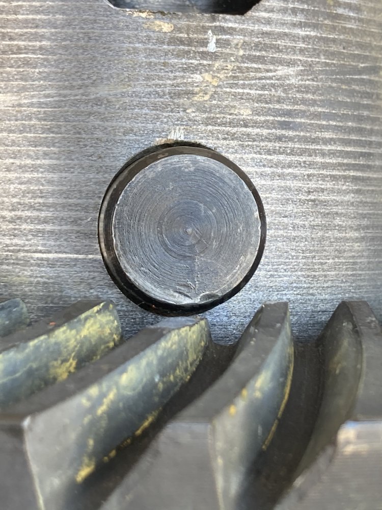

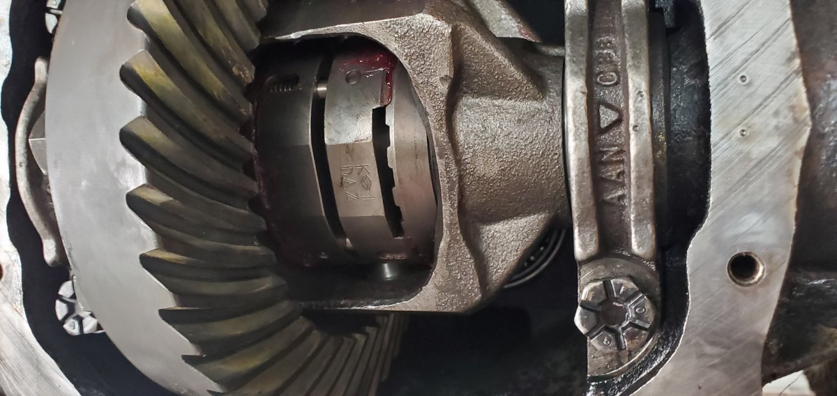

4.56 gears in a 7.5 with a lockrite
I would much rather see the c clips eliminated than the ring gear ground down.
The ring gear grinding is so that the cross pin can be installed. It has nothing to do with c-clips.

I don't know if that kit will work (probably have to call Moser to verify that it will) but you still will need to grind the ring gear.

Already ground the ring gear. This is a good point about parts, I really didnt think about that. I am going to go through the set-up of the lcoker again and make some more measurements and see where I am at. I'll post back with my ridiculousness.
I had to grind the ring gear on my 8.8 too. I found it was easier to install the C-clips in my 8.8 by having the rear end on jacks, pulling the shaft into the housing with the toes of one foot and putting the clip on prior to pulling the wires holding the small spring loaded pin in the locker.

In a 7.5 I am guessing you will have to with 4.10s - although not too much. Keep us posted.
If the C-clip almost (but not quite) goes in, I'd say just sand or grind the clip a little bit thinner (not more than about 15% or so thinner though).
Seems I've also seen C-clip kits that give you several different thickness clips... That might be another option.
I'm an idiot....dirp. I took everything out and re-did the install. After I got everything in I realized that previously I had been trying to wedge the clip inbetween the teeth of the locker. All I had to do was utylize the flat section of the driver and it went right in. BWhahahahaha!!
