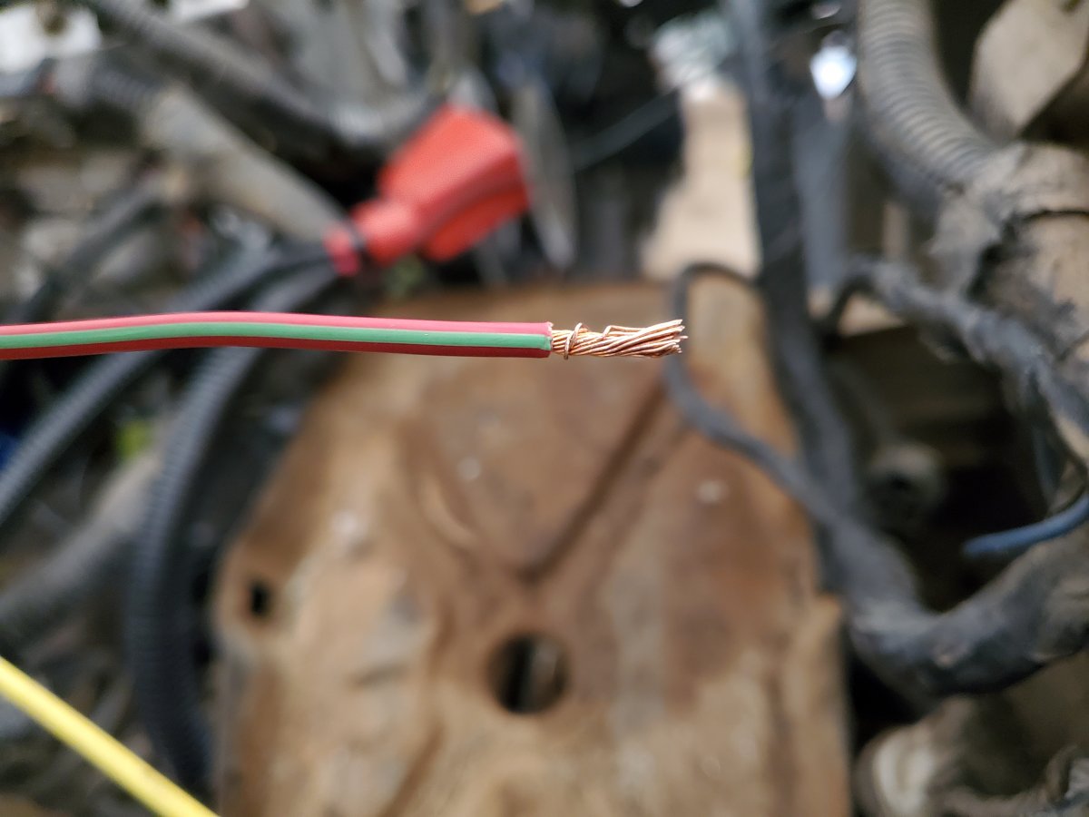

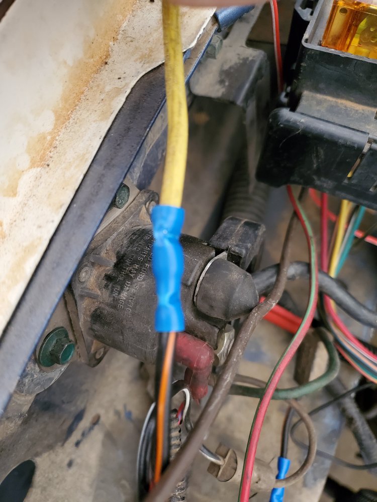

I'm not far off. I have the yellow wire (don't mind the cheap and temporary wire connector) hooked to the B2 black/orange wire. The yellow wire does indeed go to a diode, then changes to a tan/black.
The red/green I would tap the positive side of the battery and I would hear the relays click.
Now I need to find the B2's ignition wire.
Thank you for your help

You can take it off the old coil wire.
I believe the coil wire on the BII was fed with a white/blue wire.
The rf filter will have red light green.
